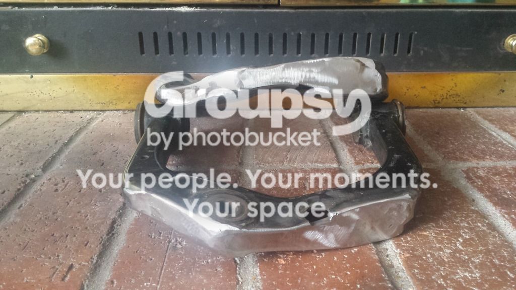

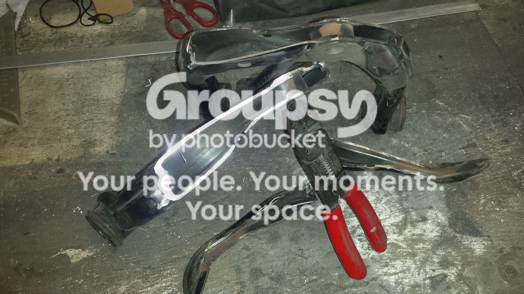

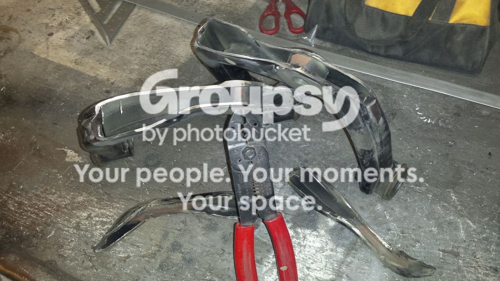

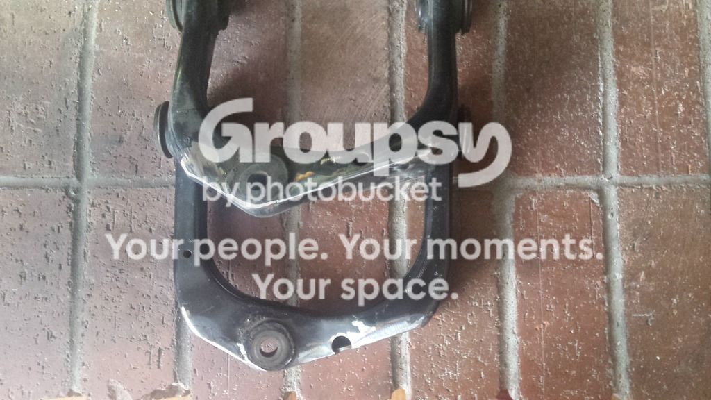

Got a small project taken care of over this weekend. I didn't feel like spending the money on the UCA's so I decided to shave mine like SS does. Pretty easy, and only took a couple hours from start to finish.

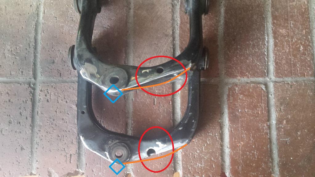

Can these be made without leaving the ultra thin side? The tires only rub at the ball joint (blue diamond), so why is so much material taken off the side? It leaves one portion very small. I might guess that the small portion (red circle)is close to the same size as the tube versions, but the tube versions are DOM tube and most importantly tubular in shape.
I think this is a great idea, but there might be some risks in this design that simply are not necessary.
What if you did them and left the meat in place along the sides (orange line) where the tires are not even an issue to begin with?
I suspect these could be made just as shaved (for the purpose of clearing the tires)without sacrificing so much material.
Thoughts?
Thoughts?
These have been sold like this by Sonoran Steel for a number a years now, and they charge $250 for them. I can make them anyway someone might want them. If you only want the front ball joint area removed I can do that. These were made from going off of Sonoran's site, but they can be changed.
