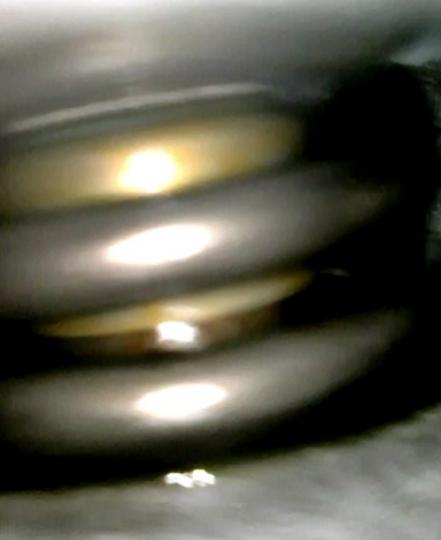

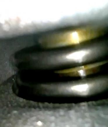

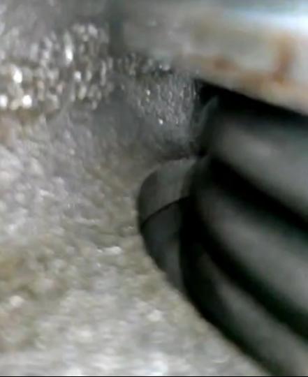

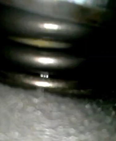

Sadly no dice, I tried with my boroscope but its a cheapy that doesn't have the cool twist functions, and no mirror attachment. All I could get were some not great shots of the piston head, and some springs. Probably not worth posting but Ill show some anyway. After sitting a for a few more days, I turned it over again and all the other cylinders are still fine ( didnt get restuck ) and the culprit is coming back up WAY faster but still extremely slow. Like 5-6? seconds vs the 15 or so it was before. I'm unsure what to think about the variation in the PSI. I did douse everything in mmo before that compression test and its very possible some of it got into the cylinders, so I'm not sure. Tons of buckets were sticking at first, several of the cylinders had zero compression when I tried to start it the first time. Compare the first video to the one below.
Current video of the bucket
Edit: Its currenly taking about 3/4th sec to come back up now. Obviously this is still way too slow, as Pyral said above they need to open and close thousands of times per minute. So its progress but at the same time its not fixing the root of the problem. I am not good with cylinder heads which is why I paid that machine shop to refurbish the head. Can the spring be replaced by removing the cams or does the entire head have to come off?
Also redid compression on #5 and it came out to 170 today, the others were the same.

I am not convinced it is the spring or the bucket.
What if the valve and the valve guide are the problems?
You may as well pull your timing belt and get the cams out,
that will allow you to pull the bucket for inspection and then manually
work the valve. Don't forget to lockout the spring-loaded cam with a bolt.
