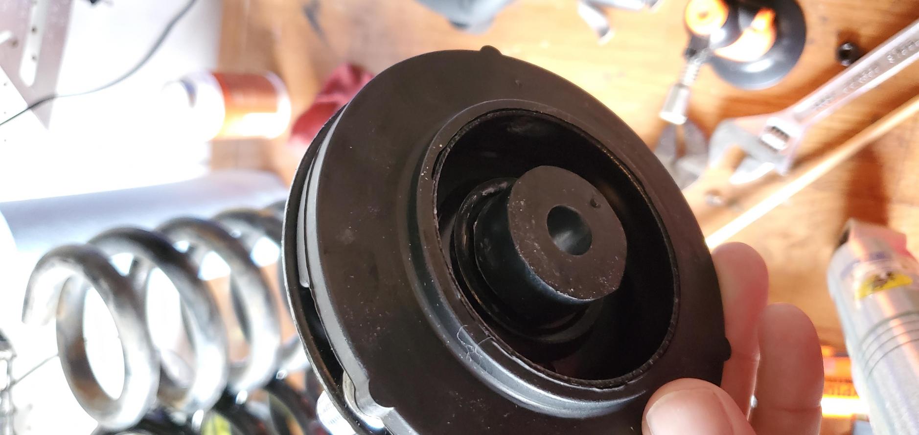

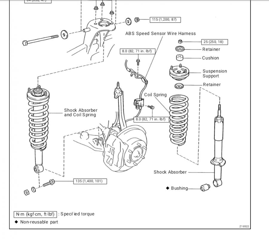

Does anybody have the part number or a place to buy the rubber bushings on the top of the shocks? I got some 5100 and didn't realize they didn't come with them.
I never did a bushing r&r on a shock so, I'm unsure if the stock oem 90389-14048 outer diameter rubber bushings would fit the Bilstein shock inner diameter.
Edit: My post is the lower bushing. Bad Luck has the correct upper shock bushing kit listed.

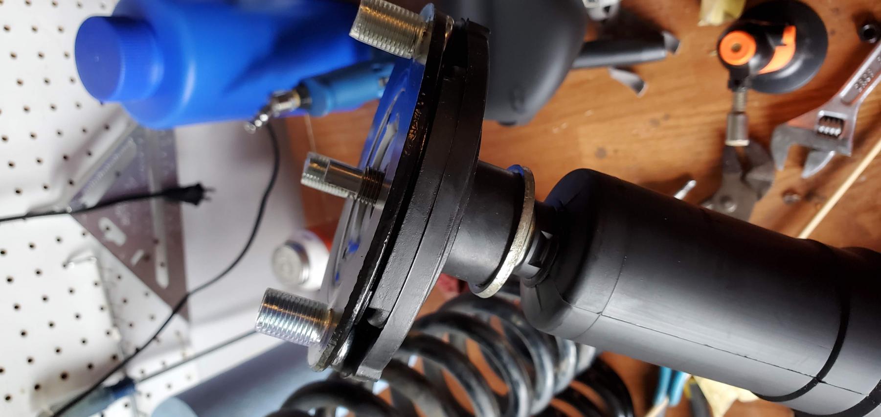

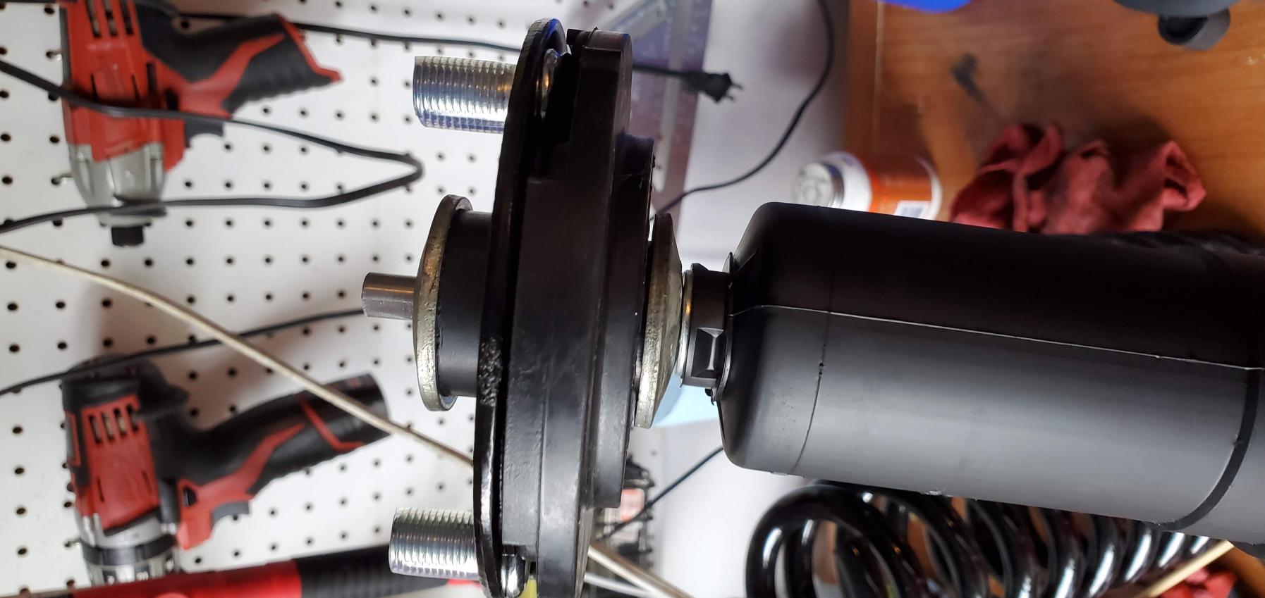

Thanks! I got one from the dealer.... it doesn't fit.
That's the correct orientation. Compress the shock a little to expose the threads the bushings compress quiet a bit once torqued exposing the threads on the shock rod, when the strut is assembled.

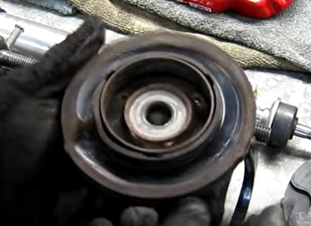

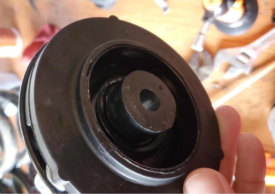

My top hat is different then the one in the video, mine has rubber protruding from the bottom like the bushing, and the one in the video goes straight to metal.
Your after market top hat must 've come with the lower bushing already installed. Also take your old front strut out and look at the orientation.
