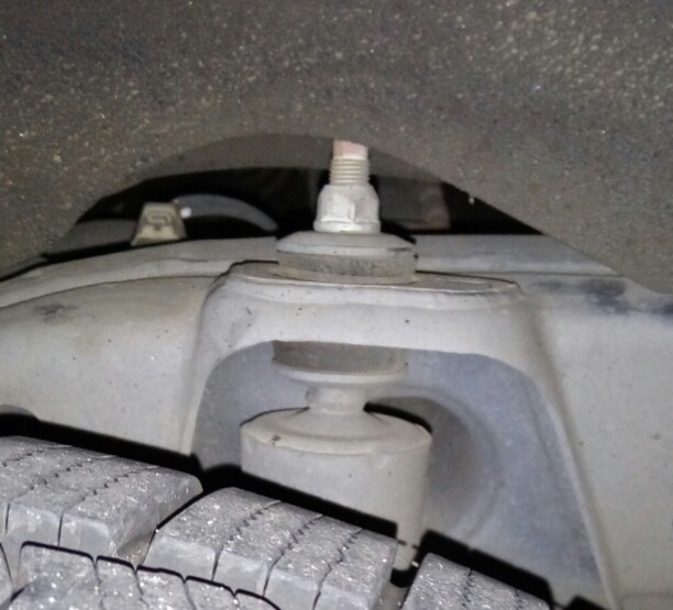

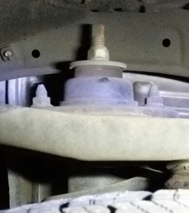

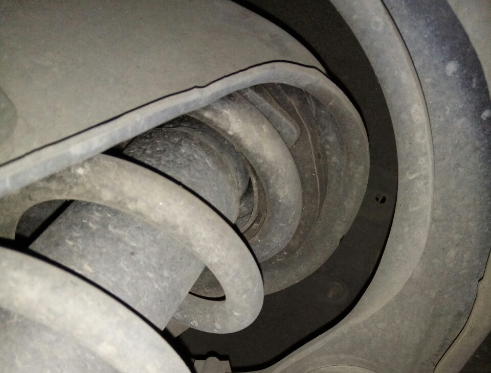

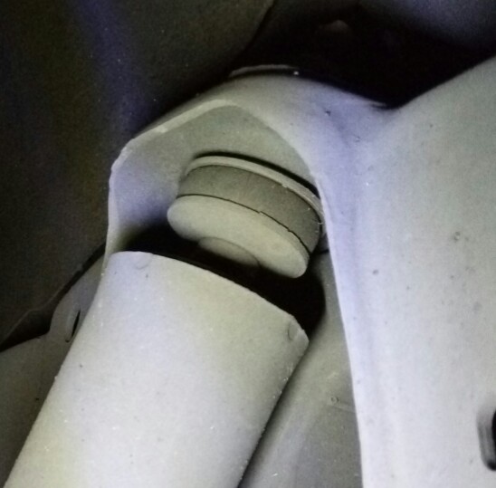

For reference, below are visuals of the 4R shock mounts.

^Front Strut mount - nut, washer, rubber bushing, top mount
^Front strut mount underside - coil spring rubber spring seat
^Rear shock mount - nut, washer, rubber bushing
^Rear shock mount mount underside - washer and rubber bushing
