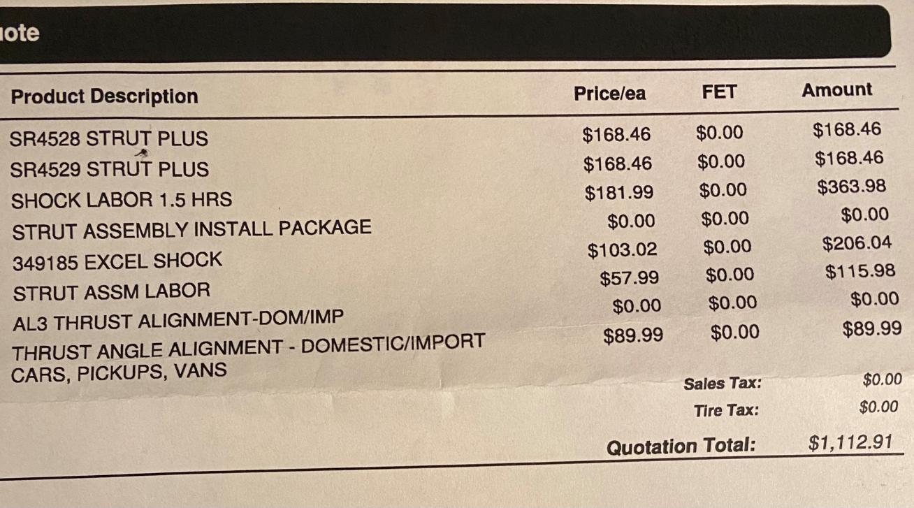

Yesterday I had to get new tires (long story)...and when I picked it up they told me the "front struts blown out and rears starting to leak". Not exactly sure what that means, other than the XREAS system is now gone (they didn't tell me, just included attached with my invoice).
They gave me an estimate to fix it but I don't know if this is for the fronts only, or for all 4 corners. It was my impression that you can't repair the XREAS system and it needs to be replaced with OEM system or with a traditional shock system.
Any help appreciated with quote!

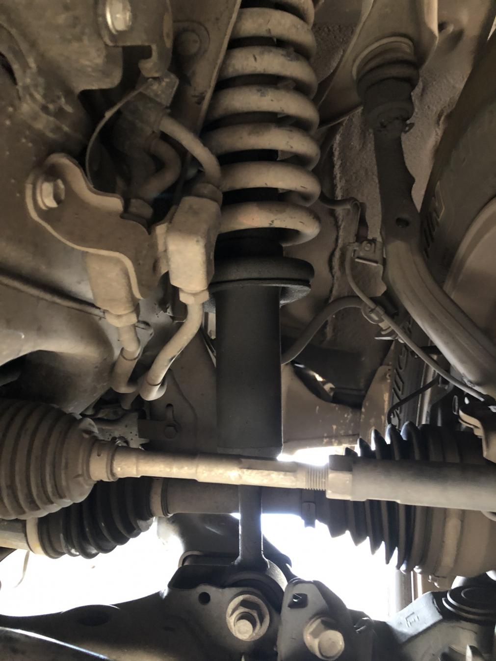

Consumers need to know the difference between a leaking and misting shock absorber. Shocks warrant replacement when oil leak paths and wet streaks are clearly visible along the full length of the shock. A misting shock has a very light oil film which attracts road dust, giving it a damp and dirty appearance which may extend the full length of the shock. Misting does not warrant replacement. Service advisors often say a shock is leaking when its actually misting. Misting is perfectly normal and necessary ... by design, the piston rod carries a film of oil through the rod seal to lubricate the seal lips, reducing friction and wear at the seal contact area, thereby prolonging seal life.
See this bulletin https://www.cbsparts.ca/admin/bulletins/misting vs leaking Bulletin Number Tech 01_09.pdf
Amazon's price for a KYB 349185 Excel-G Gas Shock is $52.62 each. The markup on the estimate is 100% for a low quality rear shock absorber.
Amazon's price for a KYB SR4528 Strut-Plus includes Strut, Mount and Spring for $114.87 ... this is the lowest quality complete assembly one can possibly buy. The shop's markup on the estimate is 50%.
According to Amazon, the SR4528, SR4529 front struts and 349185 rear shocks DO NOT fit 4Runners with KDSS or XREAS.
The quote you received is for replacement of all four corners. Personally, I would not buy those struts and shocks. I recommend that you perform the inspection after reading the Gabriel bulletin link in my post above. If the shocks are actually leaking, then I suggest getting another estimate at a well reviewed shop that installs quality parts, such as Bilstein. If you are not going off road, then Bilstein 4600 series is the OEM replacement.
This image shows heavy misting after 118,000 miles. The strut is not leaking.

Am I the only one to notice that they quoted 1.5 hours install, but want to charge for 2 hours?
Les Schwab’s total labor charge is expensive and the way they bill labor is confusing …
I think they are billing 1.5 hours per side, or 3 hours labor plus a strut assembly surcharge, so total labor is $363.98 + $115.98 = $479.96 which equals $160/hour.
A Phoenix off road performance shop gave me a 3 hour estimate at $90/hour to install 2 Bilstein 5100s on the front ... $270 total labor, which includes strut disassemble and reassemble. Therefore, Les Schwab's labor is higher by $70/hour.
Note, KYB SR4528 and SR4529 part numbers are assembled struts, no spring compressor needed, so why are they billing a strut assembly charge? It appears Les Schwab is billing for strut assemblies when they should be billing for front shocks.
