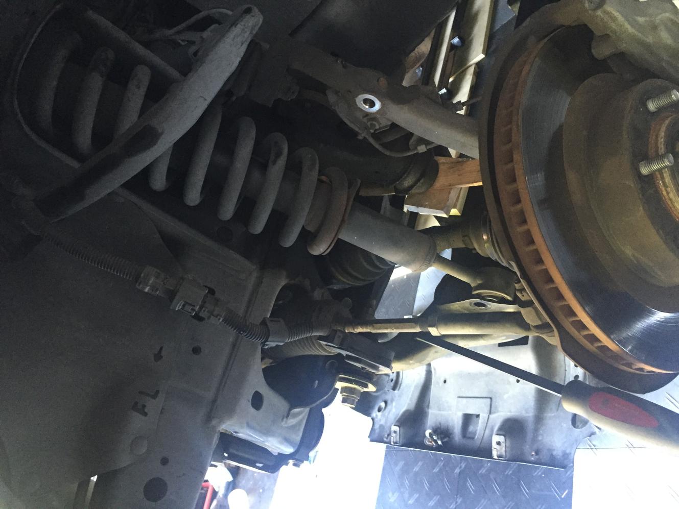

Thanks. I was thinking to put a wood block between the bumpstop and control arm before removing the shock, that way I could pry minimal distance while I insert the shock. In fact I may pry down and insert a door shim and then it might drop right in
I am working on it now. Doesn't seem too bad yet. I jammed the wood there so it won't rebound all the way up

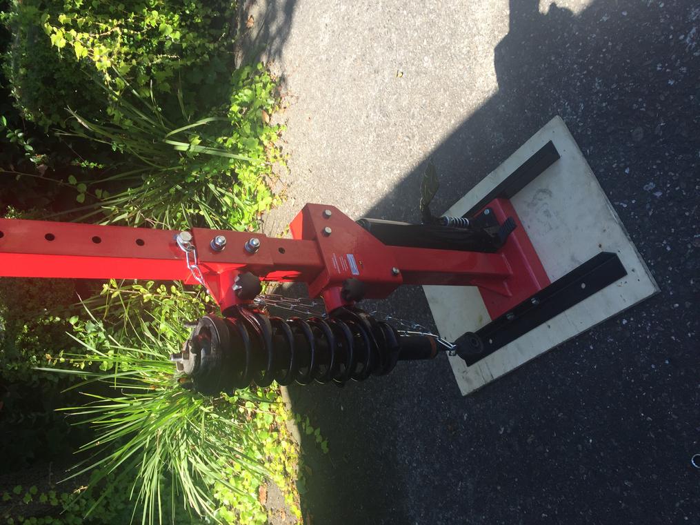

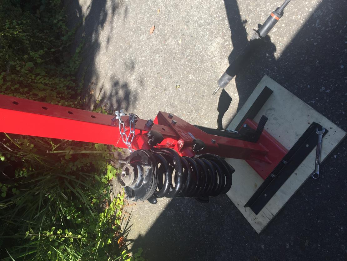

Here showing the compressor I got from eBay. I checked the cast pieces and no cracks. Dressed like defusing a bomb (helmet and full face shield) and went to use it. Just a few pumps and the bottom seat was up, the top was stuck so that makes the alignment easier. Just remove and insert from bottom and then tighten the nut. Release and go.

There was no slippage or strange noises at all. I cleaned the spring of all dirt and grease before using
