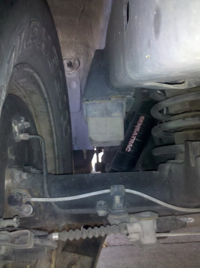

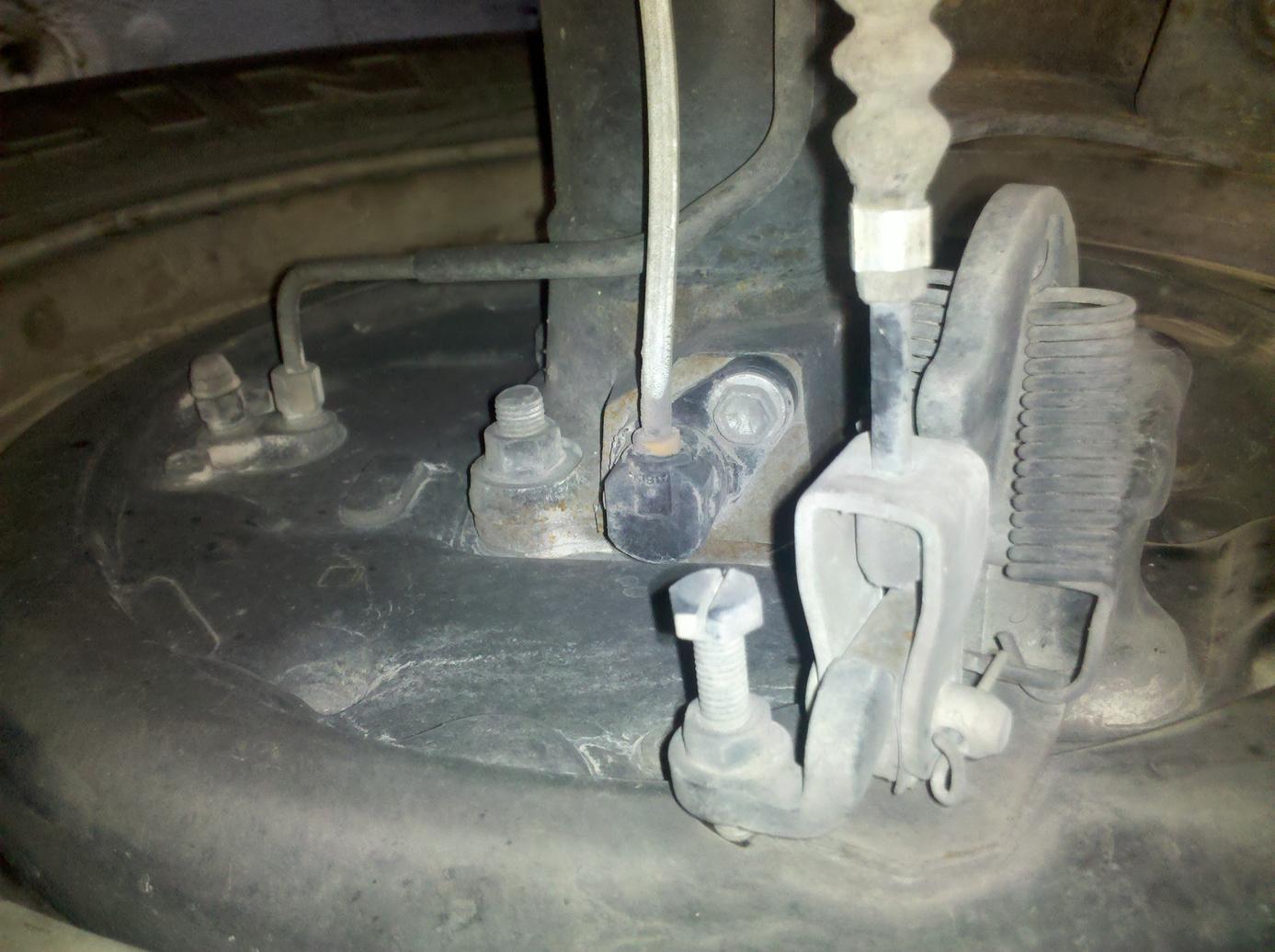

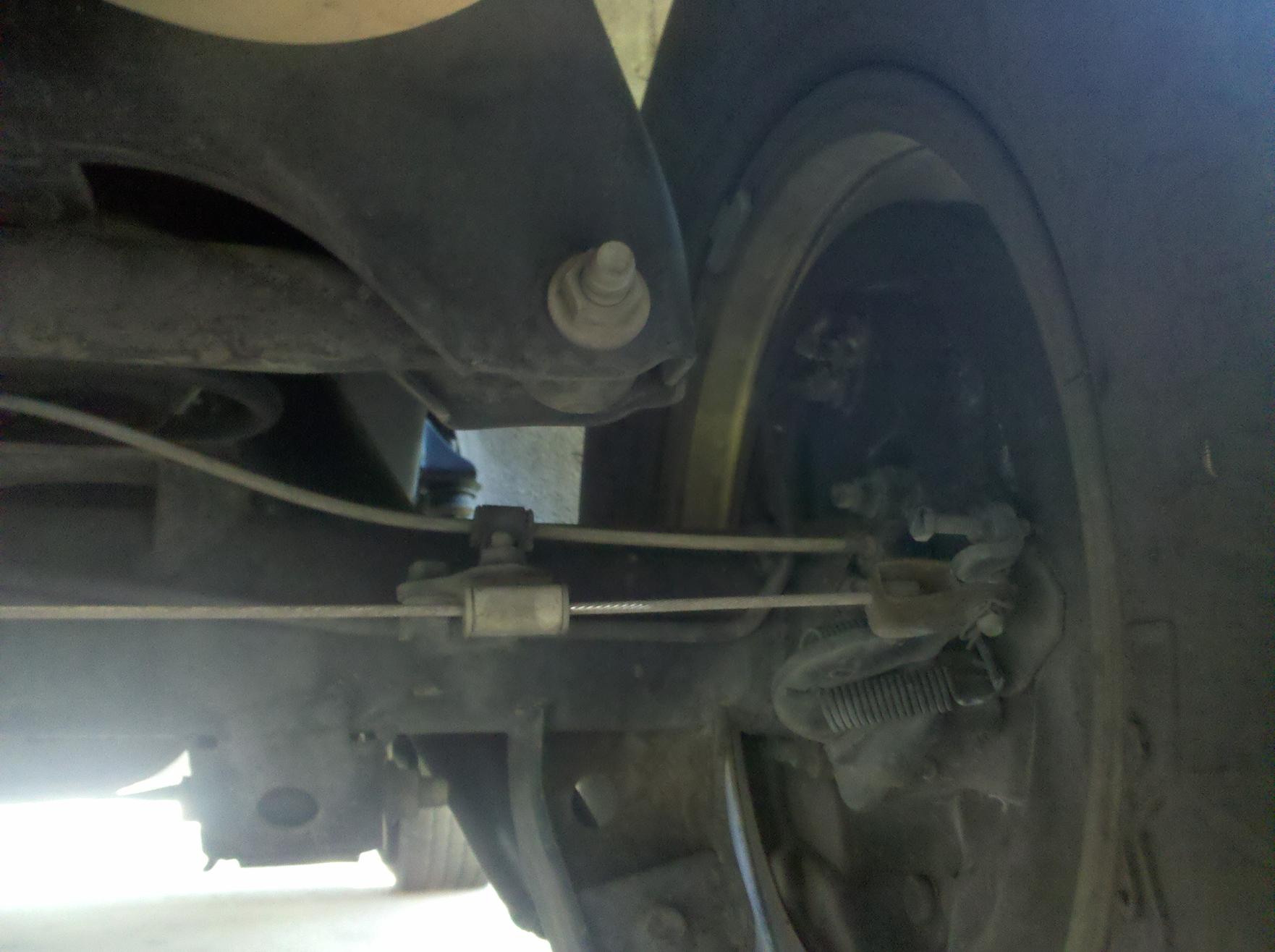

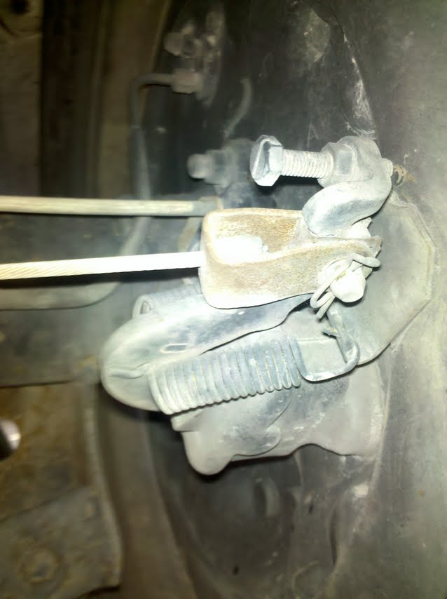

i did some research on adjusting the rear drums....i tried rolling backwards i nreverse and pulling up the e brake like 25 times...didnt work very well. made me realize my e brake doesnt work either!
took some pics of the rears, can you see anything? how do I adjust the ebrake? is it possible it needs new shoes? or just adjusting.
first 2 pics are of left, 2nd two are of the right

All you do is pop off the little dust cover that is in between the brake fluid line and the top of the rear axle housing. You put a flat head screw driver in there and just spin the little ring gear inside. That will adjust them.
My experience of adjusting the rear brakes was a waste of time. I pulled the drum, adjusted the star wheel as far as it would go, and put the drum back on. I then used the pumping of the e-brake method to adjust the star wheel to set the shoes back into place against the inside of the drums. In the end, IF you have a working e-brake, they'll be in the same position as they were before.
is there a reason the rear right has a bolt that is not touching, but the left side bolt is touching. Should I screw teh bolt until it touches the inside of the hub?
