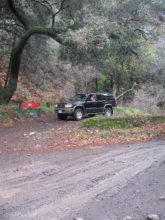

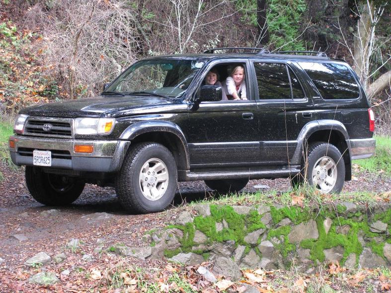

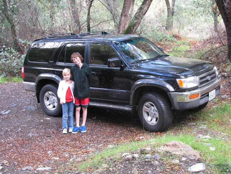

Sorry for the late reply back here. Thanks for all the info. Interestingly enough, I had the 4runner out for our first trial dirt run up in a local canyon here. We had good rain in the last few days so there was definitely some fun to be had, took my kids as this was the reason to get this in the first place!
Interestingly enough, the rear end was surprisingly stable. No bounce, no long recovery time, really stable at higher speeds on the dirt. I actually thing my shocks and springs are in really good condition. I think this may have really been its first time off road, where actual 4wd was used. 98 with 128k...just getting started.
I think I'm just getting used to its road ride and for some reason it just felt soft to me. One less expense for the near future. Btwy...these trucks are so awesome. My runner is just so solid, like its been off roading for years, didn't miss a beat today through some fairly deep mud(for southern california that is!).
A few fun picks:
