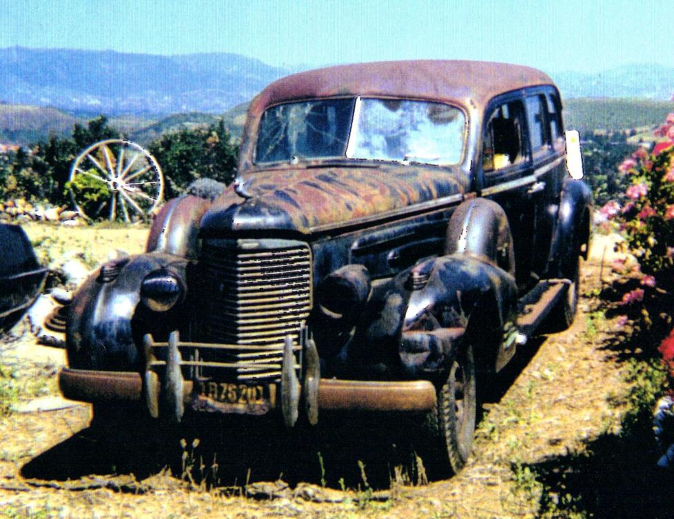

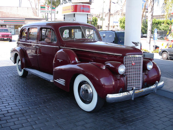

BTW Tom, do you have any pics of your 38 Cadi anywhere?
