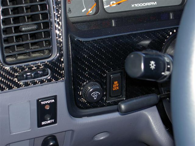

Hey Boltman 5537,
Here's that picture you need--- hope this helps you...???
