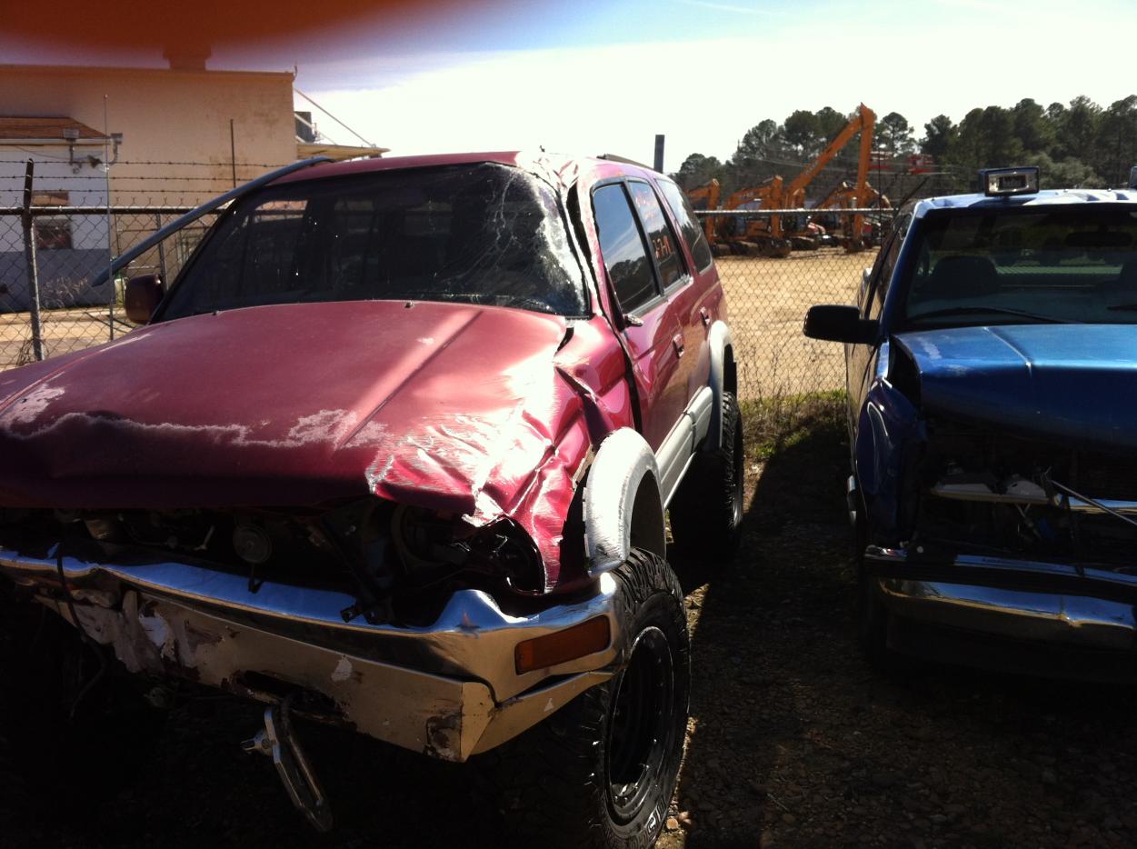

Have wondered this myself, they worked when needed @ 22 yrs old, current Runner 19 yr old still wondering, ha.
