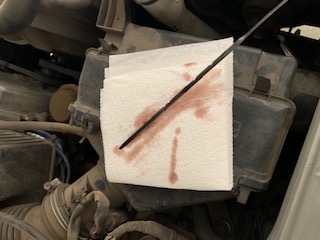

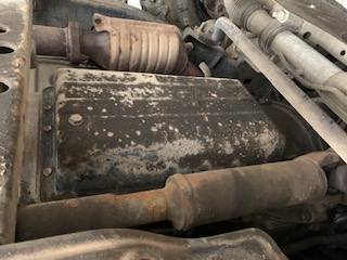

I bought this 4Runner about 2 weeks about and it has started to have hard shifts. It still shifts into every gear but i would rather try and fix it now before something worse happens when im away from home. Ive heard that flushing the transmission when its never been done before can also make problems worse. There are no records of anyone servicing the transmission. The car is at 191k miles. Here are some pictures of the condition of the fluid and the pan. Please let me know what you guys think and/or what youve done if youve had this problem. Thank you!

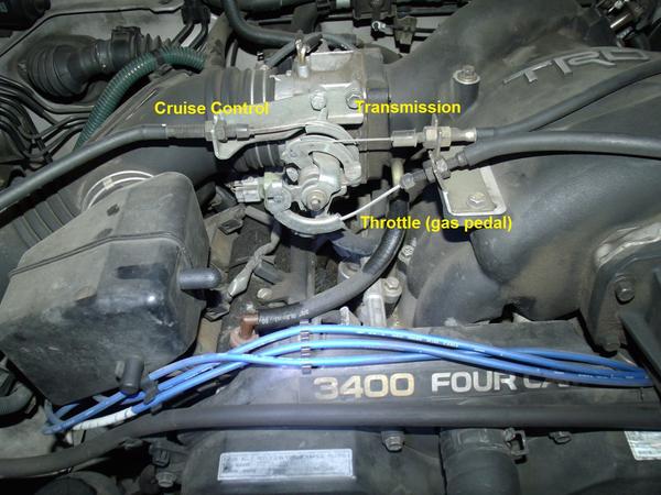

Also, make sure your transmission kickdown cable is properly adjusted if you're a 96-00. If it's set too tightly, you will get harsher downshifts.
Your transmission fluid does not look that bad. It's a pink color when new and yours looks slightly off but OK. A bad color would be a dark brown which indicates overheating. You can try just changing the fluid without a flush and see what happens. A power flush is an iffy proposition if there is a lot of wear and clutch material in the pan.
^^^ I second this. Sometimes rough shifting is just the sign of old fluid. As said, if a flush hurts your trans, then something was seriously wrong already. I understand this is a common myth, but it makes no logical sense that fresh, new fluid will hurt your car over of worn down fluid that's thinned out and possibly carrying particulate. I was about to go for a flush soon too, since after cold starts it's a little sticky between 2nd and 3rd for the first 1-2 shifts (plus I don't think it's ever been changed or had a new screen put in)

Your transmission cable is this one:
You want no slack in the cable between the bracket and the throttle body. Same goes with the cruise control. The throttle cable should have just the slightest amount of slack so that the pedal doesn't get stuck open in hot/cold conditions.

If your pan has never been pulled as far as you know it would be best to pull the pan inspect for large chunks and or a bunch of metal it would be good to know. Then wash the pan clean including the magnets don't for get to put them pack in. Replace or wash the trans filter ( OEM has a metal screen that you can see so if it's clean than I would reuse it and save it 30 dollars.) Replace the pan refill the pan see Tim's video on doing this it's perfect. The method he uses is drain and refill from the trans cooler line. Be sure to get a inch lb torque wrench then putting things back. Be sure to check the cable adjustment.:mullet:

It’s the throttle valve cable and it controls line pressure.

The fluid condition doesn't look perfect, but it has definitely been serviced through its life. Don't be afraid of a drain + refill or two.
There might also be a history of a "pink milkshake" that is now showing up - though I think that normally results in over-revving/flaring not hard shifts.
