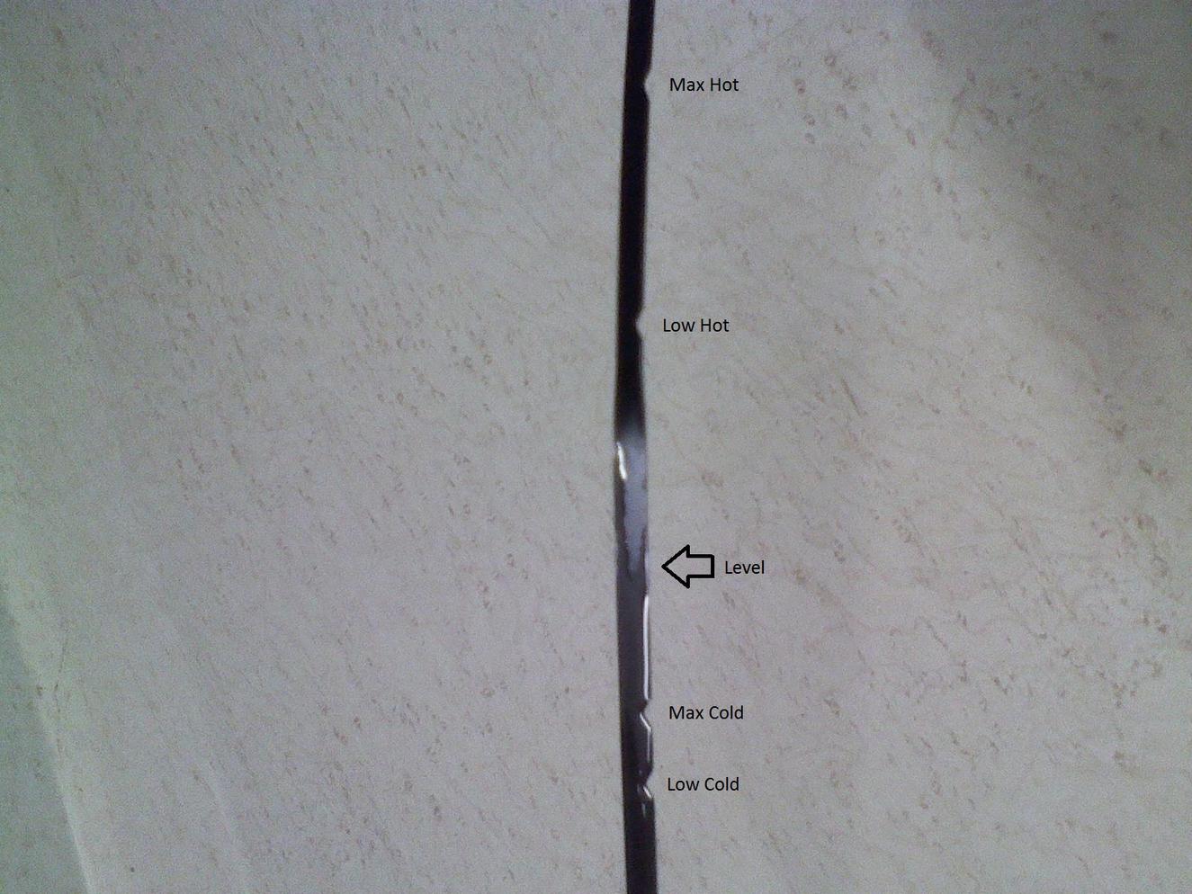

After my tranny cooler installation, I added about 450 mL (1/2 qt) of trans fluid. Since the installed trans cooler was somewhat bigger than what I removed I though it may take about 1/2 qt.
It is hard to get to warm level with the winter weather and the cooler. So, the temperature of the fluid is always cold no matter how much I drive. Did 10 miles at 70+ miles and the temperaure reached barely warm.
I just check the level after driving 3 miles (fluid is not even warm, I checked with my fingers) and the picture shows the level. Is this too much or low?

I did city driving for about 20 minutes and checked the level (environment is at 15 C or 60 F). It was still at the same location as my 1st picture and the temperature of the fluid was 25 Celsius (77 Fahrenheit).
I then let it to cool with the hood open for about 1 hour at 15 C (60 F). Started the truck and went through all the gears and checked again. This time the temperature of the fluid was at 17 C (63 F) and the level stayed between the LOW and MAX in the COLD range.
The temperature was measured with an IR thermometer directly at the fluid on the dipstick.
You may not be able to get an accurate "hot" reading until next year when it warms up. I would keep it where it is and just keep an eye on it. If for some reason, you are in some major traffic for like an hour, check it then.
