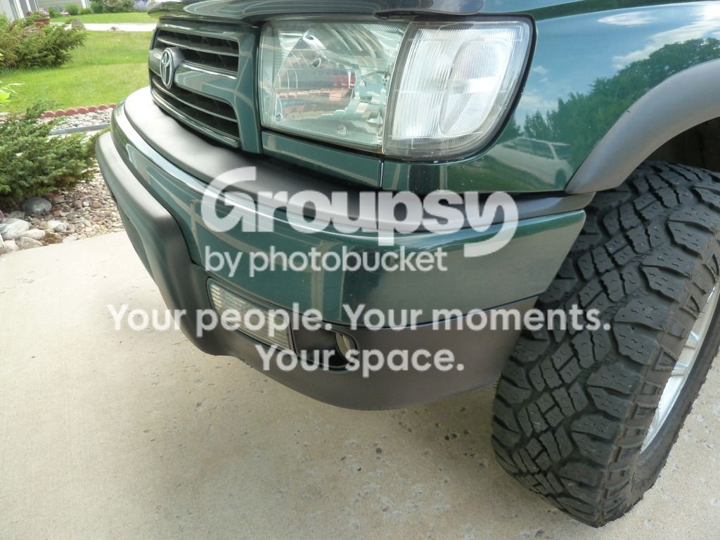

If you hit the trails fequently then go with something with a nice sheen or semi gloss since that will hide scratches better and then paint to match your plastic on the front and you'll be good. I recently did my valence since it was getting pretty faded and did the flares last year so it needed a match bad.

what paint is that, that you used
i like the way that looks. and you made up my mind on the clear corners.

The paint I used was Duplicolor trim paint which was a perfect mix between a deep black with just enough sheen on it to not look flat.
I do recommend using a prep spray to really clean any unpainted plastic you paint along with a couple coats of adhesion promotor before you lay down several coats of the trim paint. I didn't clear coat the plastic since if it is scuffed it's easier to respray with no clear coat on it.
