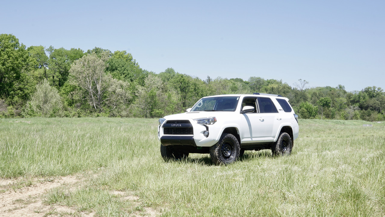

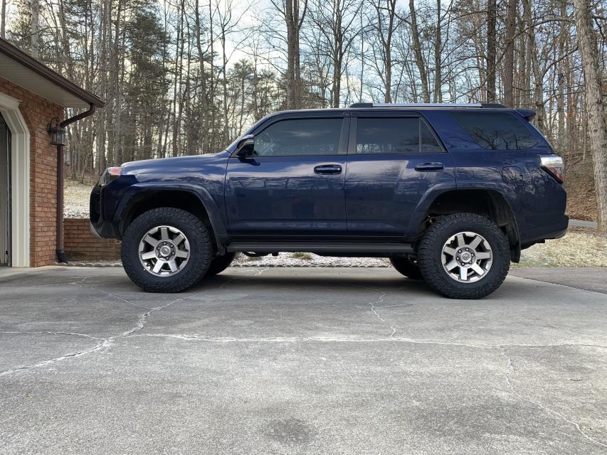

So a few weeks ago I had a lift and tires installed. I went with the Falken Wildpeak AT3Ws in 275/70/17 and I’m regretting not getting a larger tire.
Edit-285s were ordered. Install is 10:30 tomorrow.

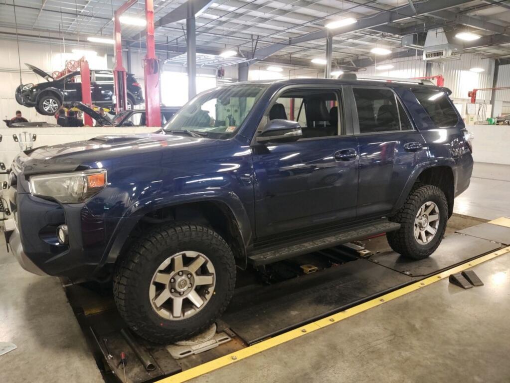

Sounds like you have a back up plan for your 275’s so I would say go ahead get the 285’s or it will just keep chipping away in the back corner of your mind. I knew this going from 265 to 285. I originally thought about 275 but skipped it and went straight to 285 and I’m glad I did. With that said, theres nothing wrong with 275’s but it wasn’t the overall look I wanted to achieve on my rig. Everyone’s personal taste and use for their own rig is different. YMMV

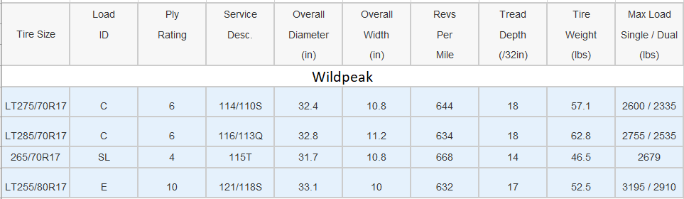

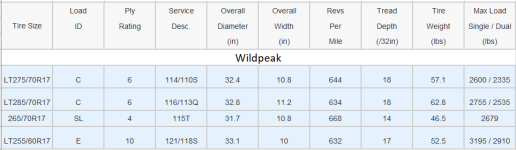

Here is a clip from my tire decision excel document!
275- diameter 32.4
285- diameter 32.8
255/80 would be a good choice for you - 33.1

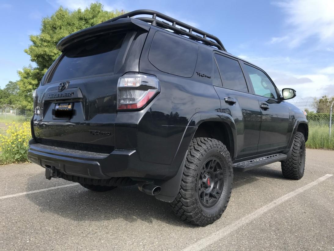

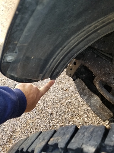

I have 285's on my 17 SR5.
1½" spacer on top of OEM struts.
They slightly rubbed the inner fender liner until I moved the liners, about an inch.
Not stock wheels so no idea what offset they are.
