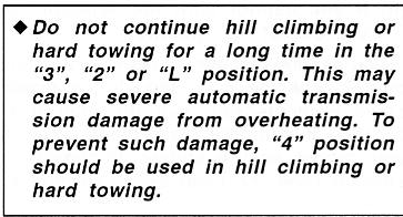

What do you make of this warning from page 161 of my '05 manual? Perhaps there's no lockup in gears lower than 4th or a different lock-up sensitivity? Sure would be easier if Toyota would provide a more detailed explanation.
I'd sure like to know too, although I haven't seen that warning in my 03 manual!
