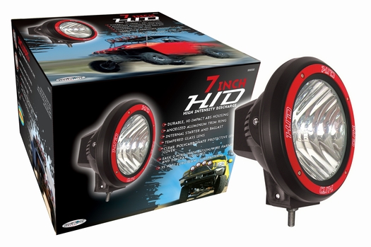

I don't have offroad lights yet and want some advise. I want 6000K HID to match the headlights. They will need to be at least 6" and have a good sollid pattern.
How about these?
Best deal so far
2 EA. 7" HID OFFROAD DRIVING LIGHT, 4X4, TERYX, RHINO - eBay (item 250643525315 end time Nov-28-10 22:30:49 PST)
Only downfall I found with them is that they claim to be "Euro Beam" which from my understanding will have the cut off angled pattern, no good for off road. I've e-mailed the seller and manufacturer with the question.

Why not just buy some lights and then retrofit HIDs in them?
I'd have to agree with Clemsonfan.....you could buy some cheaper housings, and retrofit them.....that's what my plan will be once these bulbs die.....

I hear ya. Is the light pattern the same? Any chance of water getting in and not being able to get out?
