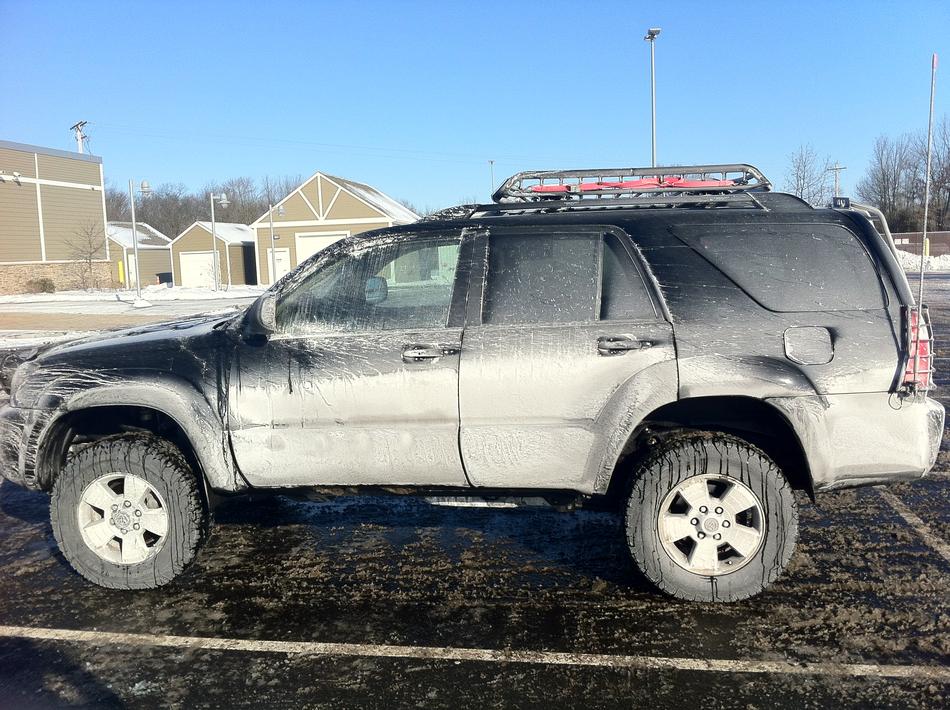

I have FJ Cruiser coil springs and Bilstein 5100s with the front set to 0.85" lift.
265/65R18 BFG ATs (equivalent to 265/70R17)

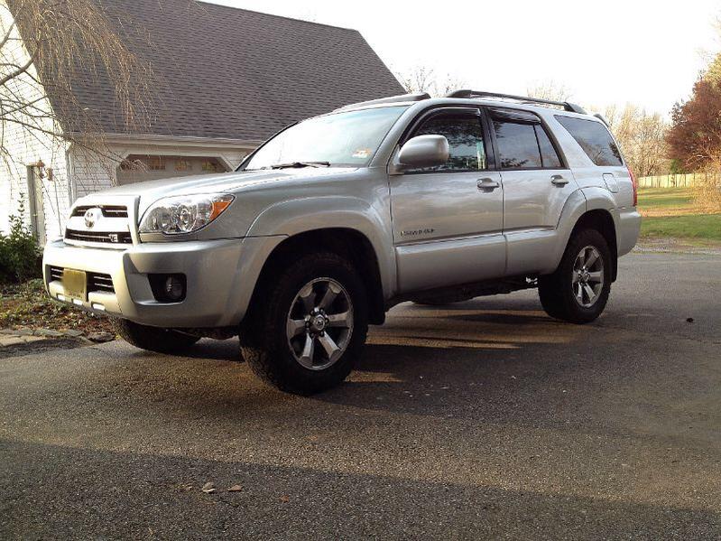

1/2 inch (1inch of lift) front leveling kit. 265/65/18
Tires will run you around a grand. Not much you can do about it. 18" tires are pricey.

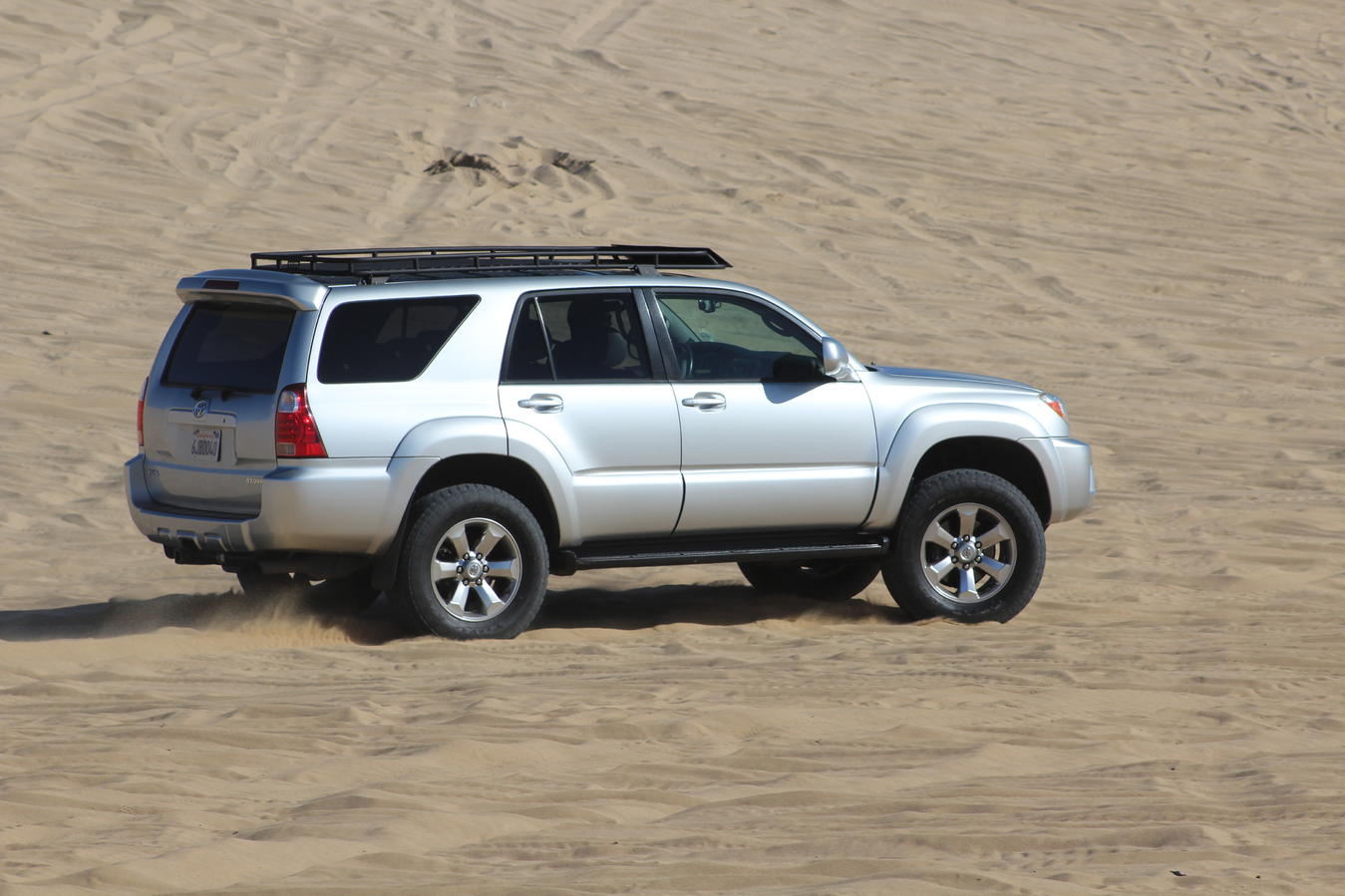

Budget boost front with FJ springs all around, 255/70/18 Toyo's.
The FJ spring netted me close to zero lift but the ride is way better
