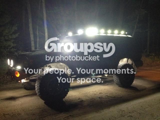

Here they are lit up:

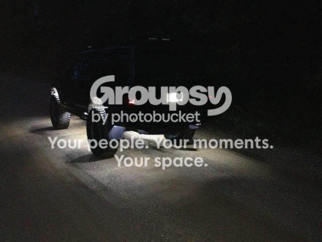

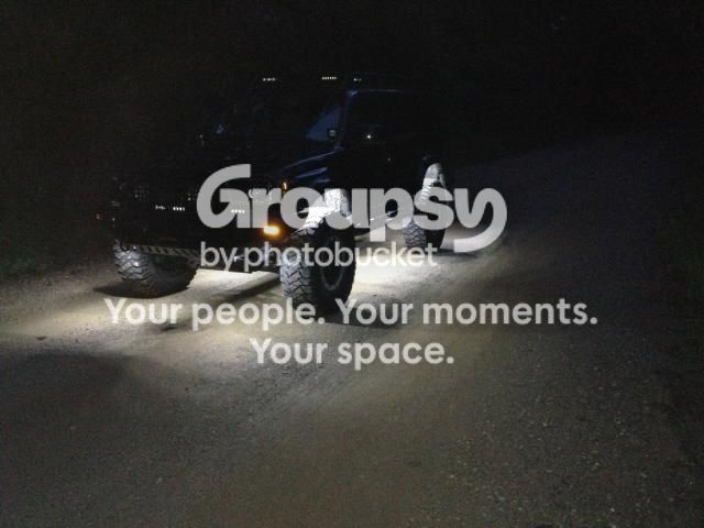

Sure. Copied from my build thread:
I used 9 lights for each side of the truck located like this:
- 1 near the front body mount in front of the front tire.
- 2 in the front wheel well.
- 1 just behind the front tire.
- 1 midway between front and rear tires.
- 1 just in front of the rear tire.
- 2 in the rear wheel well.
- 1 near the rear body mount behind the rear tire.
IMG_6500_zpsc2548c71.jpg~original
IMG_4208_zpsf55740e5.jpg~original
As you can see, this gave me a fairly nice even distribution of light all around the truck.

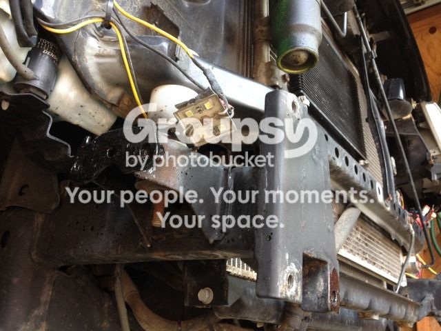

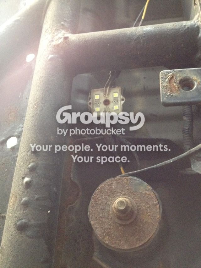

The mounting varied depending on what I was attaching them to. I bought a roll of metal strap with the holes in it. Its the stuff plumbers/electricians/hvac guys use to hang pipe/conduit/ducts from unistrut. I basically cut a short piece of the strap and bent it to fit where I needed to mount it (it bends really easy, but is stiff enough to hold its shape). I used a small bolt and nut to attach the rock light to one of the end holes in the strap. I used another bolt/nut in the other end hole of the strap to mount to the truck (where there was an existing hole in the truck to use). In some places where there was no hole (wheel wells) I used drill point screws to attach the strap to the truck.
Here's a few crappy pics of the mounting:
By the front body mount (bumper is currently off due to installing a winch):
rock_light_front_zpszbk8mufh.jpg~original
By the middle slider position:
rock_light_slider_zpsqjtv5lwl.jpg~original

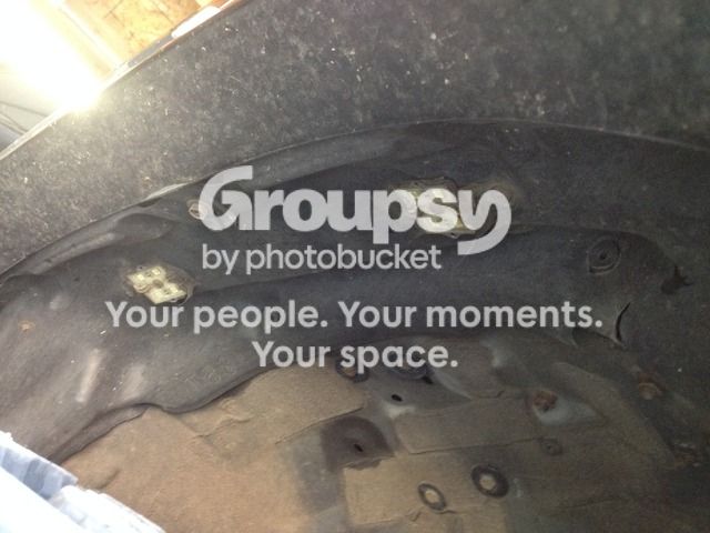

Two in each wheel well:
rock_light_wheelwell_zpsdjaq6cgm.jpg~original

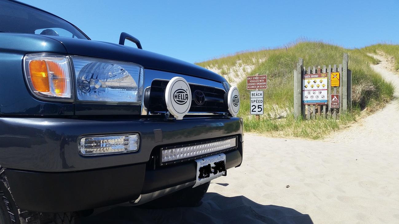

also here's a pic of my LED bar while im at it..

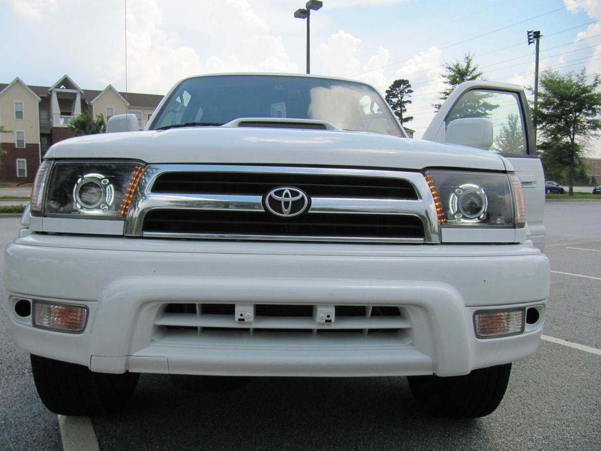

My LED's are brighter than any HID's on the market. Also, I live in South Carolina and not some democrate/communist state that can tell me what lights I can and can not run on my car/property at night. I mean dag bum, I have 6" slim LED bars that I built into the filler panel under my head lights wired into my DRL and have never been pulled over. zrunner your lights look clean. See the pictures I attached for an example of the bug eyed look. My 4runner is an off roading machine and not some rice burner. Maybe you whould have a ricer burner a lot of them look like bugs now and come stock with HID's.

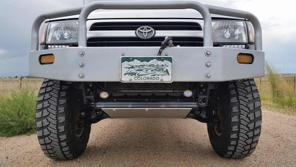

Since someone brought this thread back up, I'll contribute a pic of mine. This is just to show the single row of LED's under the headlights which is otherwise wasted space. I used Rigid Industries single row with 6 LED's.

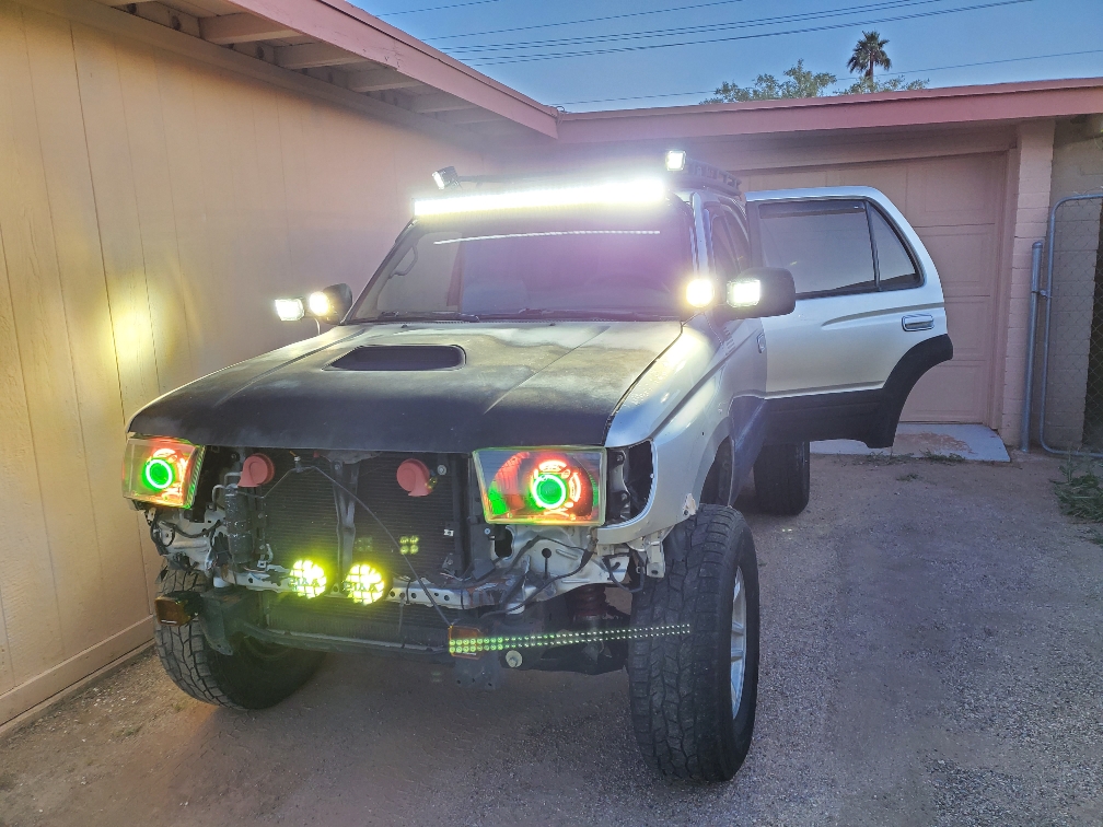

Since this got bumped up, might as well post the new setup. Don't mind the grill and bumper, they are going on next weekend.
