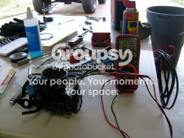

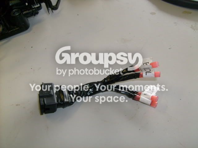

So, I needed to check my TPS and it was out of adjustment. So, I got tired of having to move the TPS a hair, check the resistance, move it, check resistance... So, I made this little guy that made the adjustment of the TPS a snap and a very easy job!
I had an extra TPS plug so I put some small butt connectors on it and labeled the connections. The leads of my multimeter plug right into them and give me a good reading. This setup adds a little bit of resistance but I measured it out to be about 3 ohms, so nothing to get paranoid over. Here's the gadget:
