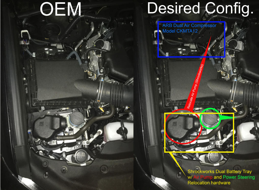

Dual battery and ARB dual air compressor?
Hi Keith,
I hope you're well! Great build so far! I'd like to install a dual battery system and the ARB dual air compressor (CKMTA12) in my 2016 Trail Premium. Is there a bracket that will enable the ARB dual air compressor to mount back near the firewall while still maintaining clearance underneath for the relocation of the air pump when installing an auxiliary or second battery via the Shrockworks dual battery tray and air pump re-locator?
I'm open to ideas as I have not yet purchased a dual battery tray or system yet and would welcome your thoughts on this. Thank you in advance!

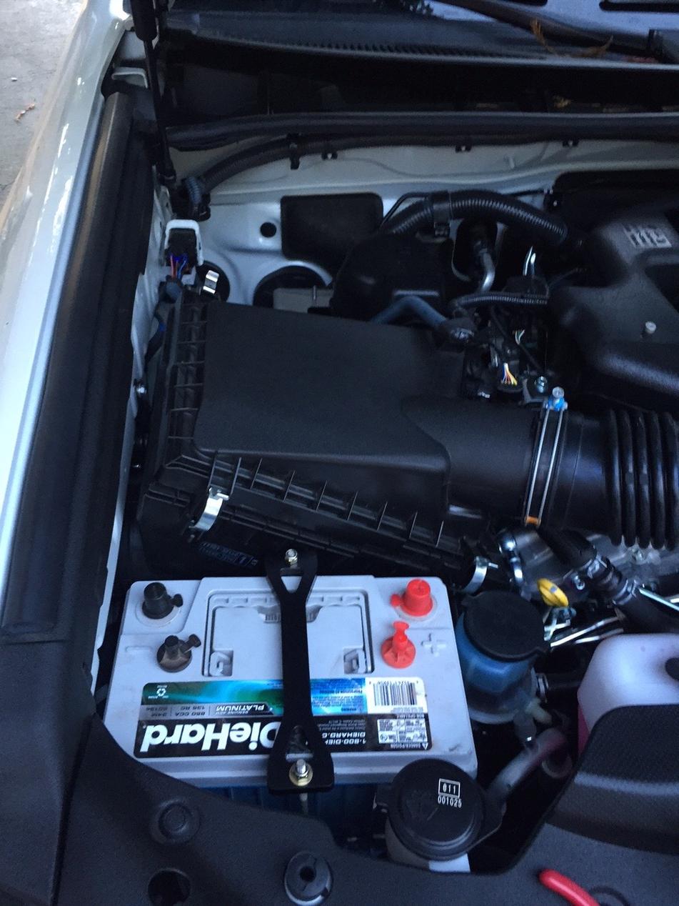

Dug up some pics from my install. I didn't take any measurements, but you may be able to estimate how much room you have from these. Perhaps make a mock-up of the air pump and put it back there to see. I think it's gonna be a really tight fit.
This is with the air pump relocated, prior to installing the new washer reservoir. I believe the bracket is the same but you'd have to call Shrockworks to confirm.

Is that a 34M battery?
