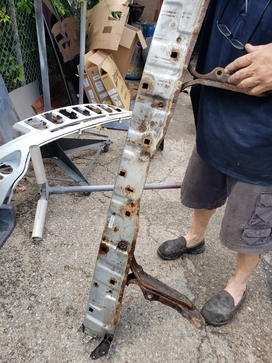

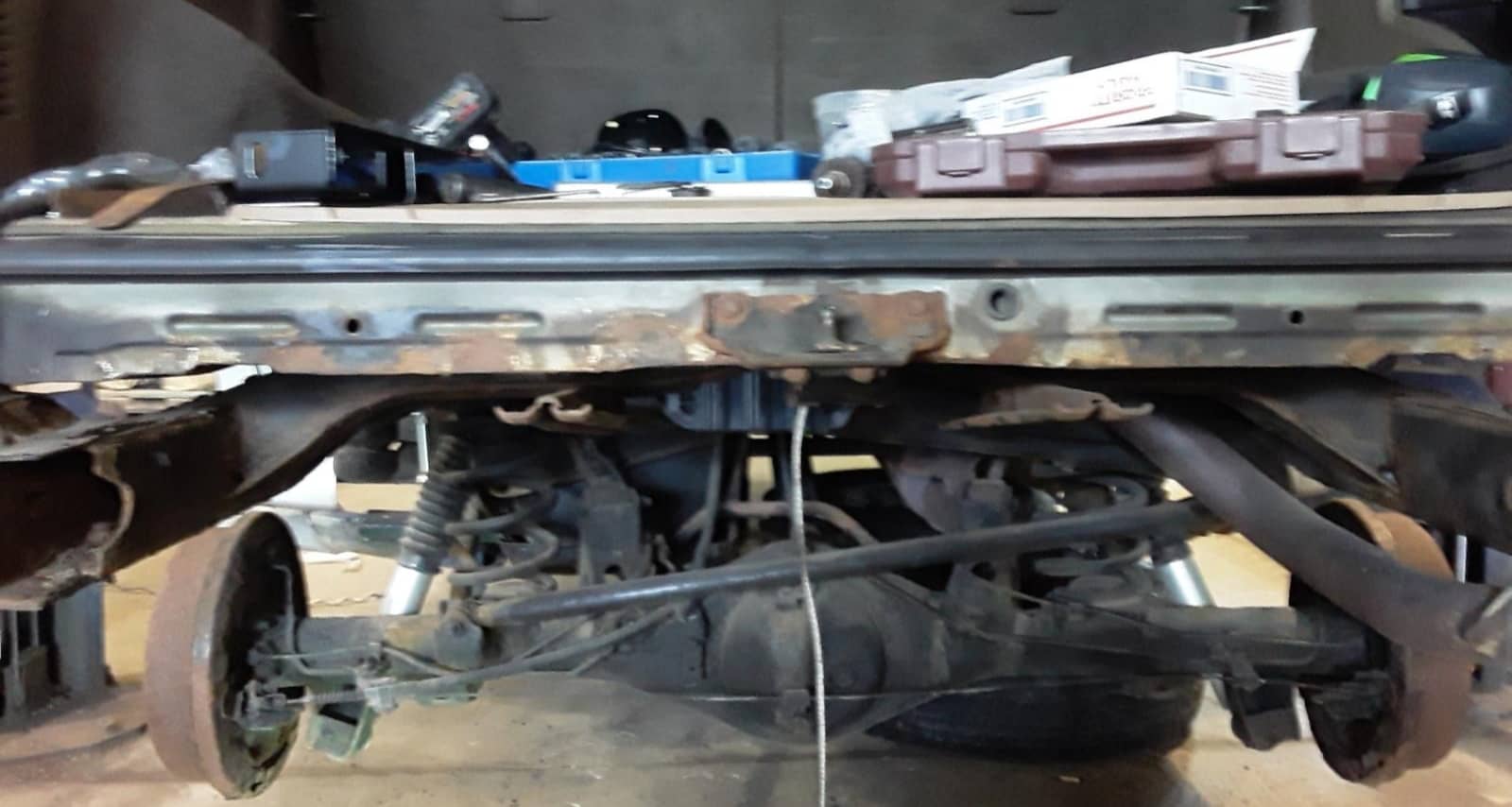

Here's a pic so others may be able to assess better.
This is after the body shop removed the old stuff.
The owner sent this to me. I haven't seen my car since I dropped it off on Monday

thanks for the pict, it helps a lot.
I would agree [MENTION=95936]heat[/MENTION] some people will price themselves out of a job if they just don't want to do it.
couple of thing I will mention. that is not the most rust I have ever seen but it's enough to make doing almost anything much more difficult. rust sucks we all hate it.
I have installed a rear bumper myself and I can share some of the surprise moments.
#1 it only takes like 8 large m12 1.25 bolts to install the bumper, super easy.
#2 the exhaust needs to be messed with but again super easy.
#3 and this one can suck. the rear body mounts will probably be compressed and probably need to be replaced. I had slight clearance issues with my rear and replaced the body mounts to compensate for it.
#4 I can't tell but it looks like there is a bolt in the factory mounting hole for the stock hitch? if that was cut off? you will need to drill and extract that thing. maybe they just cut them all off? that would explain the extra price a bit?

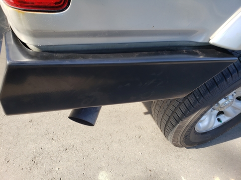

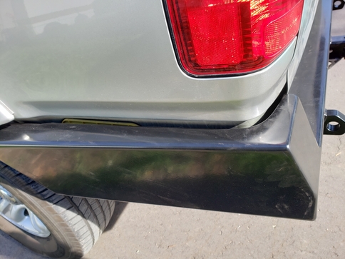

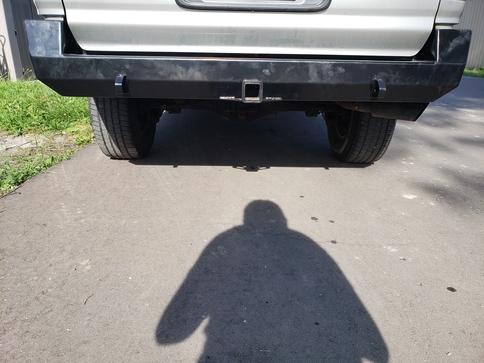

Here's the pics of the install....
Is it me or are the gaps too much?
I'd like to see pics of other people that have these installed for comparison.
Also total cost me $500

I'd like to know if I need to go back there and have them readjust it because while the bumper looks and feels amazing, the install seemed like the gap needs to be at least cut in half or snugged

Without poly body mounts in the back, the rear of the frame flexes a TON off road. That gap is needed to avoid body contact. If you see tighter clearances on other bumpers, they require poly rear body mounts.
Also, there isn't much to adjust. Unless they used a spacer on there, the bumper bolts to the bottom of the frame and can't be lifted higher from there...

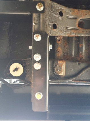

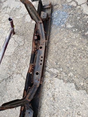

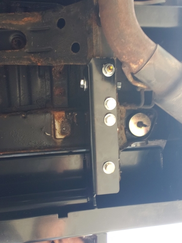

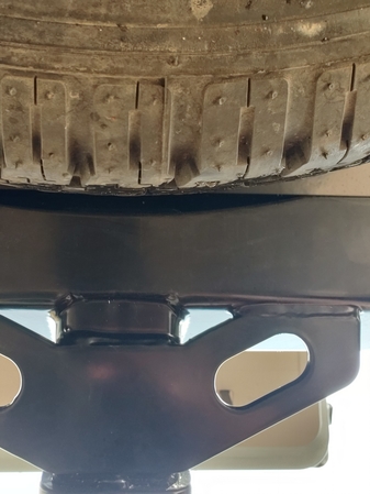

Anyways here's some more pics.
The old stuff was pretty rusty so I understand why they had to cut every bolt
The spare tire fit just fine with a little bit of clearance left.
I'll go back and get the rusted areas with POR15 especially the parts you see when the rear door is open.

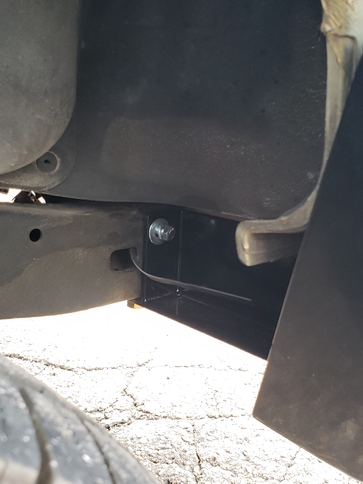

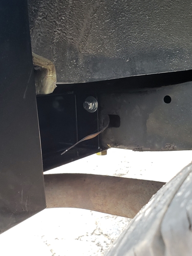

The only thing I was concerned about was the last 2 pics with that bendable metal on each side... I don't think it was tightened cuz I was able to turn it with my 2 fingers.

[MENTION=93998]sugjavier[/MENTION] the gap is supposed to be there, as mentioned. In the instructions, Shrocksworks states this and they recommend to paint the yellow plastic trim on the driver's side if you don't want it to be as visible. Thanks for the pictures by the way, they are helpful for me as well.

Let me know if you figure out what the heck are those bendable sheet metal things on my last 2 pics.
I'm just gonna tighten the bolt for it because it seems like they didn't.

Those look like nut-strips - if they are, they should be tight (tighten the bolt on the outside)
Also, this bolt doesn't look tight:
https://www.toyota-4runner.org/attachments/3rd-gen-t4rs/339479d1563571832-shrockworks-rear-bumper-install-cost-webp-net-resizeimage-6-jpg
