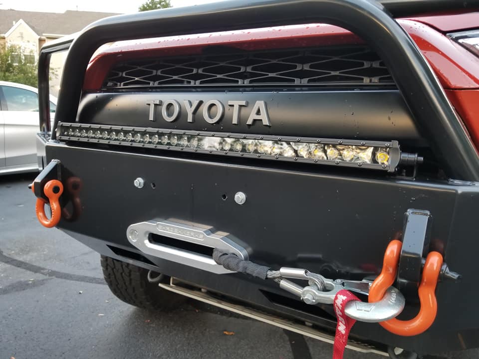

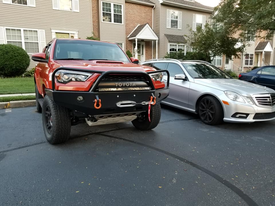

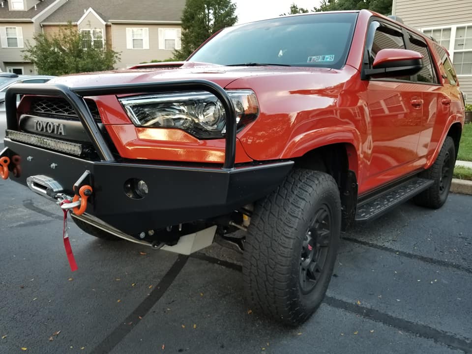

2 grandkids later...lolll
finally got all my mods on...
a big shout out to Mitch and Mark from Shrockworks....
they make quality stuff...great fitment
