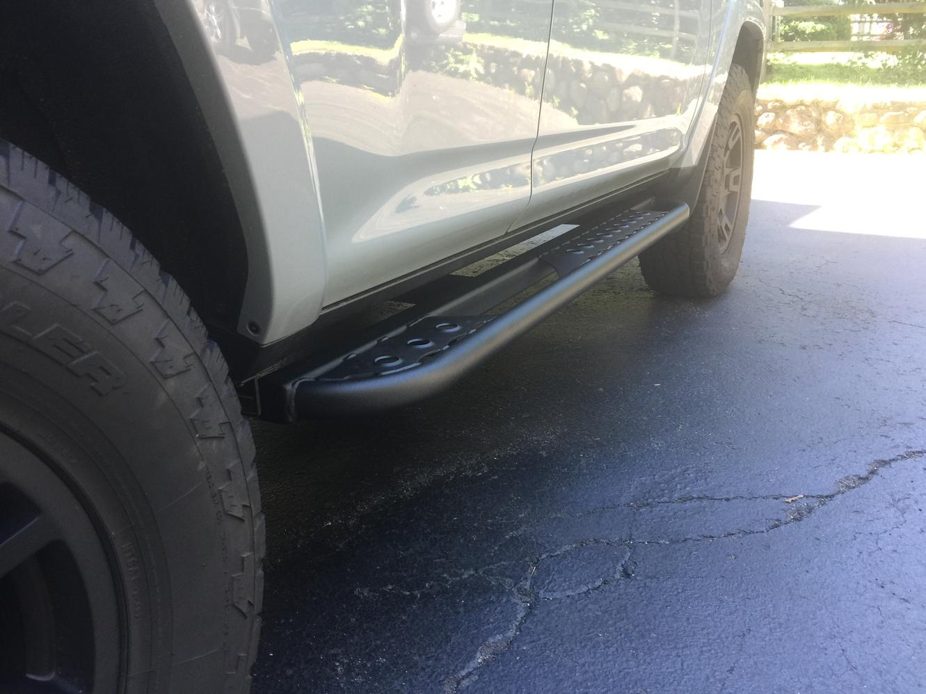

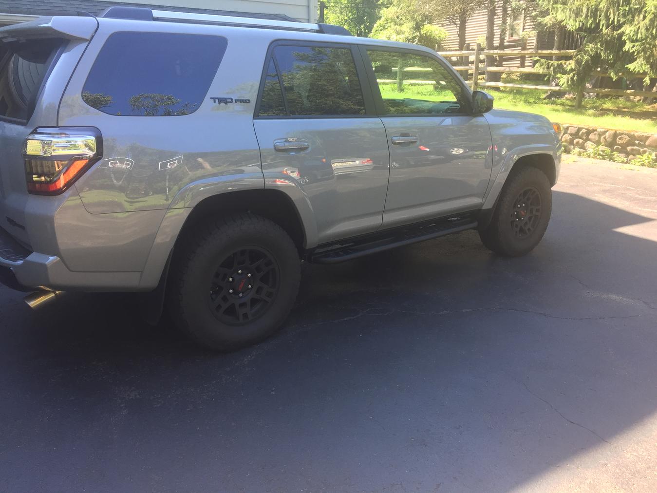

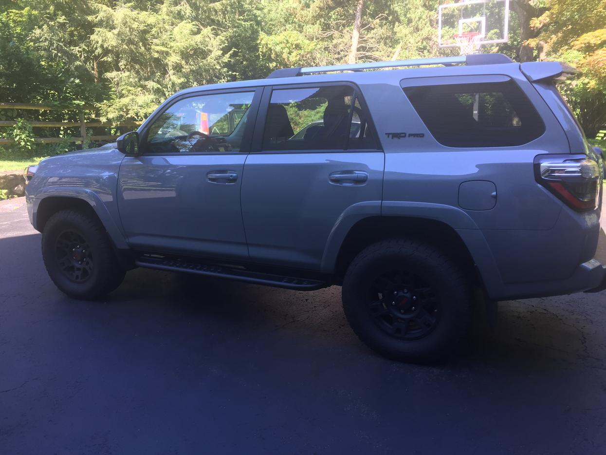

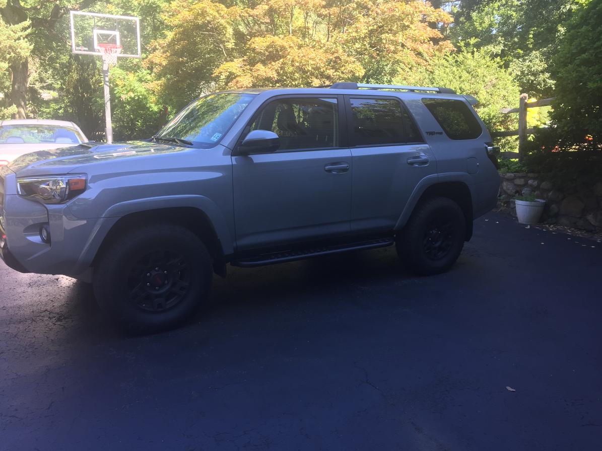

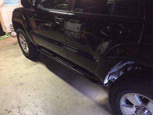

Pics of it installed on the car. Question, how important is the passenger front bottom bracket where you have to drill a 3/8 inch bit? I didnt do it and left it alone for now. I also had a lot of hardware leftover, ie. 3 sticknut, 2 zipties, 5 m8 bolts, and 4 3/8 x 1 bolts leftover. The rails are pretty on solid. Im assuming shrockworks gives extra bolts?

Picked up sliders on Friday and installed them on Saturday. :reddance: That driver's side is a real PITA to put on, though.
Slider design, construction, look: 10/10, would buy again.
Installation: 3/10, would not want to attempt again.
Note: I do not have LED lighting in the wheel wells, lol. That's a flashlight on the ground.
