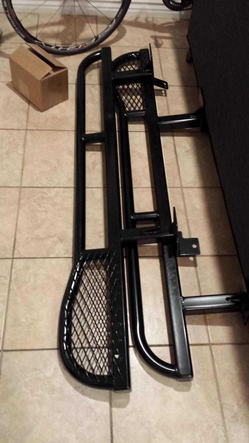

Your on the right track. It looks like the angled tab got slammed by a UPS guy or two. If you have a couple of big cressent wrenches, I would try using them as a lever to bend the tab back to its proper position before paying someone to do it for you.
We try to pack these things for war, but we cant win them all.

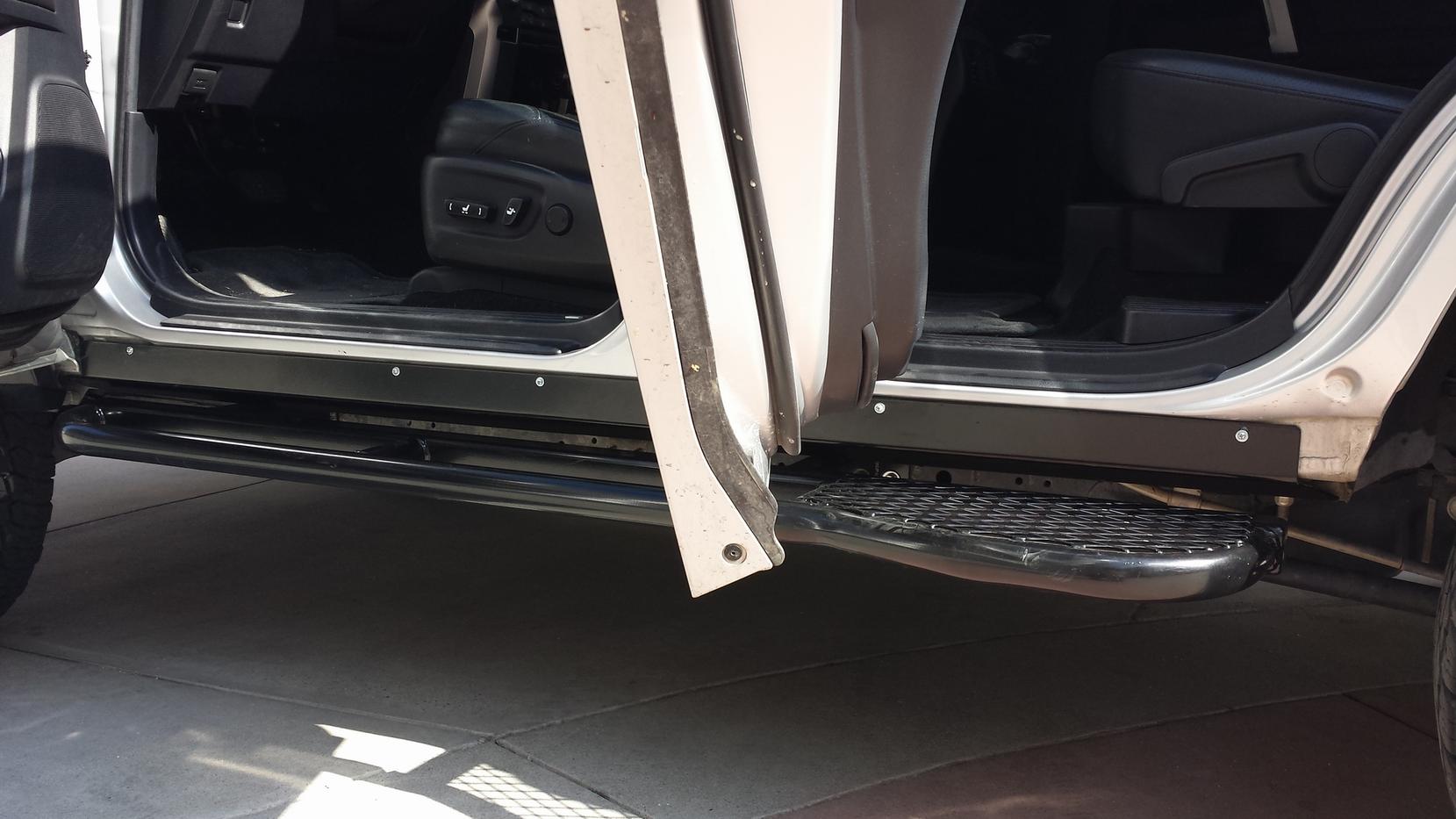

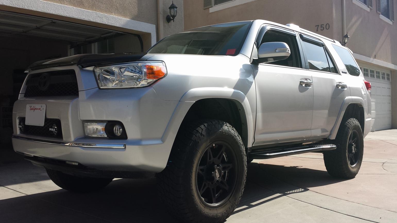

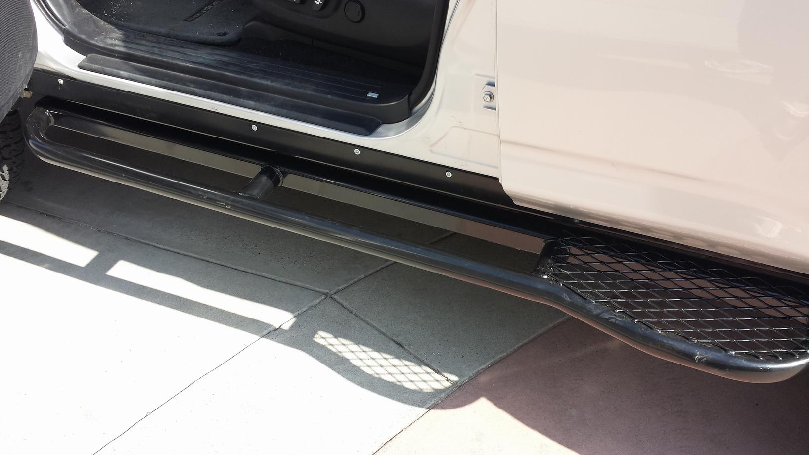

Installed over the weekend.
