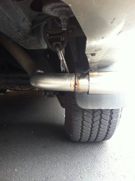

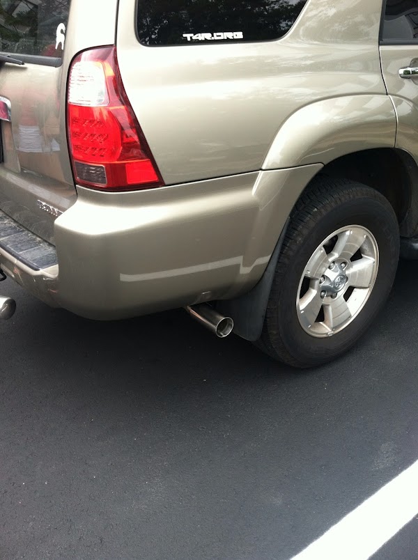

Got my side exhaust done yesterday. Just wanted to share the pics and thank T4R for the idea. Absolutely no exhaust smell with the rear window down anymore and I couldn't be happier.

Looks great, Ive been wanting to do that ever since I got my 4runner. Did you do the job yourself?
No, I got it done at Hi-Flo Exhaust in Manassas, VA. It was $90 for the tip and the labor.
Forgot to mention, I really didn't want to get any fumes with the window down so I went with the full 90 degree bend and used a double walled tip so I could get it close to the rear mudflap without melting it.
How is the sound and all? I'm about to replace my exhaust entirely and this is one task I am planning on working on at the same time. Without the resonator others have said theres a bit of noise at lower rpm's. How did yours end up?
Personally I cannot tell the difference, it sounds exactly like it always has.
