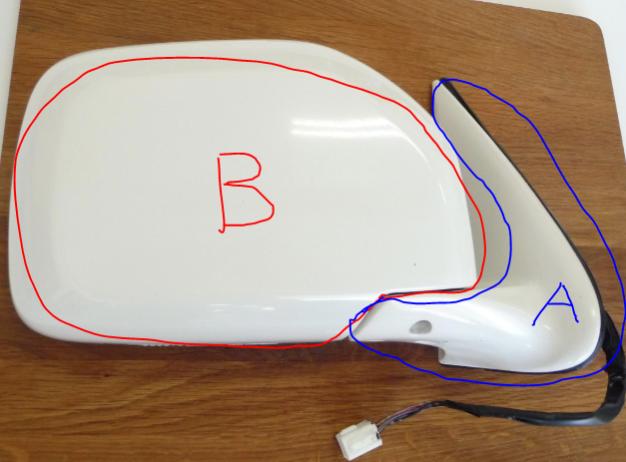

What about taking "part B" and swapping it onto the "old" "part A" from my picture?
Yeah but it's more effort then what it's worth. Part A isn't the problem it's the housing around the mirror that's got a chunk missing out of it. Well now I got a perfectly good '99 driver side mirror to decide what to do with..Oh well live and learn!
