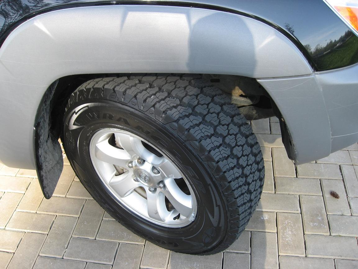

Fit:

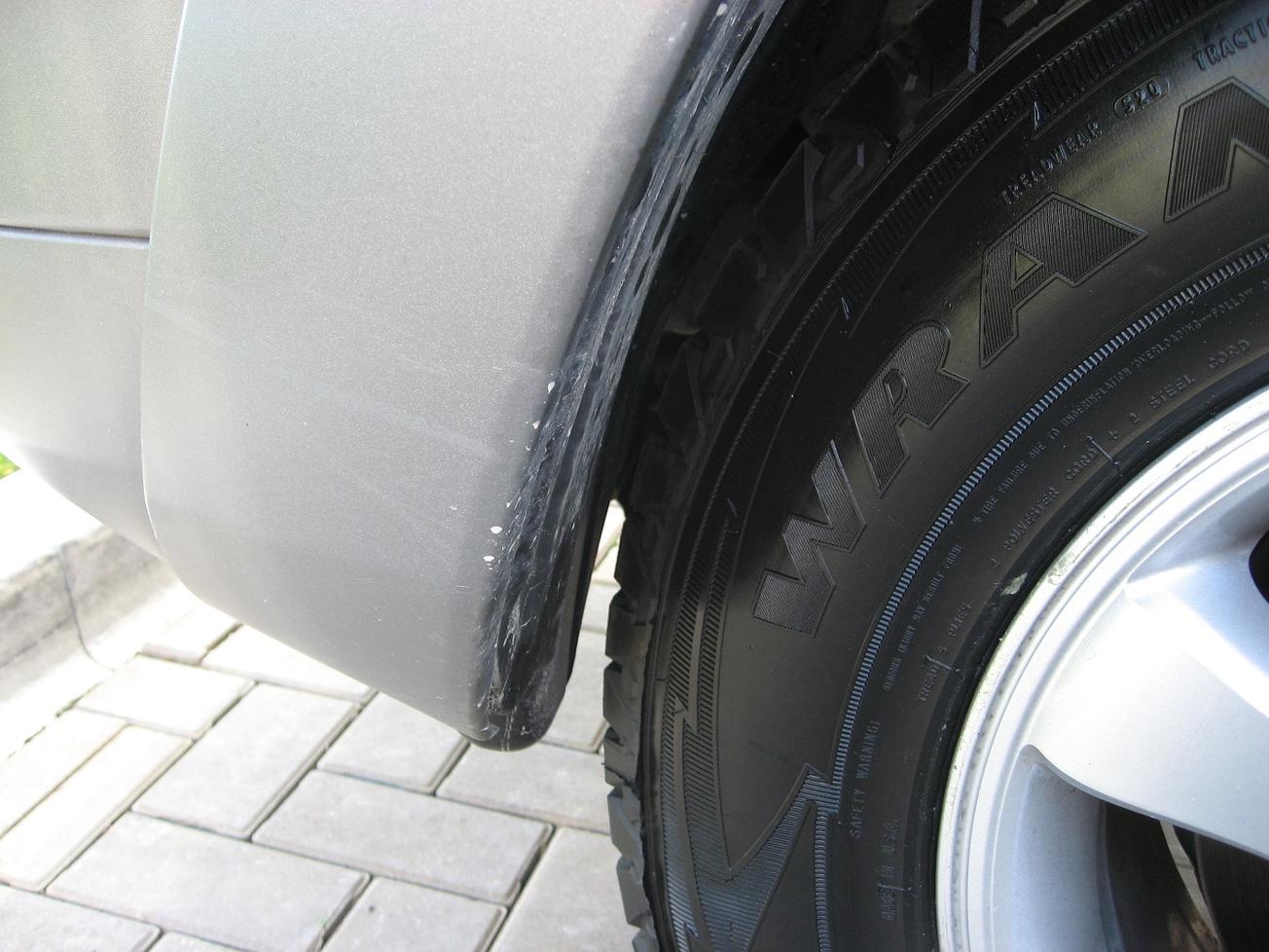

I have no lift and the tire fits without rubbing when the truck is stationary. Turning in the parking lot doesn't rub, but I got a bit of rubbing when braking while turning a corner. Not sure but I think it was the mud flap. No biggy for now, but I will want to address it. I am not overly surprised considering my stock tires rubbed in some turning situations that compressed the front end. The tire comes close the metal that connects the upper ball joint to the wheel. I can't remember how close it was with the original tires, so I can't compare. Anyway, not close enough to rub, but not much room for chains either. (I didn't even try putting chains on the front with the stock tires because things looked tight.) The back fits well with lots of room to spare for chains and full flex/articulation.

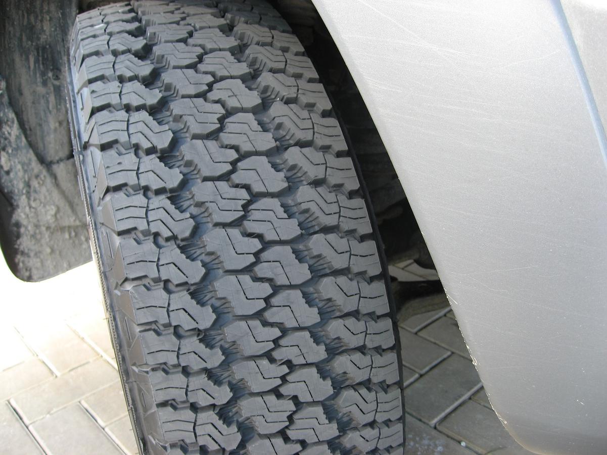

Siping:
Although the sipes don't appear to be the full tread depth, I think the centre of the sipes goes deeper than the edges. Either way, the sipes go more than half the dread depth. I expect to lose performance in winter and rain when they wear down past ~60%.
