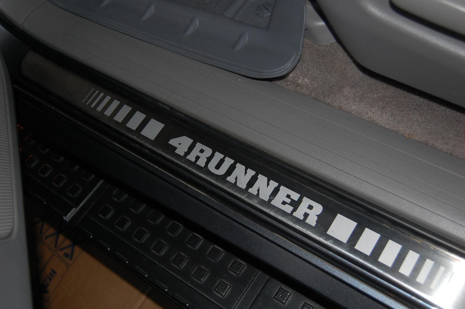

has any one removed this plate ? do I just use heat
which one? the gray interior, all you do it is pull from the front and work your way to the back.
the silver one, its held in place with double sided tape, its taped on top of the factory plastic sill. i think on the plastic sill it has clips at the bottom.
