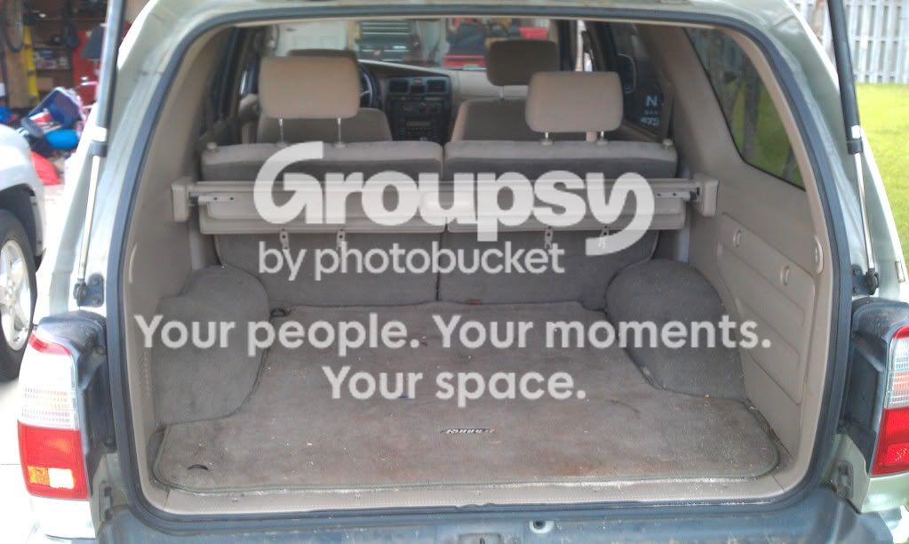

The interior, while in decent shape, was filthy.

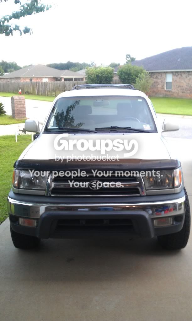

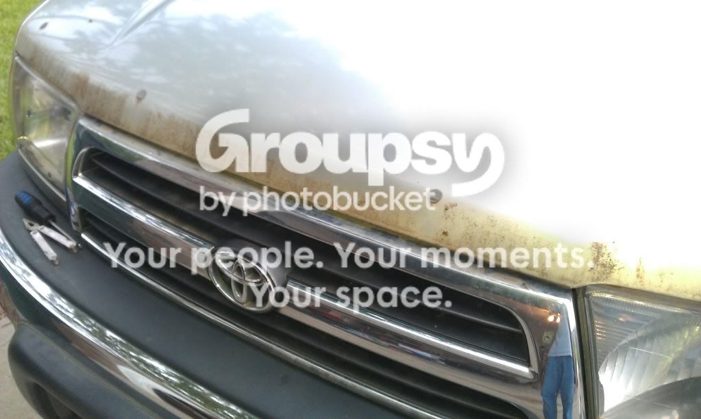

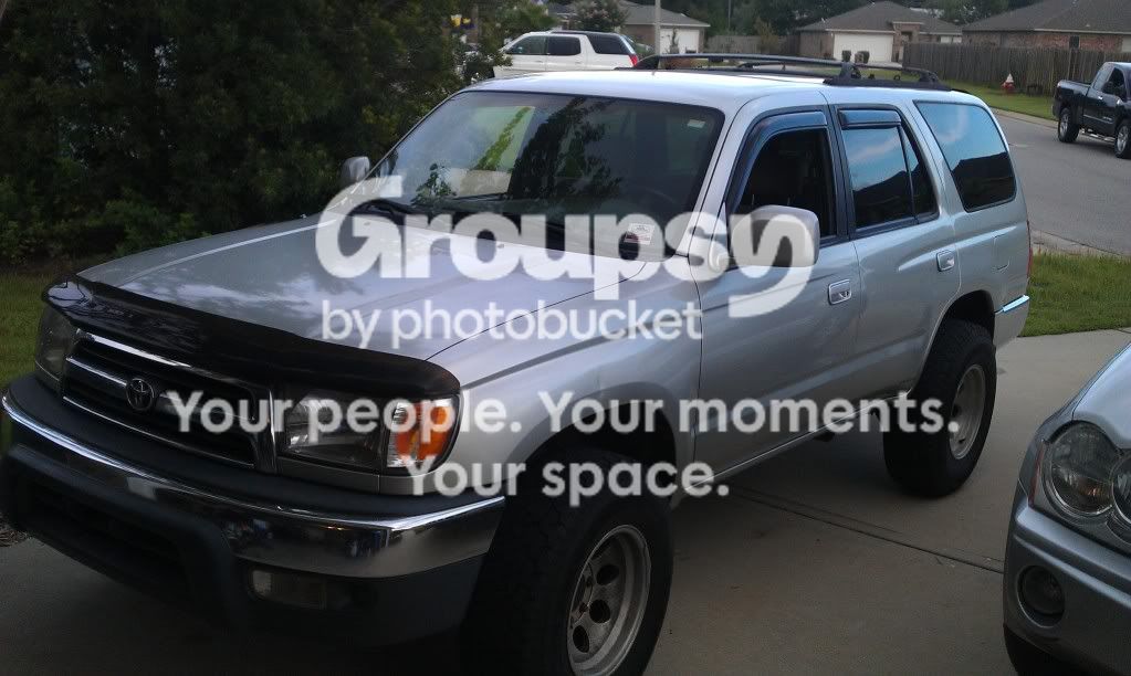

First thing to do when I brought it home was to ditch the cheesy bug shield, and rescue the paint underneath. The PO had let leaves and dirt just sit in there and it took a bit of elbow grease to clean and remove the adhesive from the rubber paint protectors.

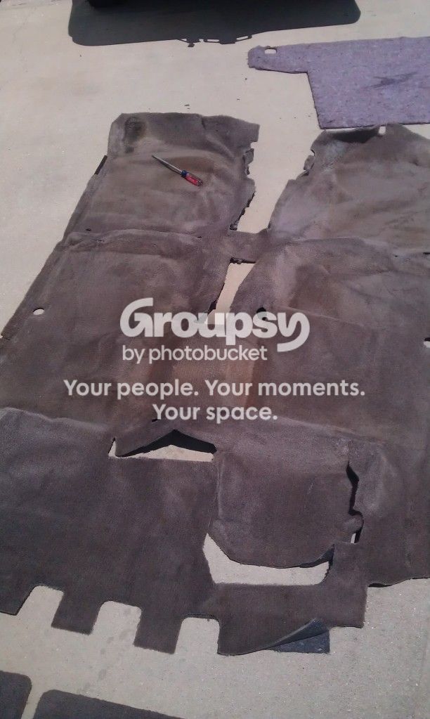

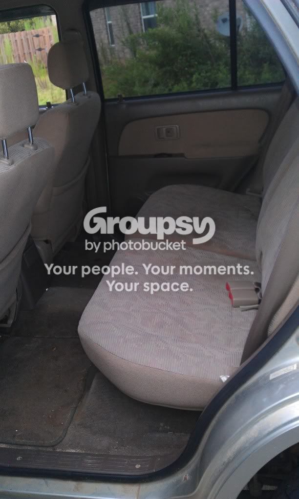

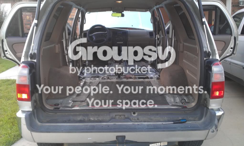

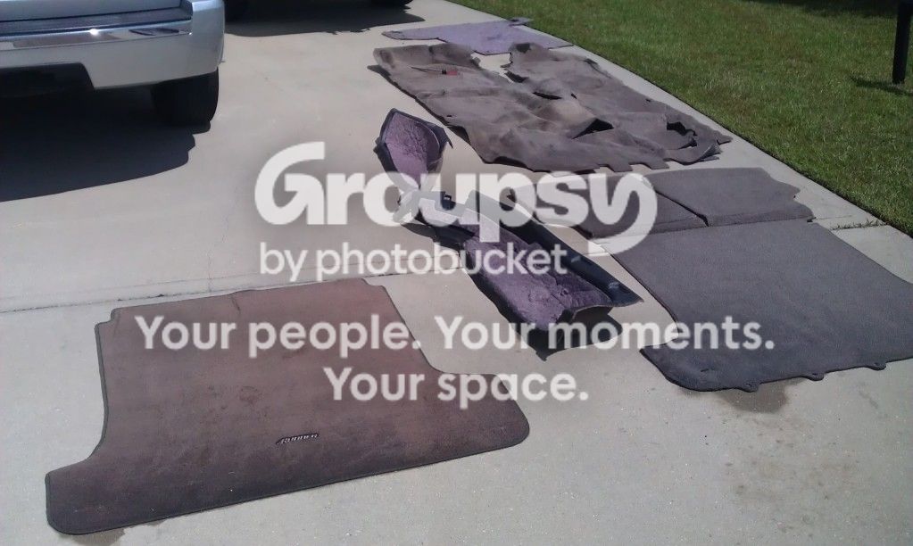

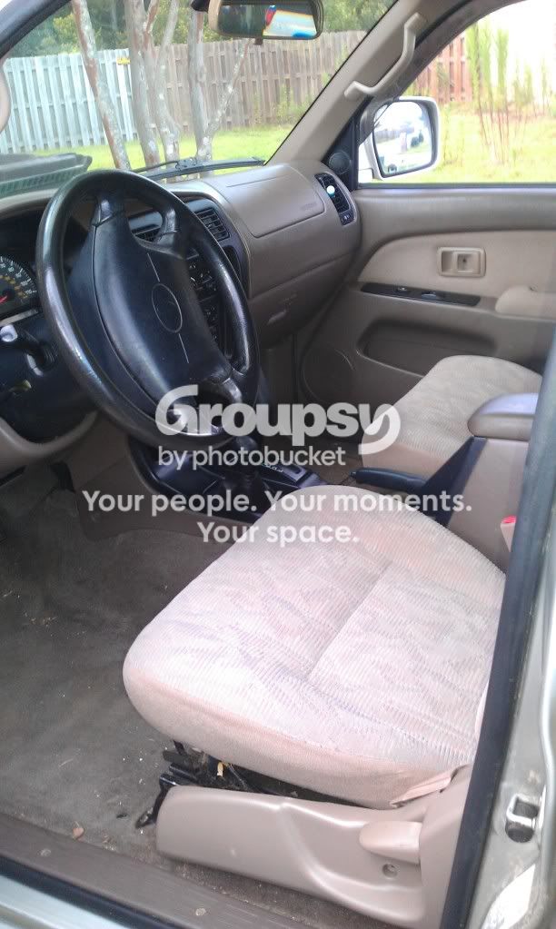

Next, every bit of the "soft" interior came out. I removed the seats, console, and all the carpet, and vacuumed the dirt and old food out of the bare floors. I took the carpet down to the local car wash and used the soap pressure washer on it, which worked incredibly well. While everything was out I armor-alled all the trim and dash pieces, febreezed the smoke smell out of the seats and headliner, and cleaned all the windows and door jambs. After getting everything back in, I realized this was probably the most satisfying interior detail I had ever done on any vehicle.

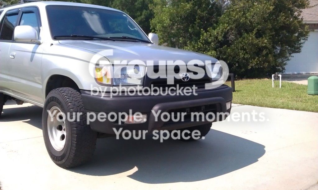

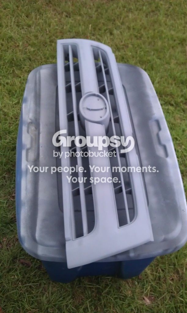

I removed the grill and front bumper and painted it with a combination of semigloss black paint and Plasti-dip, depending on the material.
Primed grill
IMAG0090.jpg~original
Finished product
IMAG0099.jpg~original

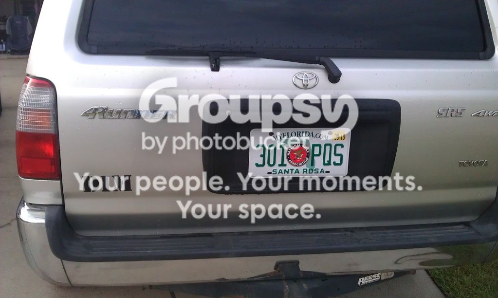

I also Plasti-dipped the rear license plate bezel, but I'm not crazy about how it turned out. The surface was faded and cracked, and the plasti-dip didn't fill the cracks like I would have liked. I will probably redo this at some point.

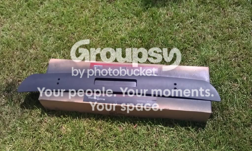

Sprayed the rear spoiler at the same time:
IMAG0072.jpg~original

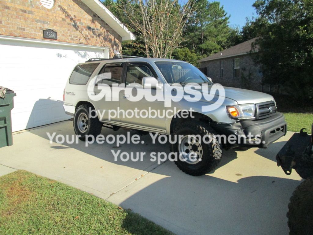

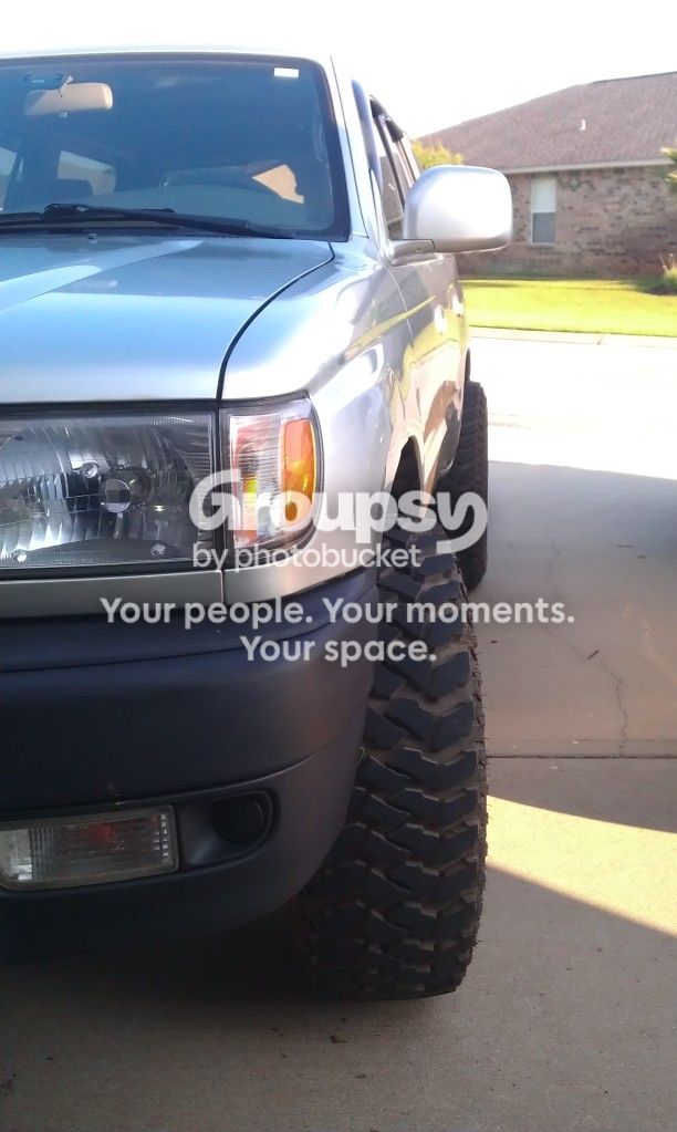

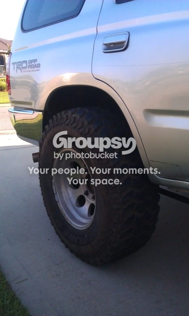

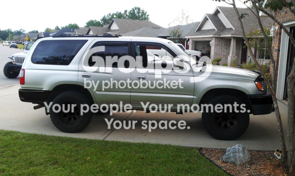

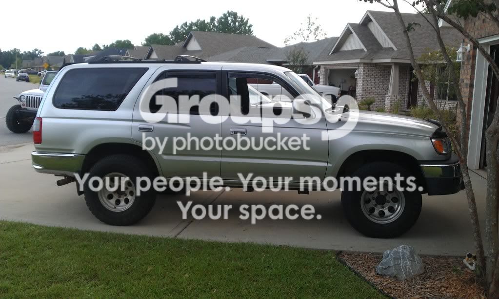

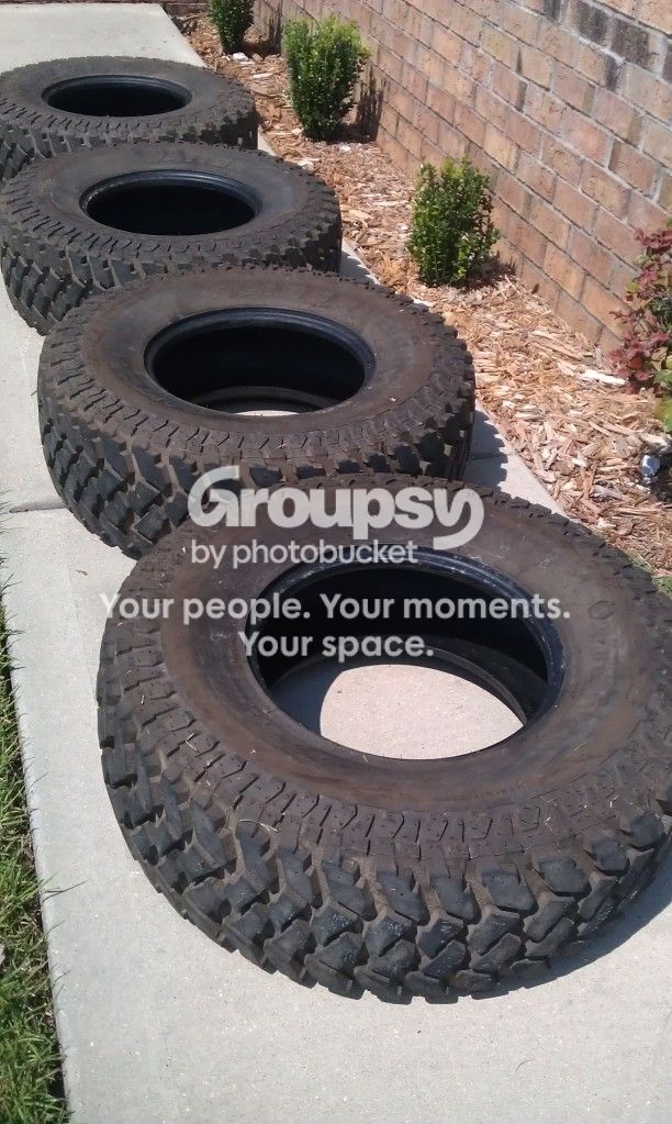

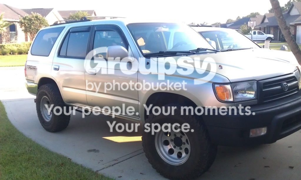

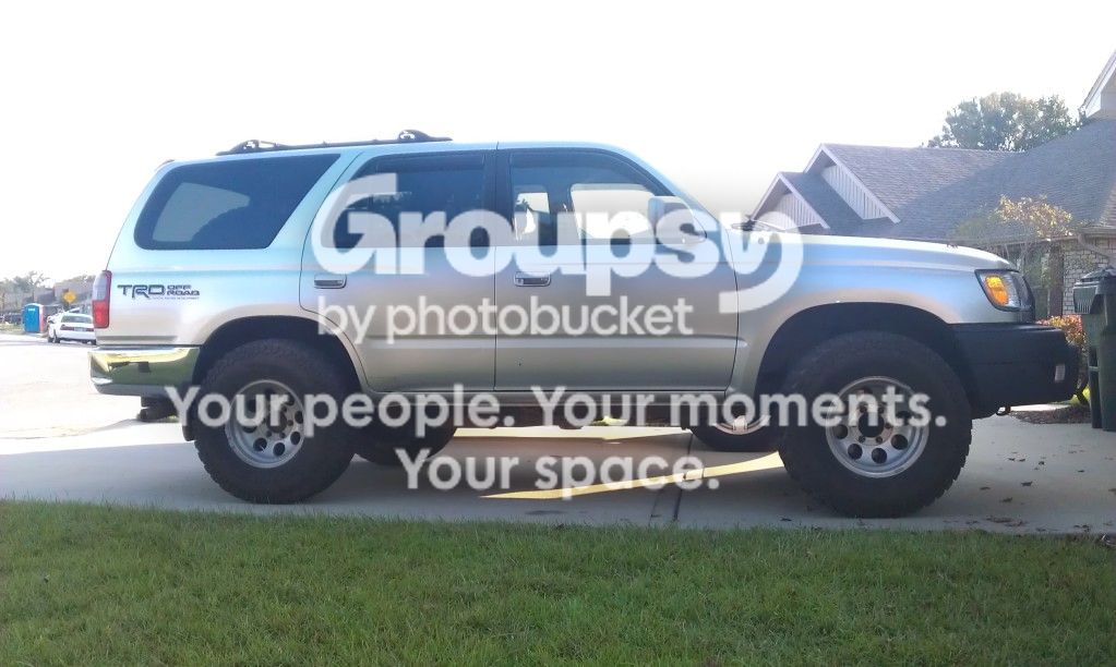

As you can see from the pics above, the tires were pretty worn. They were some 31x10.50x15 Spector all terrains that looked like a hybrid of the BFG ATs and General Grabber AT2s. They were probably a decent tire at some point, but were so worn they were about 28.5" tall(!) and provided very little traction. I had been scouring Craigslist for several weeks before I found a decent set of replacements. I came across these Dayton Timberline MTs for $300 that had about 90% tread on them still. I sold the worn out tires for $50, so for a net cost of 250 I had a decent set of tires. They are loud, but they're round and have a lot of tread. I can't complain.

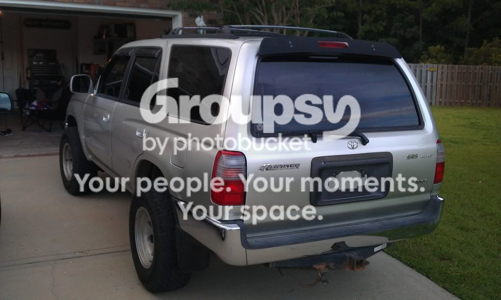

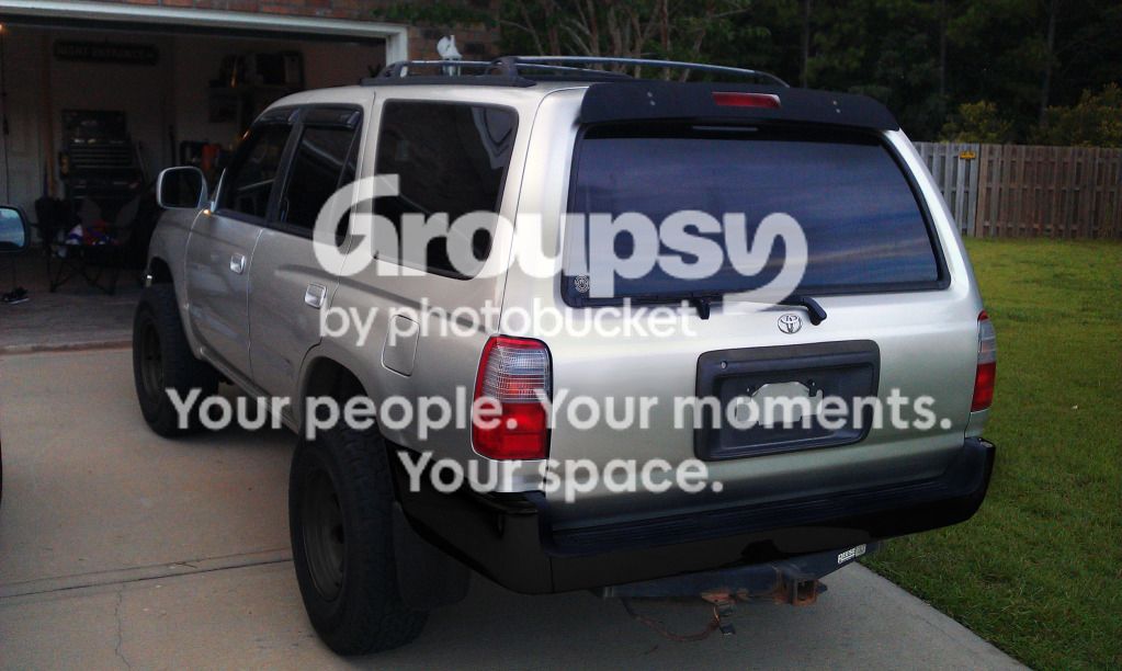

As you can see, I added the obligatory TRD decal on the rear panels. It's been done a couple times, but I really like the look, so sue me. I also removed all the emblems on the rear hatch with the exception of the Toyota logo. I don't think I have any pictures of that, though.

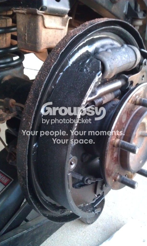

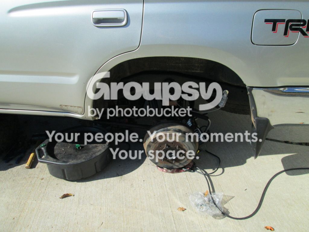

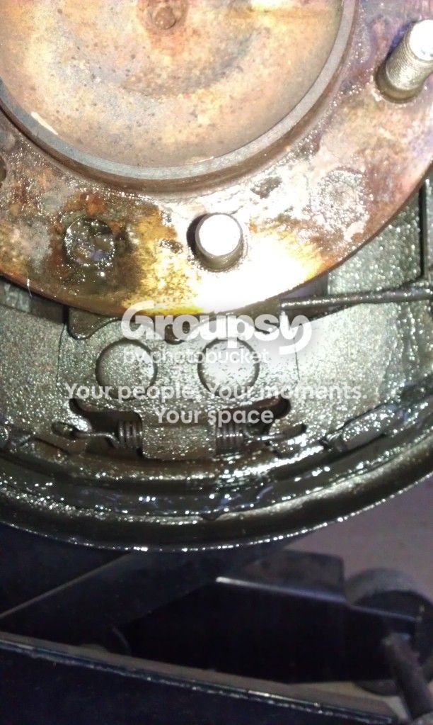

And here is where the build gets hairy. I had noticed a slight squeal coming from the passenger side rear brake, so I set out to pull the drum and see what I could find. I had never messed with drum brakes much, but figured I could handle it. When I removed the drum, this is what I found:
IMAG0212.jpg~original
IMAG0211.jpg~original

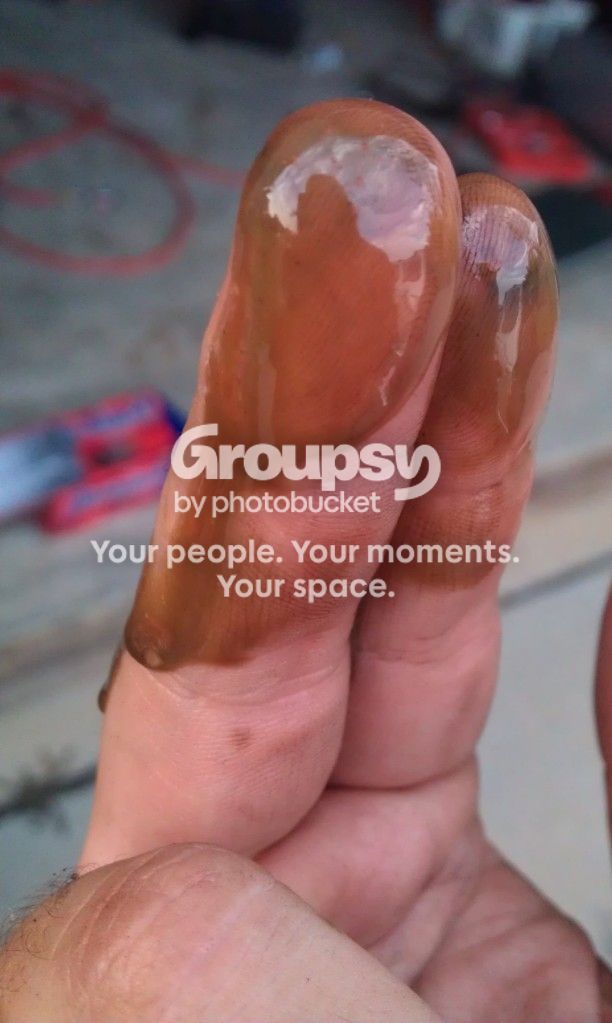

Yep, gear oil in the drum, and nasty gear oil at that:
IMAG0217.jpg~original
I replaced the inner seal and then started reading more about the wheel bearings. While the axle was pulled, I decided I'd check those, and sure enough, the backing plate flops around with some pretty severe play. To make matters worse, the driver side was even worse. After debating buying the tools and doing it myself, I decided to check around and get some pricing on parts and labor to replace the bearings. The local Toyota dealer wanted $800 for the job, even with the axles pulled. Everyone else I talked to basically told me they didn't want to do it. So... the 4Runner sat on jackstands, waiting for a miracle.

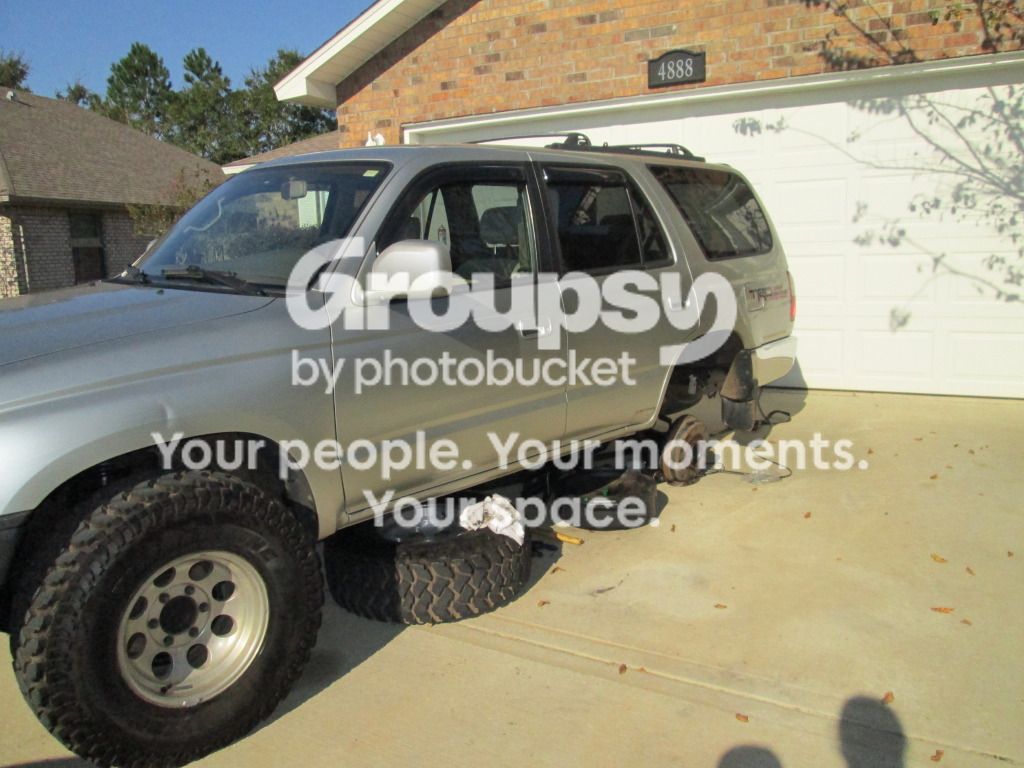

And instead of a miracle, it got a hit and run.
IMAG0222.jpg~original

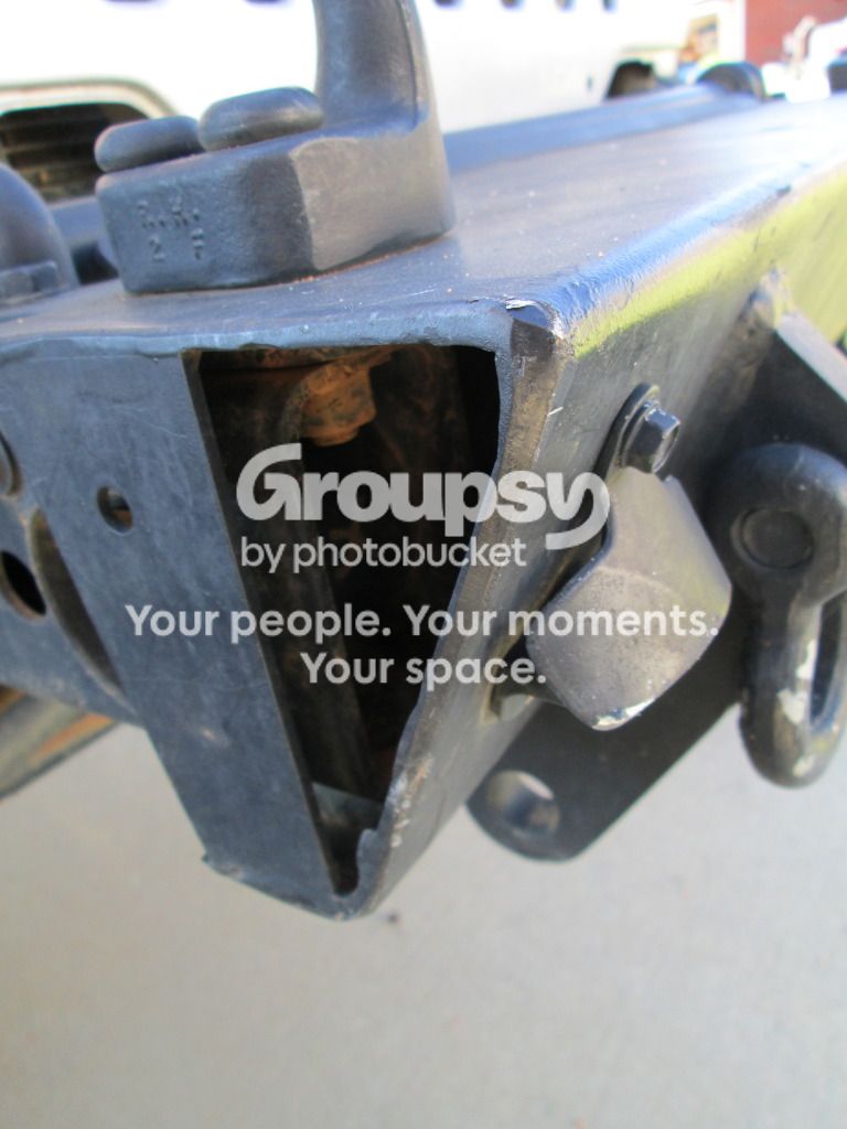

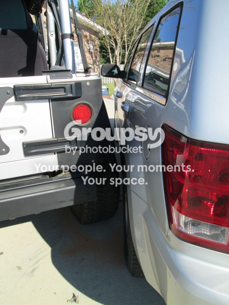

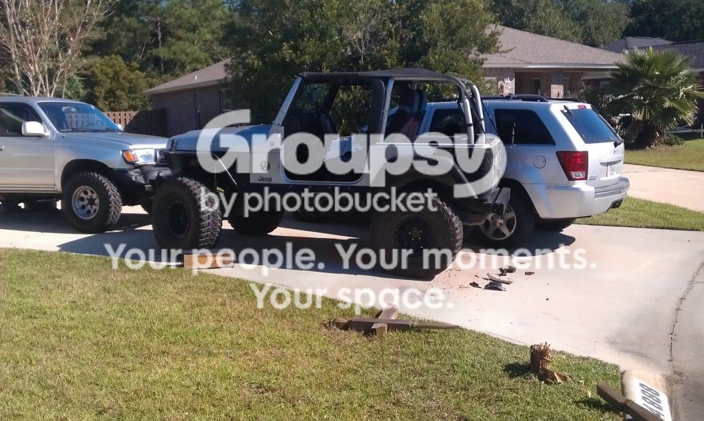

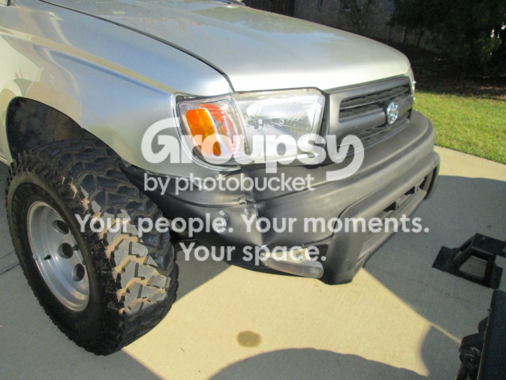

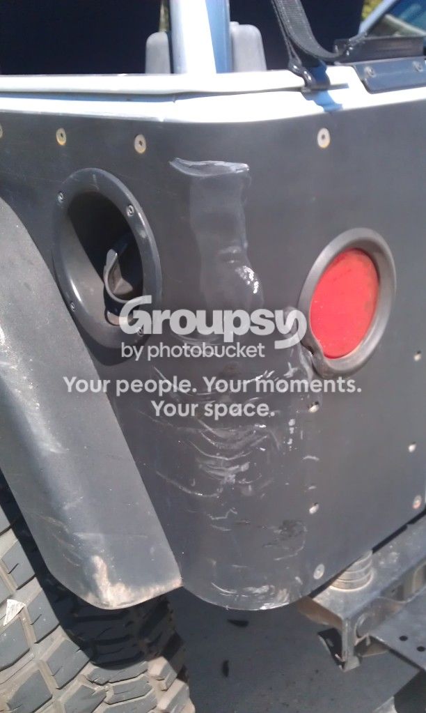

Some dbag was driving through my neighborhood and missed the curve in front of our house. They went through our mailbox, hit my jeep, and launched it into the front of the 4Runner. The trail corners on the jeep absorbed the impact to the body and bear no evidence of being in an accident except the scratched rattlecan paint job. The front bumper that hit the 4Runner had even less damage. Unfortunately, the 4Runner didn't fare as well. It was knocked back about 3-4 feet, off the jackstands and onto the rear wheels and axle. The front bumper, passenger fender, and a few trim pieces will need to be replaced.

The jeep missed hitting my wife's WK by less than two inches.

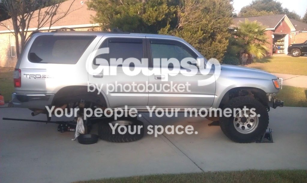

I pulled the front bumper and straightened the fender as best I could, and during the down time, put a 1.5" spacer lift on it. I have the parts for the rear bearings on order, and have a shop lined up to do the work. Once I get the axles back in I'll change the diff fluid, flush the brake fluid, and begin replacing body parts.

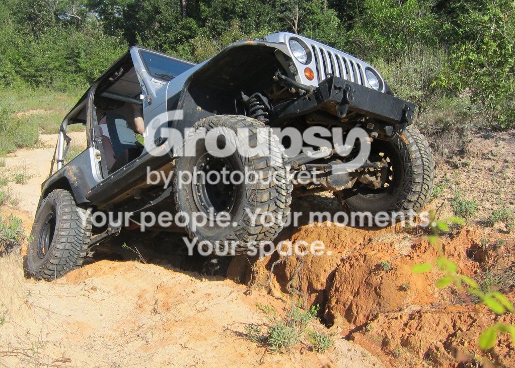

wheres the jeep?
Here's a couple pics of the jeep from the last time I went wheeling with a friend of mine. There's not a ton of diverse terrain here in NW Florida, but we try to make use of what we have.
