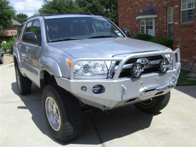

We've powdercoated a few silver. It looked really good and was a close match. Other than that, all I can say to convince her is that my wife's 4runner is the 3rd gen on our site...lifted, bumper and sliders....it's her DD and she works at a bank :biggrin2:

You mean you powder-coated one of the 4th Gen winch bumpers silver? That would be pretty sick, and easier to leverage wifely support than a black version...any pics? I've seen the black, white, and charcoal(?) versions on your site...all pretty sweet (I was actually leaning toward the charcoal-colored version), but a silver one would be sick...
Yea, we've done a 4th gen. I can't say it's a color match due to the finish but the customer was pretty picky and was very happy when he got it. If I had a silver, I'd go with it, I remember everyone here stopping at some point to mention how awesome it looked before it shipped.
