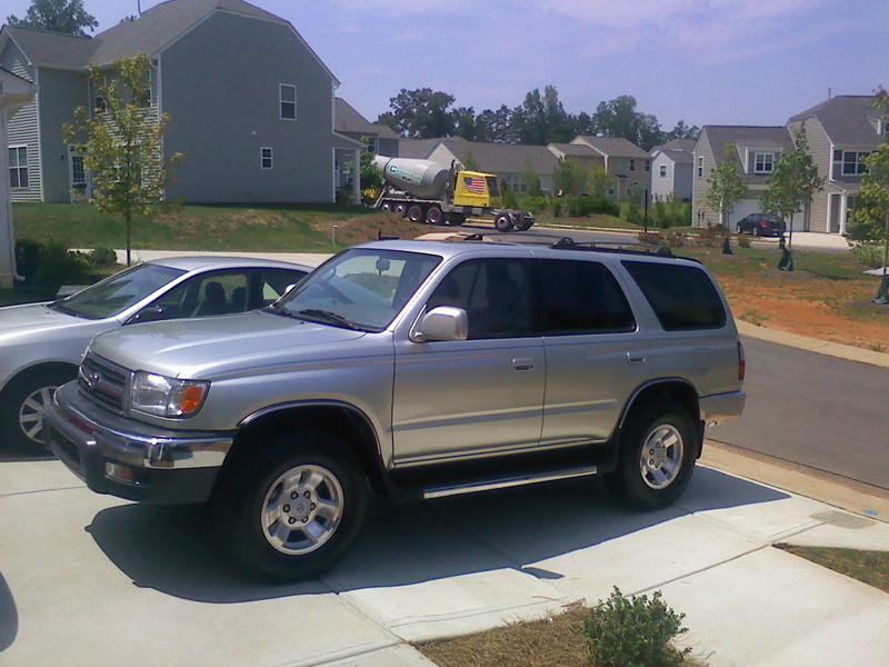

HEY! new to the 4runner forum, recently bought my "Sasha" after trading in my RSX. Last RSX forum was basically filled with haters who wanted to gloat on their intelligence and how their inline 4 was so amazing. Hopefully this forum is filled with helpful ideas.
Anywho, I have everything stock on her, she has 111k miles and runs like new, I know that adding tires and small things like that can lift the 4runner, but i was wondering if anyone knew of shocks/spring kits that can lift 1"+.
I'm not wanting anything to be crazy where i will have to install the lift AND then do a crap ton of other things just so i can drive.
Looking for kits or just a place to buy parts to do simple ride height upgrades.
P.S. Body kits are all out cause i saw how difficult/time consuming those are.
