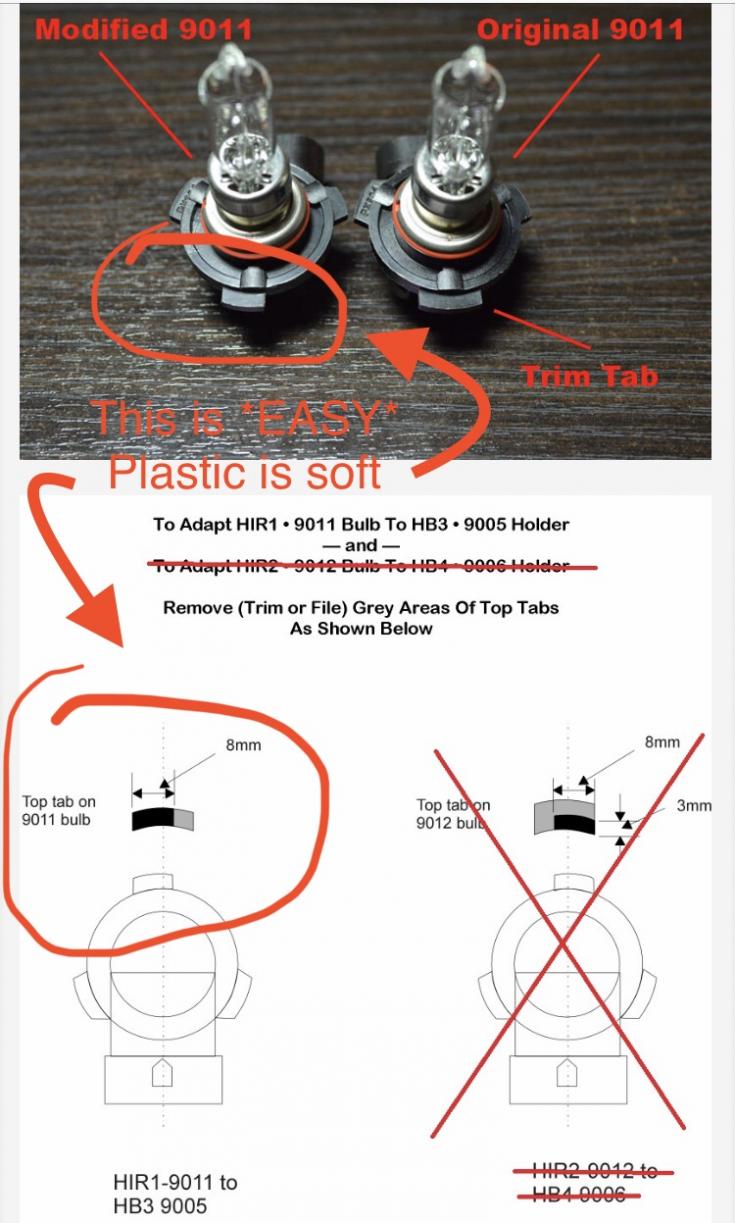

The mod to the high beam bulb (9011) is easy. All you do is snip off a little of the plastic tab with wire cutters. You could probably even do it with your toenail clippers.

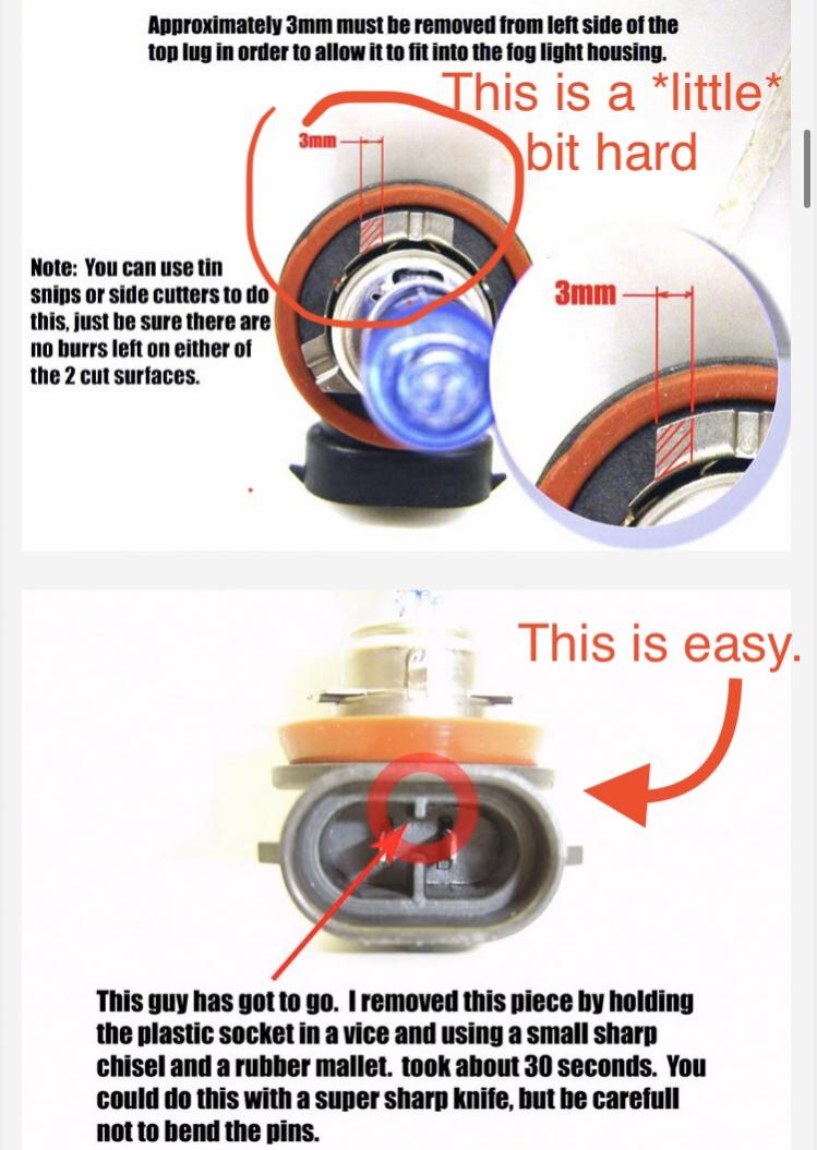

The low beam bulb H9 needs two operations, first an interior plastic piece removed from the socket. Score it with an xacto or knife blade on each side, grab it with needle nose pliers and bend back and forth. It will snap off cleanly, then trim off any remaining edges with your knife. Easy.
The second operation to the low beam bulb is the only *slightly* difficult thing: trimming the metal tab. Use a strong sharp wire cutter to cut the metal. It will take a few snips to work through the tab. Clean up the sharp edges with a file. Some folks use a dremel tool to do the cutting.
In any case, don’t touch the bulb glass with your fingers. But if you do, clean it off well with isopropyl alcohol and lint free cloth.
For physically accessing the headlight bulbs consult your 4Runner user manual.
—— End of tutorial ——
