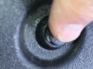

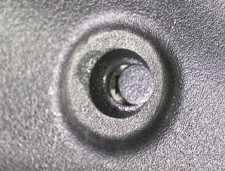

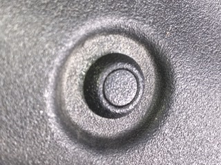

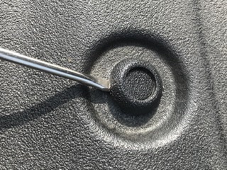

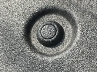

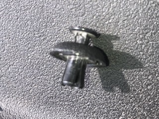

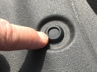

Are you referring to the 13 plastic clips in the radiator cowl? There’s an easy method to get them off, then back on, with no damage.
Push down center button to release.
Pry up the whole clip with screwdriver blade.
Restore the center push pin position, push it up so it’s raised above the rest of the clip body.
Re-install into hole in cowl.
Push the inner button down but only half way.
Done.

Are you referring to the 13 plastic clips in the radiator cowl? There’s an easy method to get them off with no damage.
Done.
Yup!! Now I know why they’re all broke !!! I did it wrong. Really wanted to just pay shop to do my fogs and Light bar because I’m clueless and in a rush to get them on for a weekly mountain drive that’s dark.
What’s the technical name or if you have part number , as I need to order them for when I get time to put light bar on.... then I can actually lock that dust cover down because right now maybe 2-3 and of those clips seem to be working the rest I broke.

I think they’re called Radiator cover clips.
I’ve tried googling around for a p/n but there are many similar parts. Better go to a dealer to find the correct part number.

How many you need? I broke a few awhile back and bought a bunch. the part # is 90467 07211
