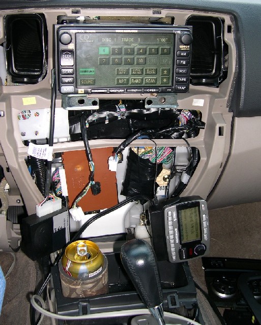

Installed my new Sirius Satellite radio with my Nav system this weekend. Works great! It shows up on the screen as a CD changer, but the sound quality is much better than the FM modulator - no interference.
Heres what I used -
PAC Aux-box with AB-TOY cable - from Logjam electronics
CD Changer 'Y' cable from local Toyota dealer
Sirius Sportster satellite reciever
While I had the thing taken apart, I wired in three 12V auxillary power outlets for the front....
Photo of the mess...

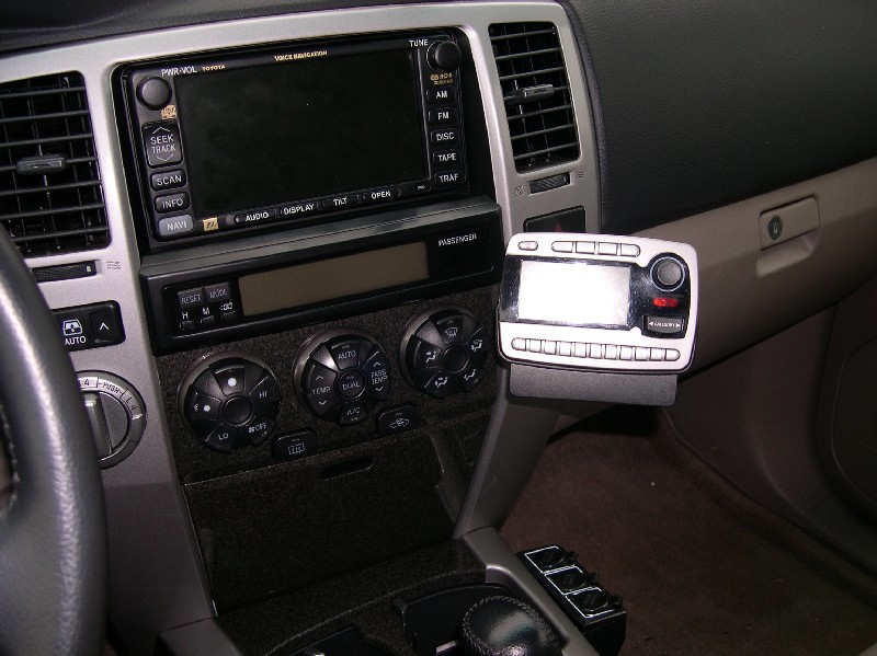

Here's the finished installation....

That looks pretty nice. Can you post a picture that better shows your mount and how it attaches to the dash? I am currently using an XM Roady2 hooked up using the provided tape adapter into the standard 04 cd/tape unit. I have the roady2 mounted on the "fast food" foldout tray using velcro. This setup does the job but I'm eventually looking to get an aux adapter (getting sick of static) and am looking for a better mount. Also, do you know if your adapter would work with the 05 solara nav units from oemvalue?
