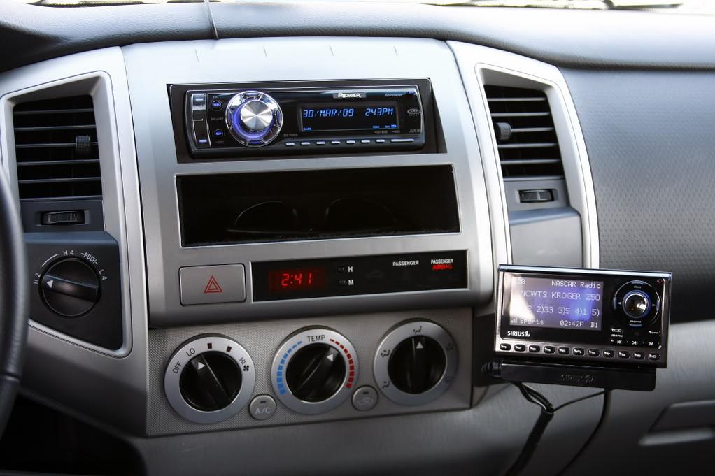

This is a pic I found on tacomaworld (posted by rocketball) of something similar. This is a 2nd gen Tacoma but you can picture how that universal braket would look when installed.

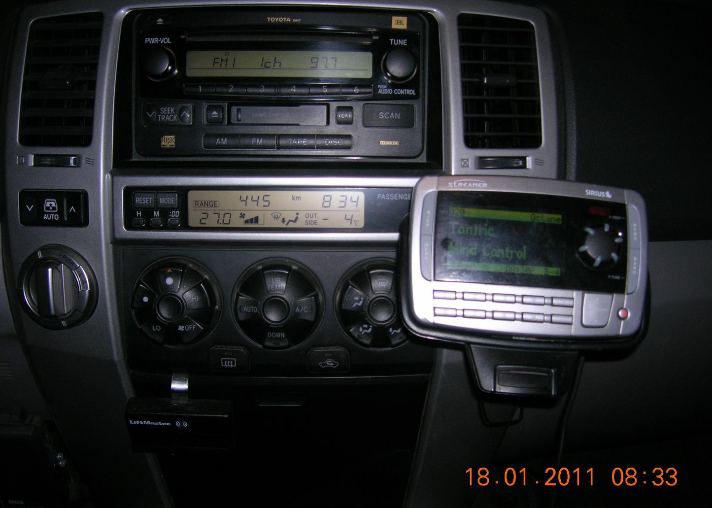

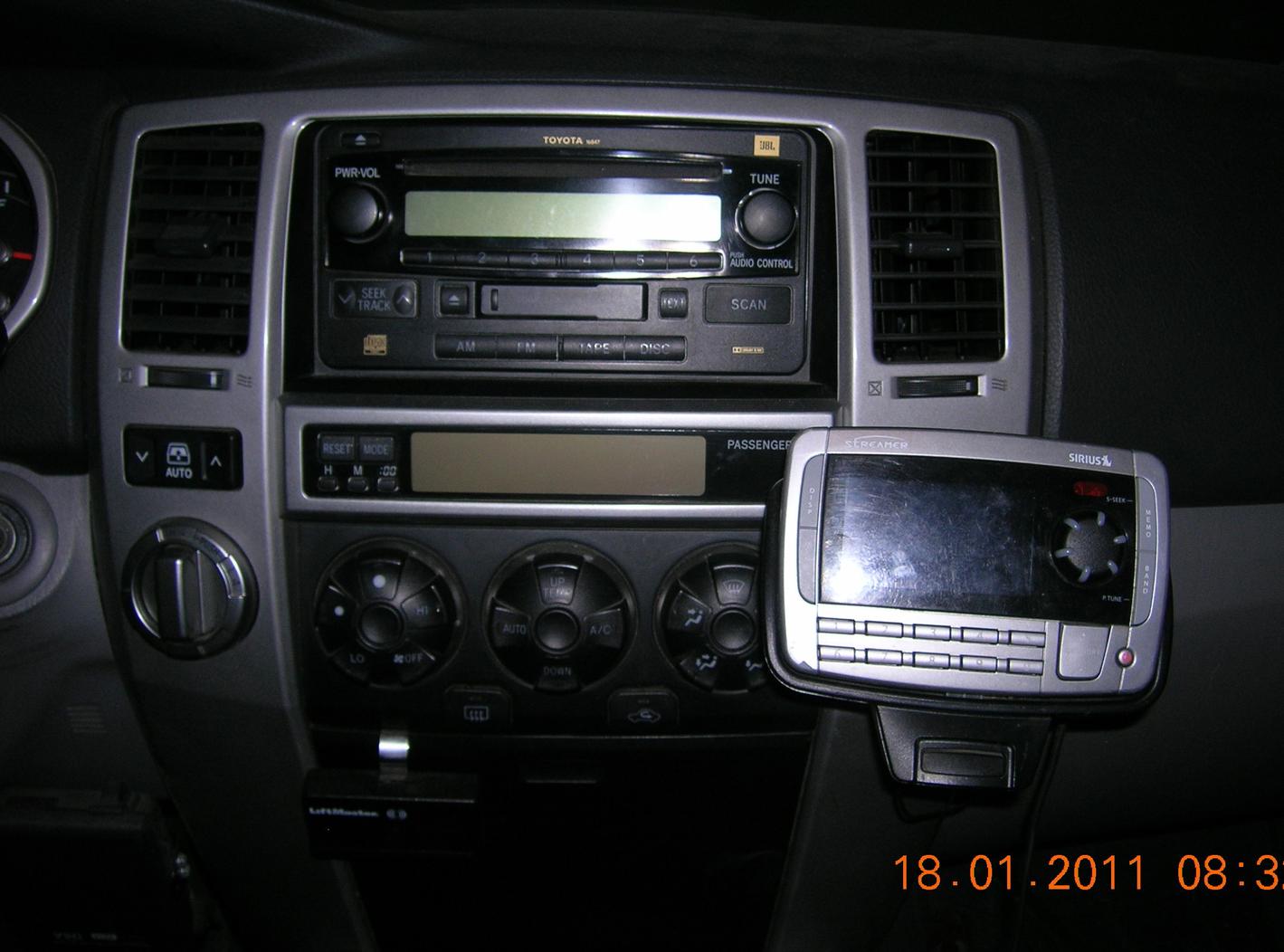

Sorry, I tried but I seemed to have lost a bunch of my pics of my 3rd gen including the radio.
I've included a couple of pics that I have in my 4th gen now. Same idea just different dash. On the 3rd gen the sat. radio is directly to the right of the factory radio rather than offset like it is with the 4th.
As for install, if you get the Panavise (and probably others) they have very good detailed install instructions. I followed the directions and they worked like a charm. They're specifically built for each vehicle so they'll describe every piece of trim etc you have to take out to make it work.
