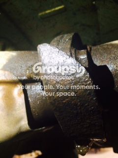

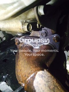

I'm trying to remove my rusted bolts and/or nuts on my catalytic converter, but no luck. I tried all kinds of rust remover and the bolts are just becoming round! Most likely going to cut them off... and buy new ones. Does anyone know the size of the them? I cant tell if im removing the actual bolt or just the nuts?

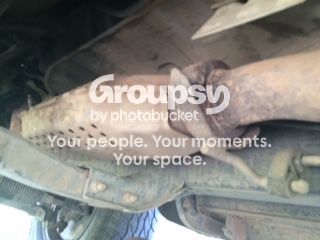

Both the top of the cat (3 bolts and 1 off to the side) near the engine and the bottom of the cat (2 bolts) that connects to the muffler. Thanks in advance, sorry completely naive to everything. Just a newbie here ;)

The two at the muffler and tail pipe I used stainless. Just matched up size at hardware store. Haven't had the others off yet.
when I replaced everything downpipe back I used 9/16th Head Bolts which slide in perfectly and also slid right in at the triple bolt flange without hitting in the pre threaded side( just barely). Im not sure about yours since you have the other style of flange. It took me about an Hour to remove each of the three bolts at the triple flange... Lots of PB blaster and vise grips on the bolt to back it out given that my bolts split in half with any sign of torque. The bolts are dual threaded, counter clockwise for attaching to the upper manifold flange and then regular for your bolts on the lower flange. I took my time and removed the dual threaded bolts so i could just use new ones. Install is so easy, Removal seems to be the bane of the 4runner ha.
I went through this same thing last year. It sucked. All the PB Blaster in the world didn't help me, neither did the torch. I rounded off all the nuts, and had to cut them off with a Drimmel. Then I took my drill and drilled out each stud, which took time and drill bits. I then went to Home Depot and got some bolts, nuts, washers, and lock washers to put it back together.
Those nuts are split locking nuts, and can be quite difficult to remove. I got two out of the three on the flange, but had to cut the third one off. I replaced them with OEM nuts from the dealership. I don't remember the price, but it was cheap.
Same with the bolts and nuts after the front cat. Dealership had them for a few bucks, so it was an easy choice.
If you're careful with a dremel, you can cut them off without damaging the threads on the studs. I cut most of the way through on two sides, then used a chisel to knock the halves off. No damage to the threads that way.
