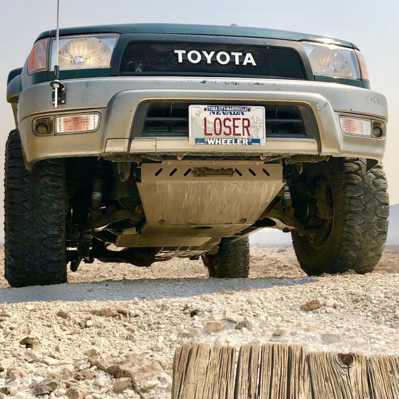

Just an excuse to post a pic. I have 3 pieces of the 4XI stuff and yes it is THIIC steel. Probably overkill for my dirt lowrider. For the transfer skid I did remove the little factory bashplate and added about 1/4" of washer/spacer for a bit more clearance. Skids are great but if you are in a situation that calls for them, sliders can protect you from a major body and door repair. Spend! Spend!
Is yours fairly new? Wondering if they started adding their logo sometimes since I bought mine. That was one of the reasons I initially bough their skid, cause they were one of the few who didn't put any sort of branding on it
Cool license plate too
