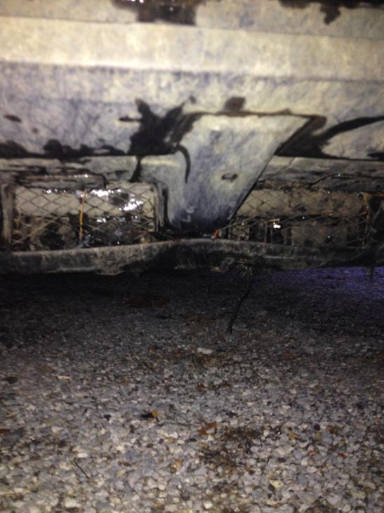

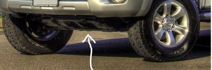

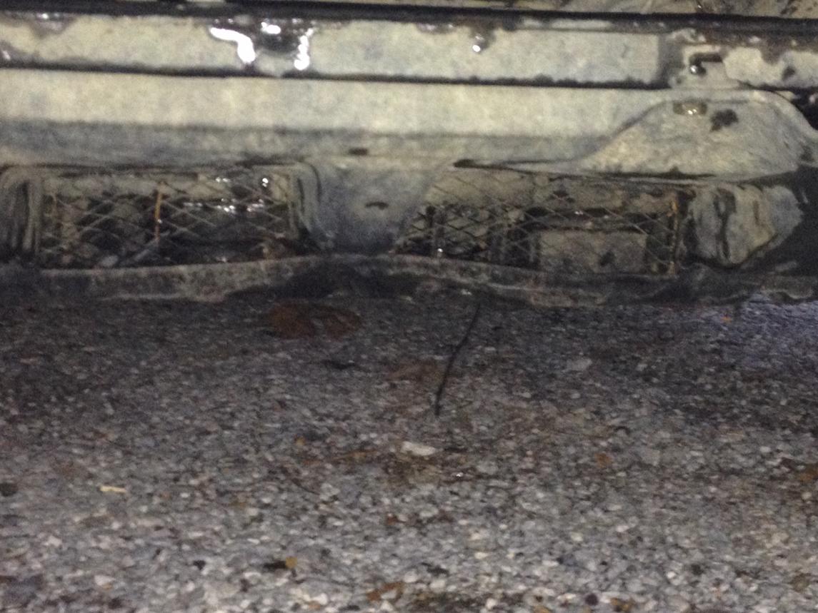

Today I was off-roading when I accidentally went over a large rock that caught the front and bent the "skid plate" I am assuming this is the correct word, and it bent. I stop as soon as I realized I had gotten hung up and backed up; so the point of impact was limited to the one area that is in the pictures.
The ground is wet, so I am not sure (and will check in the morning to confirm) but it does not appear anything is leaking, and the car drove normal and I did not hear anything abnormal. In the picture the area of impact appears to be wet, but this is just where I had been running my hand over it. Also, that thing that looks like it is dangling in the pictures is just a stick on the ground.
My question is, is this anything to worry about, or suggest correcting?
Also, how would you guys suggest correcting this issue? Thanks!
These might be dumb questions, however, I am new to 4runners and am still learning about them.
Thanks for the help and any input is appreciated!

That doesn't look like it bent up far enough to hit anything important, I wouldn't worry about it if it is driving normally. As far as how to correct it, you could remove the skid plate and try bending it back to shape, buy a new one (there should be a surplus of them on here from people who have put on aftermarket ones), replace it with an aftermarket one, or just leave it as-is since it looks to be just cosmetic damage.
It's just a skid plate, so no harm done. It looks like it did it's job! I suppose you could unbolt it from the truck and beat it back into shape with a hammer, but I wouldn't worry about it too much.
