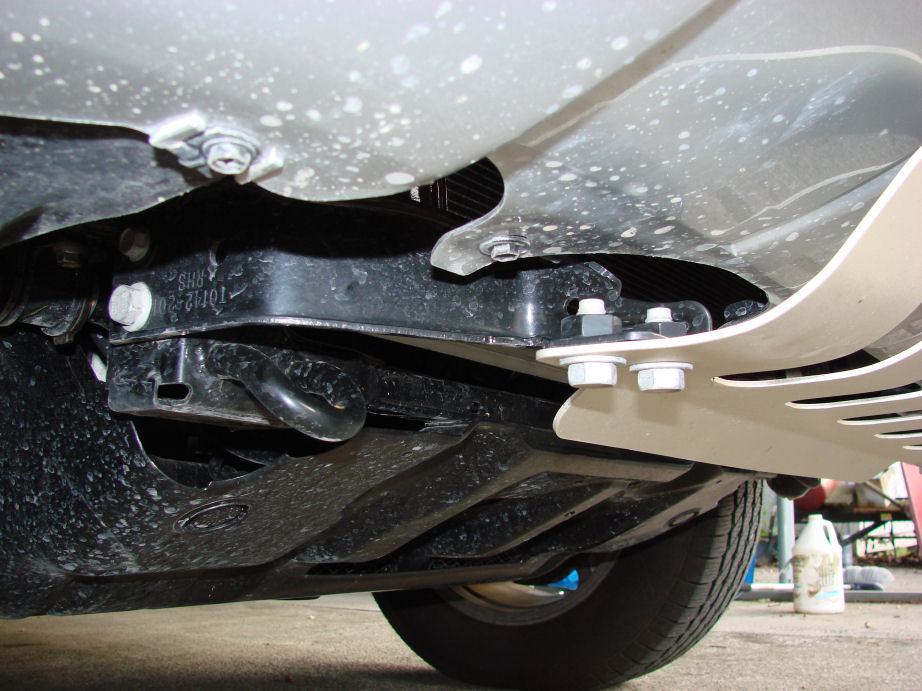

Can I see the picture of the bottom where the skid plate install, please?
Here's a close-up of my factory-installed skid plate.
If you want a few more photos from different angles, let me know, and I'll send them to you as an email attachment.
Thanks so much Atomic. That was exactly what I needed. I will install mine over the weekend so I can finally take some pics of my T4R.
