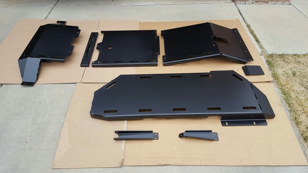

I like the Shrockworks set best. Extra mounting points and bracing up front, best t-case design IMO, I like the slots for a little extra air and drainage, and some much needed front coverage on the gas tank skid. Stick with steel if you plan to spend a lot of time in the rocks. Powdercoating is worth the money to save all the prep and painting and you'll spend half the cost on prep, primer, and rattle cans anyway; then again, I hate painting. Saved nearly $200 thru one of the group buys and while it may not be typical, had my skids in a week! Bare steel, powdercoated locally.

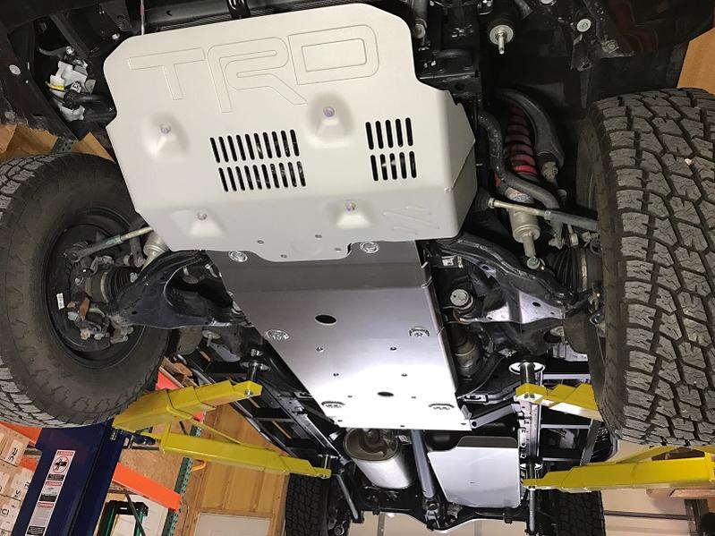

The TRD is slightly wider at the front but they are about the same size by the integration portion under the vehicle as the integration is cut to the same width as the rest of the RCI skid plates (see pic below). In terms of durability the TRD aluminum vs the RCI are the same thickness, I don't know enough metalogy to tell you what type of aluminum is "stronger". I purchased my aluminum RCI skids off of a person with a TRD Pro, who never installed them so that's why I went with the TRD front. If I bought the whole set myself I would have gone with the RCI. The seamlessness of one piece instead of two plus the oil filter hole for easier oil I feel is a better design. Also the integration skid sits too close to the front differential and you'll likely have to add a spacer (see link below), which has it sit about 1/8" lower then the TRD skid...not a completely flat surface. Works for my needs but if I were doing it from scratch I would do RCI.

Would it be possible to add a spacer to the rear bolts on the trd skid to even out the gap with the transition skid (never seen either in person so just wondering)?

Yes, im sure it is possible, but honestly I haven't had any issues with the small gap, just wanted to point it out. If you go this route be sure to read this, if you do put a snail 1/8" spacer you will definitely need to use the longer bolts that come with the TRD skid.

I did the full set from Shrockworks on 2017 TRD Pro. Two major learnings, you can’t reuse your front (aluminum) skid, have to modify it or buy Shrockworks front bumper and skid, and drivers side gas tank skid at rear needs (in my opinion) an added support which cost me $125 to build and install at local 4x4 shop. I just did black rattle can spray. Very happy with end result.

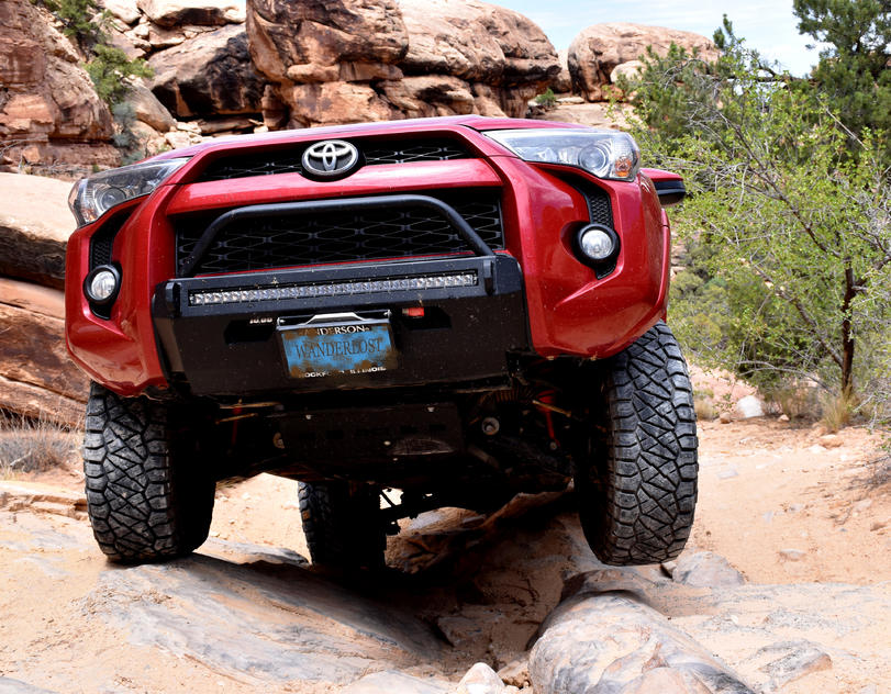

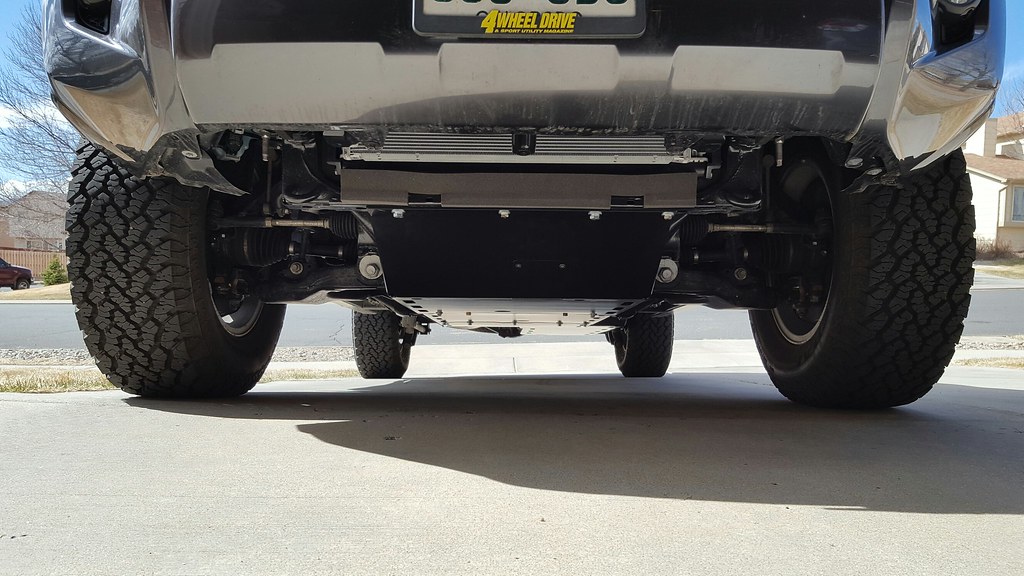

Does anyone have a picture of a RCI skid with a SSO Slim Line front bumper?
I wondering if there are gaps below the bumper and if so how to cover them up.

This might be a little too dark to see but the gap that is left is very small, maybe an inch. It would be smaller if you don't run with a diff drop kit. We have a complete RCI install video over on our YouTube channel that would show it much better.

I picked up the full set of skid plates from Shrockworks. They are incredibly sturdy and easy to install. Sand them, spray primer, spray paint, and install with a socket set. I painted mine semi-gloss black and they look pretty good.
If you scuff them, just get out your rattle can of spray paint and fix it. :)
