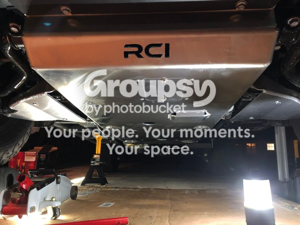

I went with the full RCI aluminum and steel everything-else skids from the last group buy. So happy I did. They did their job and got dinged up in the Sierras on my trip last month. I tumbled a rock and the fuel skid has a long dent in it. PHEW! Couldn't be happier.
Install photo.

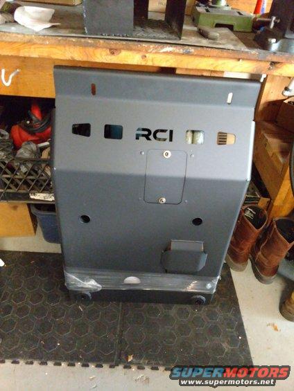

Just got my RCI powder coated steel skid in the mail yesterday. Waiting on the filler plate, but that should be here today. Will try to get it installed when I get home from work..
First observations are that this skid is well designed and super beefy..I've got armor on my off road rig and this is definitely on par with that..It is heavy as hell, but that's to be expected.
