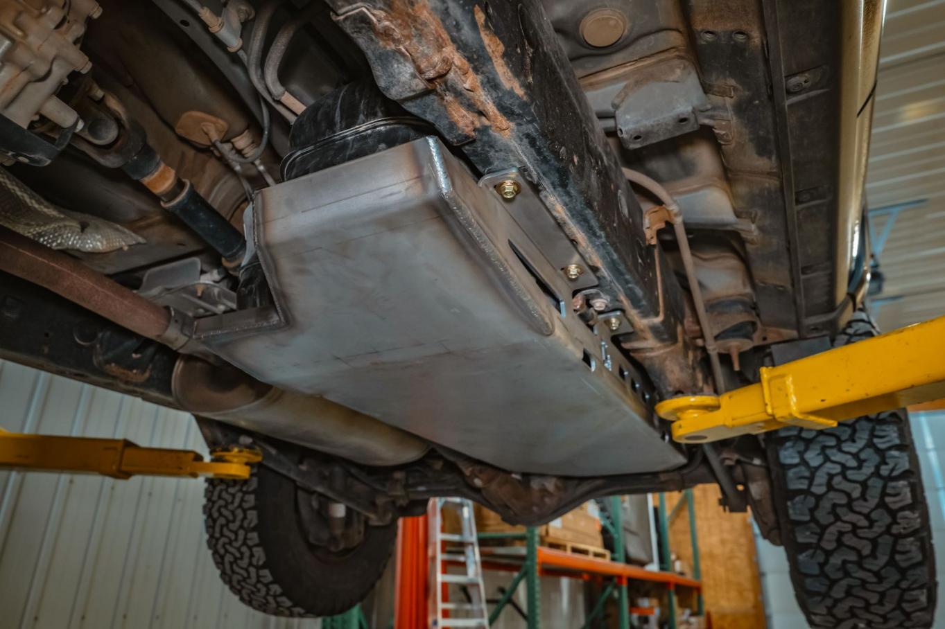

I have RCI except for the fuel tank skid. Their fuel tank skid design is not ideal, since the front end is fairly exposed to stuff being kicked (rocks, branches, etc.) There is a thread somewhere of some guy that added a bunch of extra aluminum to the front of his after he ran into problems.
I went with the Rago fuel tank skid instead - it does a much better job of covering the front end is no more expensive, and they will make it in aluminum or steel to match whatever else you decide. Highly reccomended.
RCI redesigned their gas tank skid, by the way. I have full RCI set including the redesigned gas tank skid. The front of the gas tank skid is reinforced.

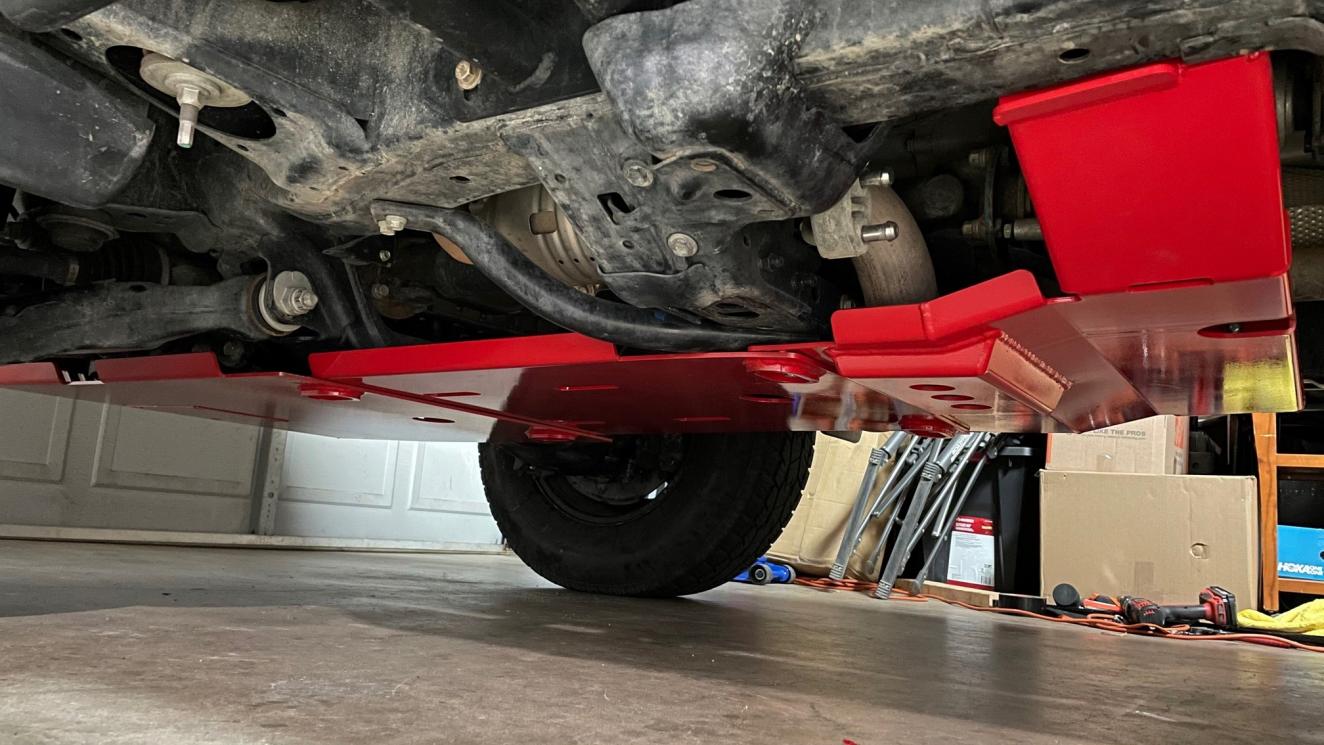

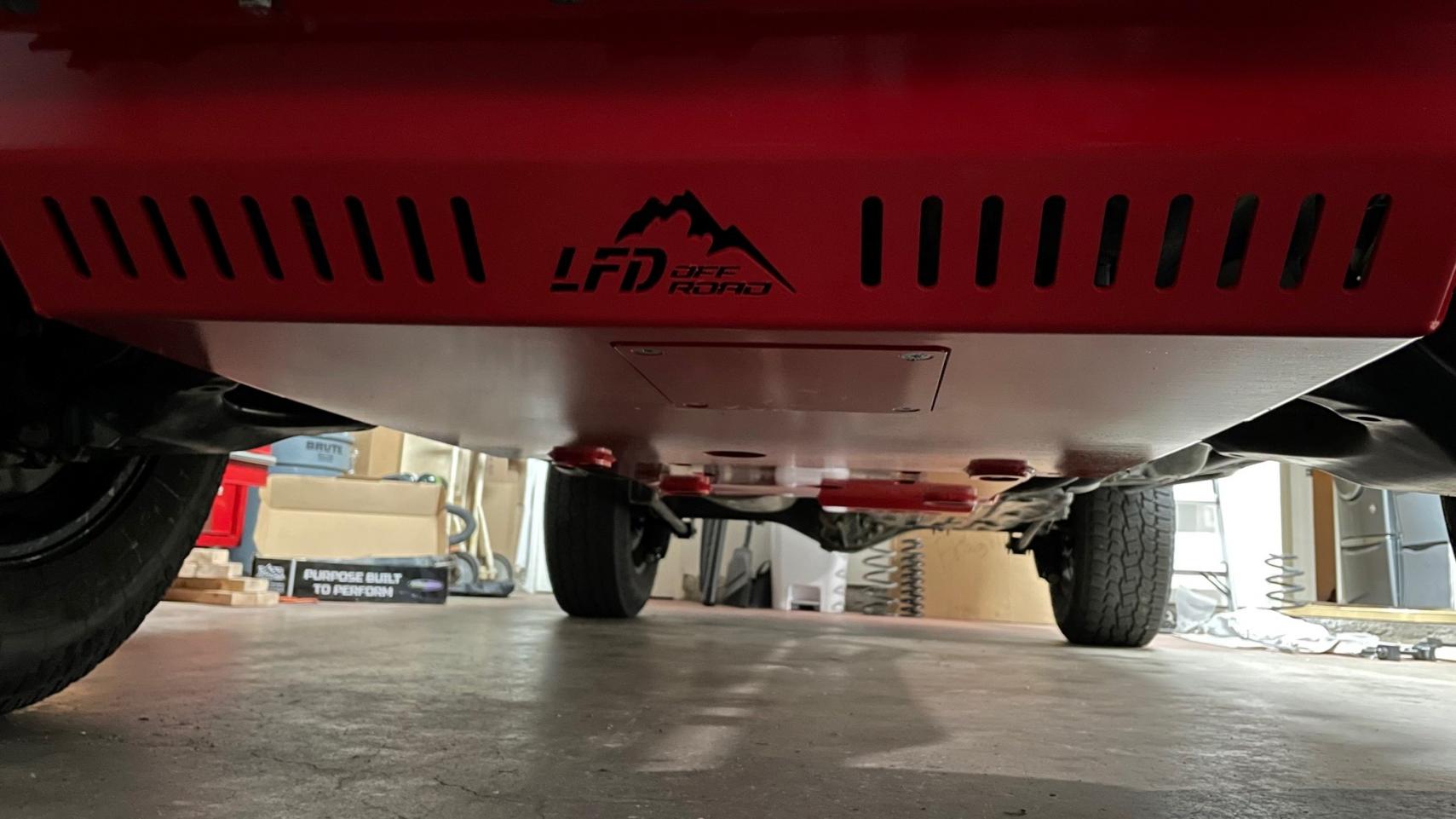

I have LFD front and transmission skids with RCI transfer case skid plate. I want to say that RCI redesigned their transfer case skid plates to eliminate the exhaust rattle from getting rocks/dirt/mud stuck between the plate and exhaust.

It's better than a few years ago, but it still leaves a fair amount of the front unprotected. If you look at the Rago, you will see the entire front is covered as well as the leading edges of both sides. I'm sure it's a good product - I have RCI elsewhere and I am satisfied with them - but since the OP was asking for input, good to flag the differences for their benefit.

Come on, post up some pics of those beautiful red skids. Any scuffs from our Gleghorn run?
Fine...Fine!!! Here are some pics! No, I did not scrape with my new found clearance with the suspension upgrades and bigger tires!
I'd agree with this - I wouldn't mind more coverage up front on my V2 RCI fuel tank skid. I'd argue that even the factory piece turned up more at the very front. It's a minor issue, but one worth mentioning.
If it gets to the point of bothering me enough, I may follow in the footsteps of other members and modify the front edge of mine with a piece of aluminum. For now I'll leave it be.
