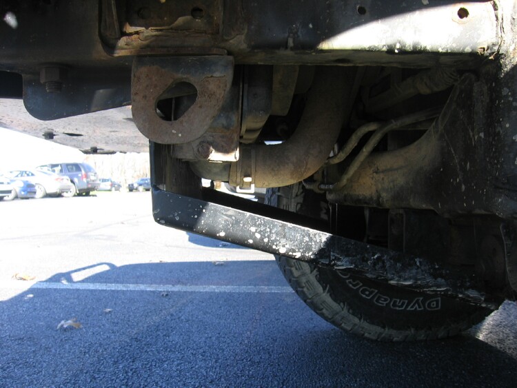

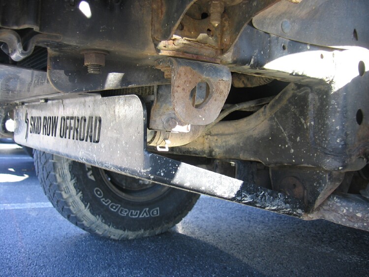

I do not have a body lift so my radiator is in the factory location. You can see the clearance that it has.
Hope this helps.

Thanks for the pics ! It should be fine, I don't wheel too hard over rocks and stuff out here in northern ny, mostly trails and logs and wooded areas ....just want somethig covering rad before it gets trashed or a hole put through it ....il be oredering one prob tom ....then hopefully gettin a odl front bumper in a month or so ! Can't wait
