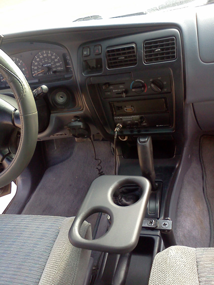

First, I realized that the front lift was a bit higher than the rear, rear end sag of course. So I picked up some OME 891’s and put in a Diff drop kit. Recovery and protection was on the top of the list. Hi-lift, shovel and CB transferred to the 4Runner. I did a bit of dash work and got the CB just under the AM/FM radio.

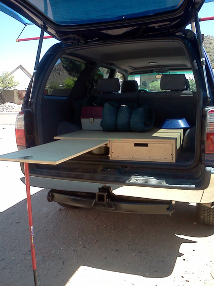

I do quite a bit of camping with my son (Hunter). So we decided it was time for a sleeping platform drawer system build. We put together a mock up setup that has lasted a few years.

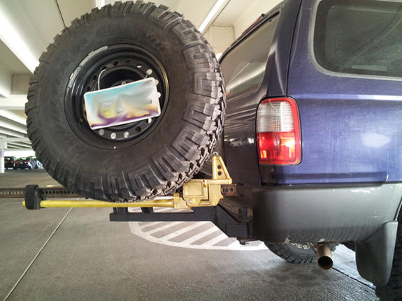

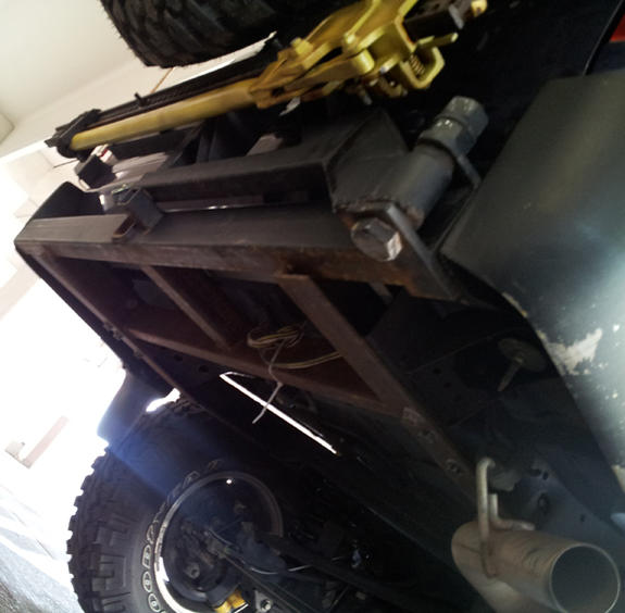

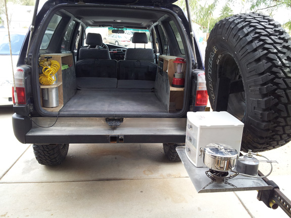

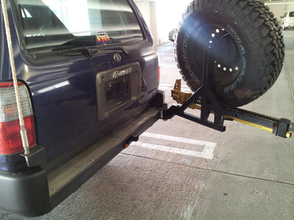

Till now…With the addition of new tires, I had a bit of a fitment issue with the spare…well what the heck…time for a bumper built I figured. I started by pulling all the trash metal off the back. Left the side skirts and welded a plate to bolt on each side of the body by the tail lights. Made a few frame brackets that ran about 2 feet up the frame, threw in a cross member, tow port, and made a shear based swing gate. Subsequently…I have reworked the gate several times, raised the tire to prevent interference with my expo trailer I built during all this fun…and recently relocating the Hi-lift to the bumper as well in my weight reduction attempts.
I built a Notebook swivel platform for the cab, this was later modified to run my iPad/Bad Elf GPS system. Of course…I needed power so a few electrical mods were done to increase USB and Cig lighter ports into the dash. ABS bypass was done while under the dash. Somewhere along the line I passed the HAM test and installed a removable HAM radio to the glove box. I moved the mag mount CB antennae from the roof after welding up a tail light antennae bracket.

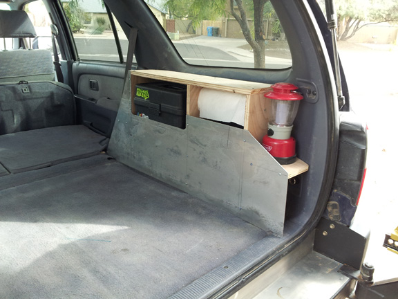

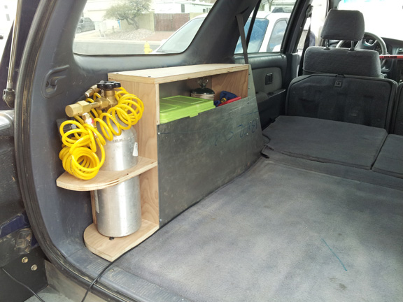

The recent adventure gave motivation for better comfort while camping/sleeping. So, I ditched the roof rack temporarily (weight reduction) demolished the mock up drawers system and built a split storage system with specific item placement construction. This was based on a list I kept of frequently used camping gear. The un-used gear was stored for another day. I moved the hi-lift to the swingate bumper after removing the roof rack. Built a removable aluminum table that mounts to the swingate as well.

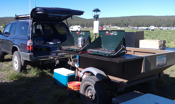

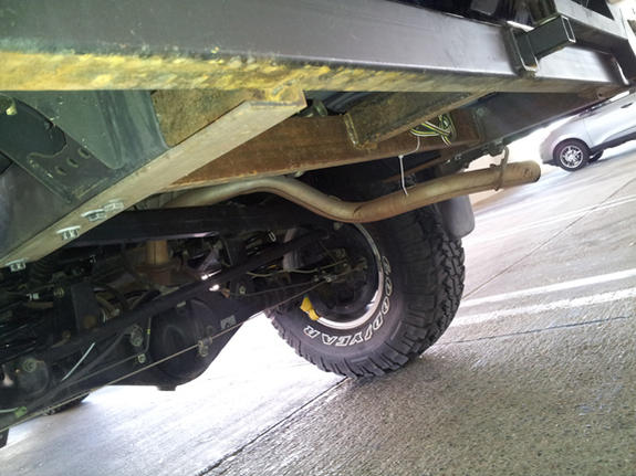

Somewhere during all this chaos I managed to build an expo style trailer from a boat trailer I had. I modified the frame and suspension on it, and built a storage box. Don’t use it much though; enjoy the freedom of not dragging it around.

I like your built-in table attachment on your swing out....and was that trailer pic taken at Lake Morman during the Expo?
Yeah we were way out in the North-40 too...was nice when they finally brought out another bank of port-a-potties for those of us in the sticks. Went down with buddy and his family last year he spent so much on a big OZ tent and fox wing awning he didn't have anything left for his Tacoma. My wife and 5 year old went in our Jeep Commander with a Columbus RTT (think we were the only Commander there) I bought our 2000 4runner not long after. Not sure if I can swing the time off, but I would like to go again, was cool watching the Camel trophy guys built the bridge etc.
Looks great! I would love to see more pics of the rear bumper.
Here you go, a few pics-unfinished, but will give you an idea. Just a chepo layer of paint applied to slow rust. Need to add shackles and paint. Seems like every time I get to fininshing it up I do a mod to it....so, been hesitant to commit to good paint job on it.
