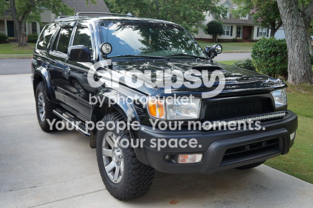

Mudflaps up front and slider, specifically shrockworks with the treadplates. They're flat and with the treadplates it keeps stuff off the paint. Good daily protection and also very protective off road.

Haha, pricey yes, but they're a great product. The ones with the treadplates aren't angled at all. They stick straight out, only the non treadplate ones are angled. As far as I know I'm the only 3rd gen with the treadplates.

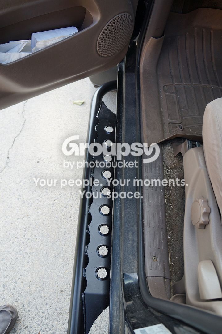

You can see how much they stick out in the pictures with the doors open from the top. They're about even with the sport flares on mine. Like I said above they make good steps for people that need them too.

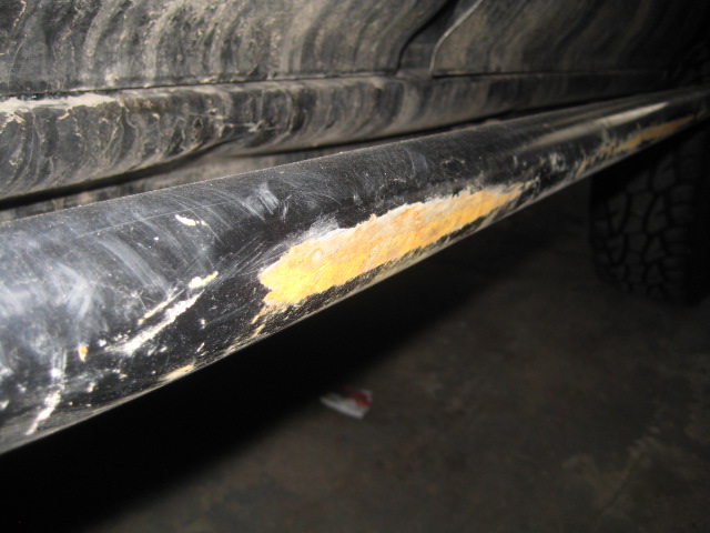

the 67" ones fit just perfect. They also hold up pretty good--I was in a rollover and my passenger side slider took the entire weight of the vehicle at speed and was basically just scraped up. Additional gusseting would have prevented the rocker panel damage you see in the second picture. I just welded the slider legs straight onto the frame rail. No fishplates, no gussets. That's a 45mph impact, BTW.
