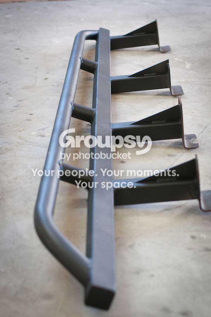

The trail gear sliders just come with the mounting legs (3 per side) and the slider body. You can weld them straight onto the frame--the frame is strong enough to handle it. However best practice would be to weld a piece of plate (3/16 or the like) to the frame and then weld the slider leg onto that. Then since the DOM isn't the thickest available, as pointed out above, add gussets between the plate and the legs to minimize deflection.
So in the below photo, the slider legs meet up to a plate, which would then be welded to the truck frame. Then there is a triangular gusset on top to improve strength and rigidity.
_DSC2711.jpg~original
