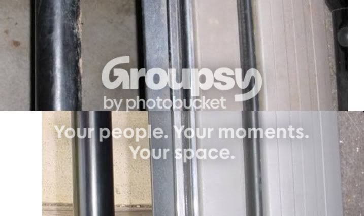

I made this comparison pic a while back of my sliders versus the fit of Shrockworks sliders. There is a little error due to camera angles but it's pretty close. Shrockworks certainly appear to be useful as a step, but if you're really going to be using sliders a lot for that purpose and standing on them for more than a few seconds, you might want to get something that sticks out a little farther.
slidersbirdseye.jpg~original
5" to the bar center and 3" tubes... and that's about my minimum...

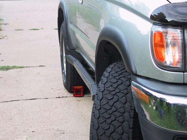

Heres what I did, got the Stubbs slidders, then I went to a surplus store and got some steel to plate the top. Works awesome as a step, and also protects the rockers from rocks and dirt..
