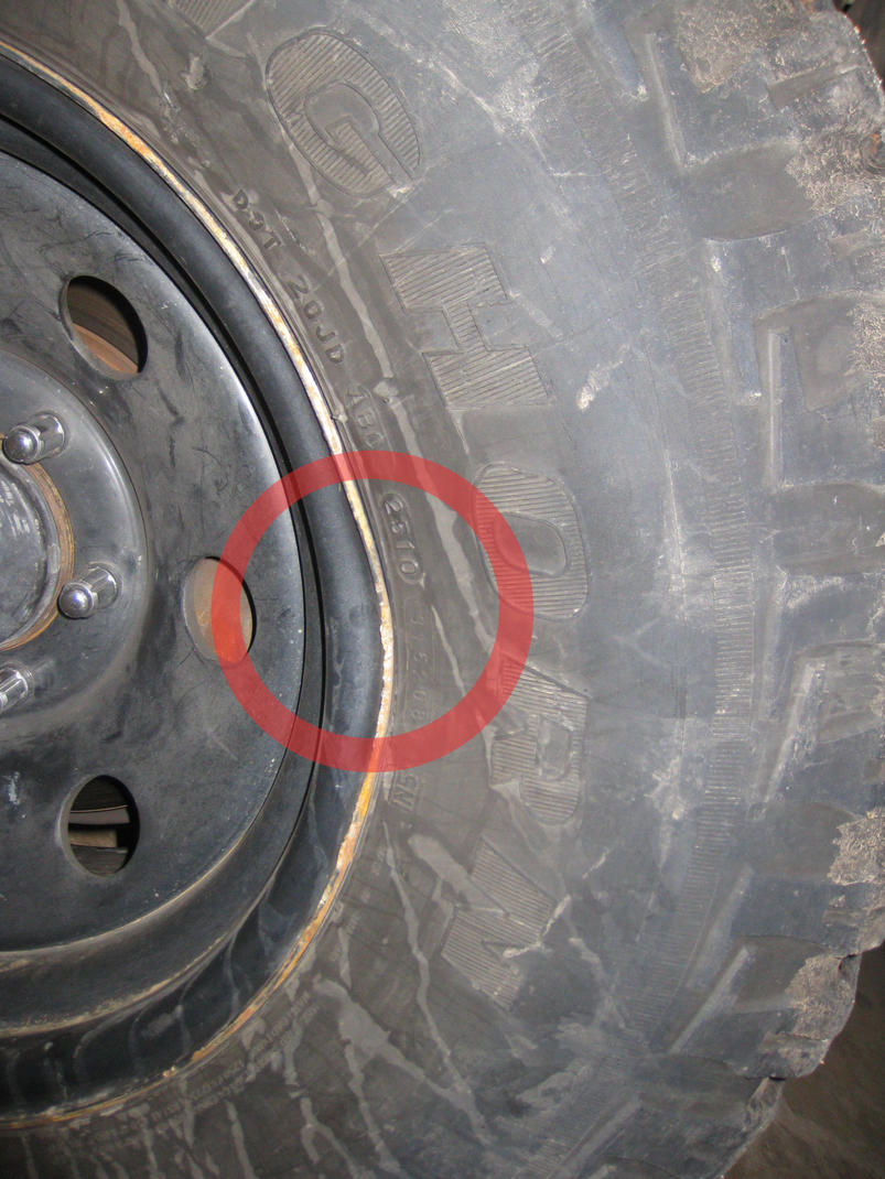

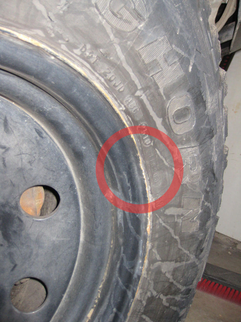

I was up at Eagle Rock about 2weeks ago with two SFA 2nd gens and it was a f'ing ice rink up there. Had to turn around, and while going down this hill my rig turned on me and that tire hit a pretty big boulder perpendicular to the rim, thus denting my rim pretty good. I'm guessing that may have bent my axle shaft the tiniest bit, making it wobble. I really don't know:bash:
Here is that bent rim. I can't even feel it in the vehicle while driving. I guess I gotta get down to the nitty gritty to figure this one out.lol :beer:
Other than some awkward tire wear, should I be freaked out? Prob try to get to it this coming weekend.

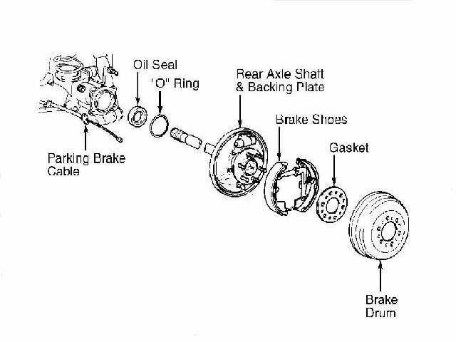

BTW, isnt there suppose to be a ring of bearings in this diagram?
