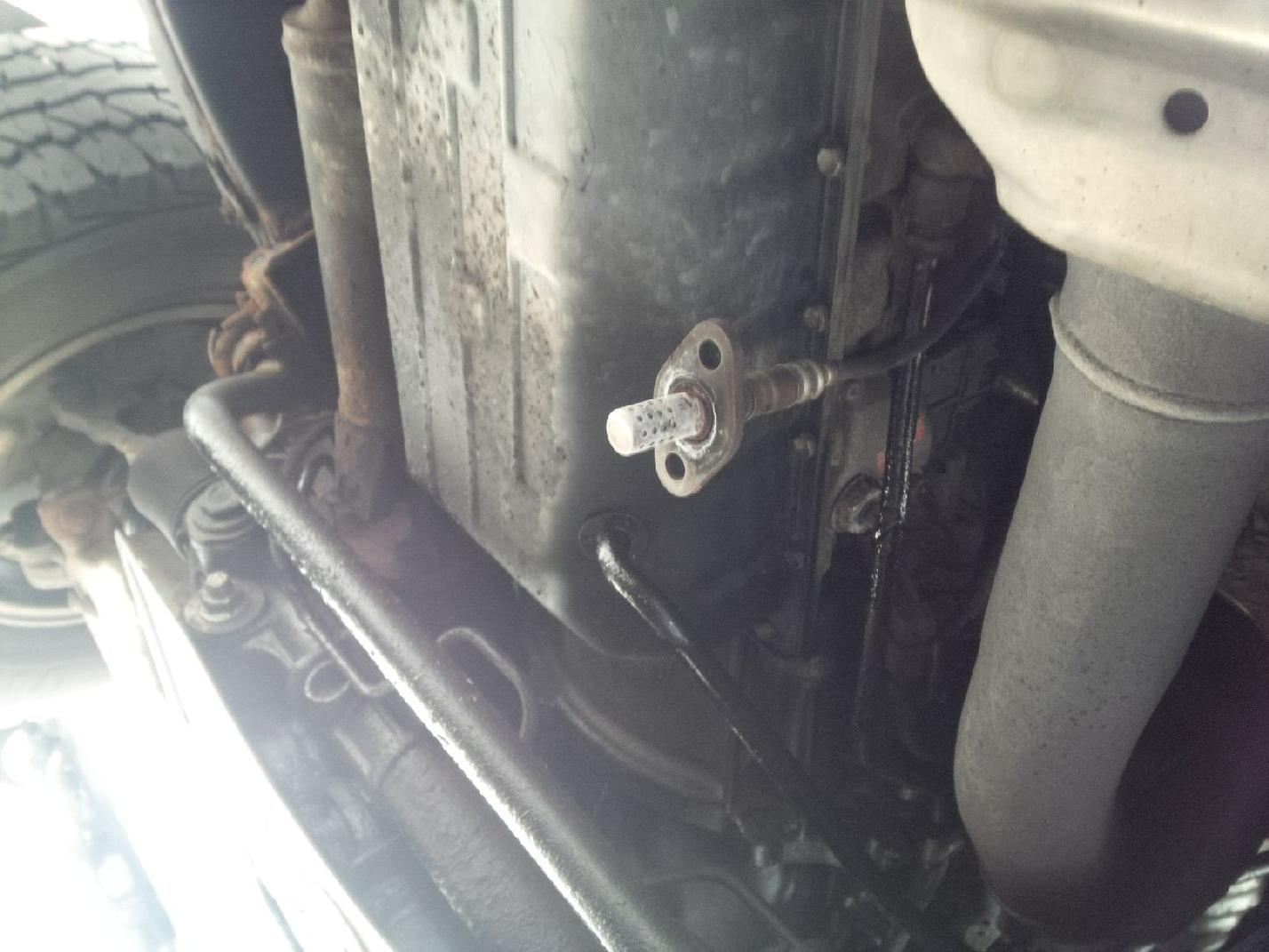

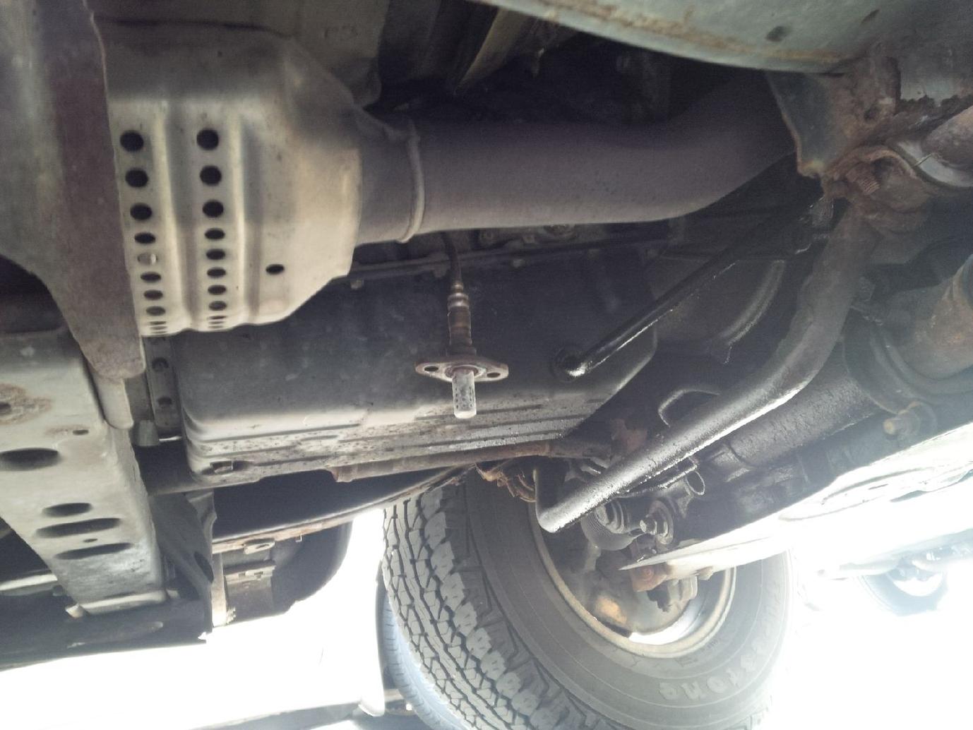

Found the culprit, knocked the O2 sensor right out. I can just bolt this back into place, correct? Anyone know the size bolt I need or if there is anything else I need to know. Sorry for the dumb question...

Unless it is stuck to the bung, you are missing the ceramic gasket that should be there--and it needs to be pressure tight or codes won't stop. It was not held on with bolts, but stainless nuts on studs (M8-1.25) If the studs are gone, I believe you can go to bolts with some drilling and tapping, but I haven't done it. [MENTION=56021]Nelsonmd[/MENTION] has, I believe.
:peep: wha... I heard my name called...
I think those are M6 studs that hold the O2 sensor in (not sure, so just grab a couple size packs from autozone and return the ones you don't use). See what your studs look like. Since you're in Boston they are probably rusted to hell and the nuts are just gone, hence why your sensor fell out (BTW, this same thing happened to my pastor, his nuts were completely gone)[EDIT: just read this again, try to control yourselves fellas... keep it classy]. So you will need to clean off the studs before putting new bolts on there. You can get a new gasket from amazon, or maybe even Vatozone.
Get that thing mounted back up and your codes should go away (may take a little driving for them to go away). Should be an easy fix.
I wouldn't replace the sensor unless you have to, in which case you should reference the URD chart for the PN.

Thanks for the responses guys. I am definitely going to try and just get this one mounted back up instead of buying a new one. It was without-a-doubt caused by rust and I'm not afraid to admit that the undercarriage is pretty rusty but what else do you expect for a 16 year old car with 207k miles that has spent its entire life in the northeast?
I want to do this myself as it seems pointless to take to a garage. Unfortunately I probably wont be able to do it until Saturday morning due to work.
